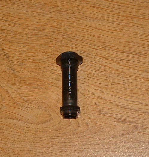

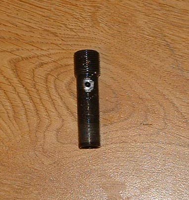

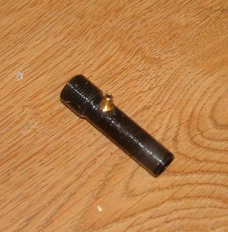

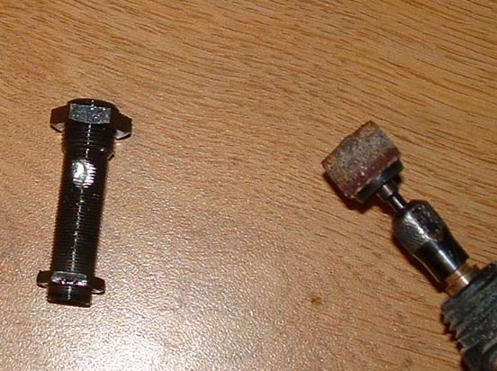

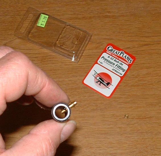

Old 01-16-2006 | 09:25 PM
  #67
MinnFlyer's Avatar
Posts: 28,519
Received 9 Likes on 9 Posts
From: Willmar, MN
Default RE: saito .91 smoke????
Ok, I just did mine just to see if it will work.
So far so good - Can't wait till the spring thaw!

YES! mike b you are the man... exactly what i wanted to see... but what about the pressure fitting? where does that go? you already installed the nipple... sorry if i'm slow

Looks good Mike! When I do mine I wanna put the nipple at the closet end of the manifold to the engine, not the muffler right?
Mark

Erik, What pressure fitting are you talking about? If you are reffering to a system that works off of crankcase pressure, there is a crankcase pressure nipple on all 4-strokes. If you're using a 2-stroke, you'll have to examine your engine (As in - take it apart, or at least remove the back plate) to find the best place to tap it.
Mark, Yes - if you look at the pics above, you'll see that one end of the pipe has a larger thread (Note: this engine is a YS 110 ) the larger side goes to the head, so I tapped it as close as possible to that side in order to: A) get it as close to the hottest part of the exhaust, and B) give it the longest time possible in the heat.

Mike: I was just wondering what the last picture was for that you posted.... you installed the nipple, but then the last pictures little great planes device is for what?
