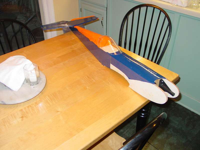

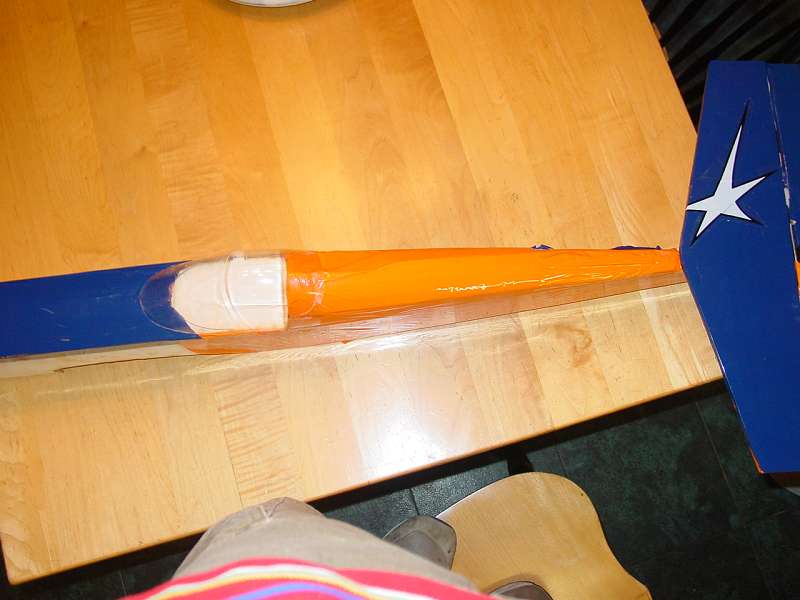

Old 05-12-2005 | 07:53 PM
  #122
Pilot Chad's Avatar
Joined: Jan 2005
Posts: 2,141
From: Madison, AL
Default RE: Four star build
ok, i did some work on the covering of the fuse tonight! Man. Ken did you get my PM?
Heres some pics...
ID:	270638   Click image for larger version
ID:	270639   Click image for larger version
