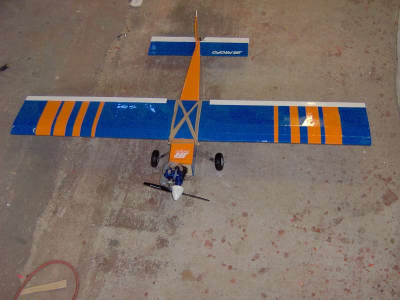

#185
To be honest I am a little concerned with the structural integrity of the whole Airplane...
But looking at this photo...
The engine looks skewed to the right... (Which has obviously been done to clear the exhaust mount)
The Fuse looks to be either leaning to the right, or bent... (This could be from the Camera or Landing gear)
I noticed you had not drawn the Horizontal Thrust lines onto the fire wall and I think your engine is too high as a result...
Apart from the Aero issue associated with this, I think your Carb may be too high in comparison to the fuel tank, which may mean engine/fuel problems...
I am comparing your Airplane to my 60 setting on the work bench right now...
I had to take out about 3/4 of an inch on both sides of the cheeks to clear a ST G-90 into the Airplane... My Carb is sunk below the Cheeks!!!
And although Quirky... I don't think you are onto a winner with the Lego men... At least weight wise… If not because the first hard landing is probably going to send them west…
Not trying to be a downer Dude... But there would be nothing worse than paying for and building the Airplane only to wreck it in the first minute of the first flight...
Matt

the engine was accidently done like that.i am changing it next time i work on the fuse. The cheeks have been cut off on top, so the carb looks very high. Where the needle valve is, i had to cut off alot of cheeks.
The gear makes the plane look messed up, one of the wheels were lose, and i lost the allen wrench to fit the wheel which i have found and fixed.
And as for legomen, Weight shouldn't be a problem with legomen, they aren't heavy at all, this plane will also be exceptionally powerful too..

A pretty common thing is to know the weight of the plane, with everything attached. You can also weigh things like the completed fuselage and wing seperately.
Even though the legomen seem to be light, 3oz's on a plane that weighs 6lbs in allot of weight.
I'll give you an example.
I have a Carl Golberg Sukhoi that I want to put a lightened Zenoah G26 on. Everyone said it could not be done except for one member. I listened closely to him and followed his recommendations and now I have a plane that is as light as it would be if I used the recommend setup for the manufacturer. It took allot of work and cost a few extra bucks but now I have a plane that will fly 30 minutes on 16oz's of gas. I explainined what I did and how I did it and weighed everything I could and posted it. I now know of several of these planes with the same setup and people are loving it.
Here is the thread
http://www.rcuniverse.com/forum/m_25...tm.htm#2554116
Take notice that I researched, measured, weighed and all to get the info I needed. I did not berate anyone for anything I felt was negative, I took all suggestions, formulated a plan, listed the plans for opinions, chose to use some of those opinions and now I have a great plane. I used foam pilots that are less than one ounce but without them IMAC will deduct points so I have no really choice in the matter
Moral of the story. weight is the enemy of any plane. The lighter the better. Listen to people and you will come out a winner.

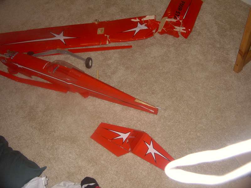

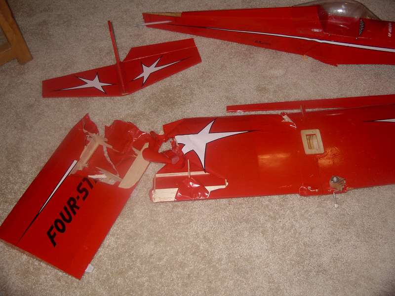

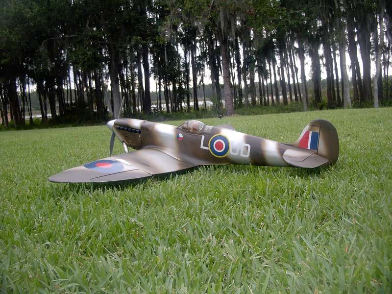

I had a four star 40... im a young kid also (16) i bought a fourstar 40 arf. was excited my first low winger, basically mastered it my first 10 flites. started to get fancy, stablizer and tail flew off during flight when i was doing flat spins a high speed turns and barllel rolls. came down like a rock into the cow pasture fence, fuse is in alright conndition wing is totaled. found out that the epoxy was still wet on the fuse were the stablizer connects to fuse, i did not mix it right, it wasnt even dry. make sure your stablizer is connected to the fuse strong, put on triangle supports on the connections, you wouldnt think how immport it would be to mix the glue right.... don't rush it man, it looks to me you are, i can tell how you just glued on the canopy, with a huge amount of glue that "scared" it. I wanted to get my arf in the air as fast as you want to put you kit together and now i lost 150$ over it... here are picks of what happened. I bought this spitfire before i crashed to four star 40, I don't know what i should do, the crashed scared me off from flying it, should i just go ahead and fly it? or buy a new four star and get my confindence up agin. this spit is so nice i dont want to crash it, should i sell it off? tell me what you think

I wonder how in the world the thing lasted ten flights with tail feathers that weren't even glued on? You should ALWAYS jerk on your tail feathers and control surfaces to make sure they are glued/hinged on good. This can save your plane. I give mine a good tug (I mean good tug--don't break the balsa, but give the joints a good workout!) after building. then, I pull on them again as part of my pre-flight every so often. I really should do it everytime, but I do make sure to do it quite often.

The Spitfire is going to be somewhat twichy on the ground and I cannot tell with the pic but is it retracts???
I would be careful flying it just yet. I's a pretty plane but if you can really flat spin, and do all the other stuff you might be ready. The Spitfire once airborne will not be a problem but retracts are another issue. Constant maintanence is a must especially if you are flying from grass.
In all honesty I would go buddy box with it if at all possible and for that matter, if you still have your previous plane fly it until you get over your nervousness. We all go through it, just get right back in the air ASAP....There is no harm in getting on the buddy box right after a crash if you feel you need too.
The cool thing is you know what happened and are cool enough to admit your mistakes so you are miles ahead of most new pilots
