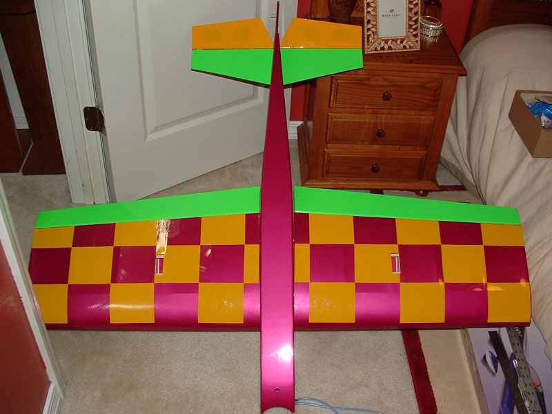

Okay, I got the underside of the plane covered. I only used one piece of covering too.
The photo shows the underside covered, with the wings on for looks. Actually, except for not having landing gear, that's exactly how she'll look from directly underneath.

Old 09-25-2005 | 11:09 AM
  #620
krossk's Avatar
My Feedback: (27)
Joined: Mar 2004
Posts: 1,251
From: Port Washington, WI
Default RE: Another Beginner Build - Sig Somethin' Extra
ORIGINAL: kiswa
uhh - she'll probaby fly better with servos too.[sm=bananahead.gif][sm=bananahead.gif]
Looking good!

Anywho, turns out the wife is rather understanding of my desire to work on my plane after waiting for so long. As you can see in the attached photo, I have now covered the hatch!
EDIT: See that front corner? That proves I'm not that great at this covering stuff! [:'(]

Old 09-25-2005 | 12:55 PM
  #622
R T W's Avatar
Joined: Aug 2003
Posts: 152
From: Edemonton, AB, CANADA
If that is the only rinkle you are a ringer .

Old 09-25-2005 | 03:38 PM
  #624
Joined: May 2005
Posts: 499
From: Petaluma, CA
Very nice, kiswa. The wrinkle in the hatch is a common one--I still do it once in awhile. You need to completely seal the surface before working on the edges, but sometimes I lack the patience. In any case, we're all dyin' here to see that thing in the air.
Old 09-25-2005 | 04:41 PM
