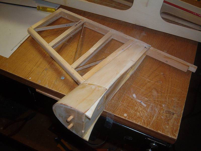

Here is the plug-in tail for MW Extra 300XS.

Now thats a nice tail modification. That will make it really easy to transport. Just curious, what are the two blind nuts at the back of the fuse for?

These are for the two screws that hold the rudder. I already order the OHIO 120 tailwhell p/n OHI120. I will install a piece of hardwoord between the stringers, I will do it once I get the new tail gear.
That was my last modification, the plane will be ready for cover soon.

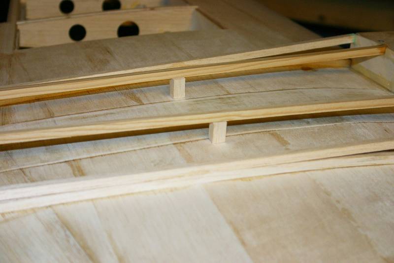

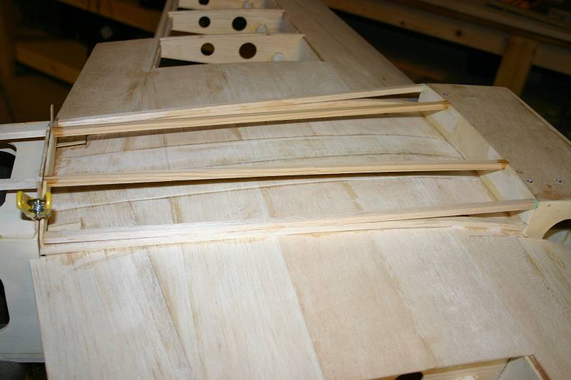

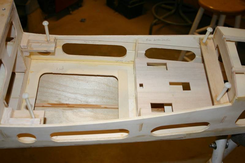

Didn't get much time to build this weekend but I did get a little, Here's a few updates.
1. Belly pan wing bottom balsa stringers
2. top balsa stringers.
3. center spruce stringers
4. center stringer support blocks
5. balsa sheeting hole covers

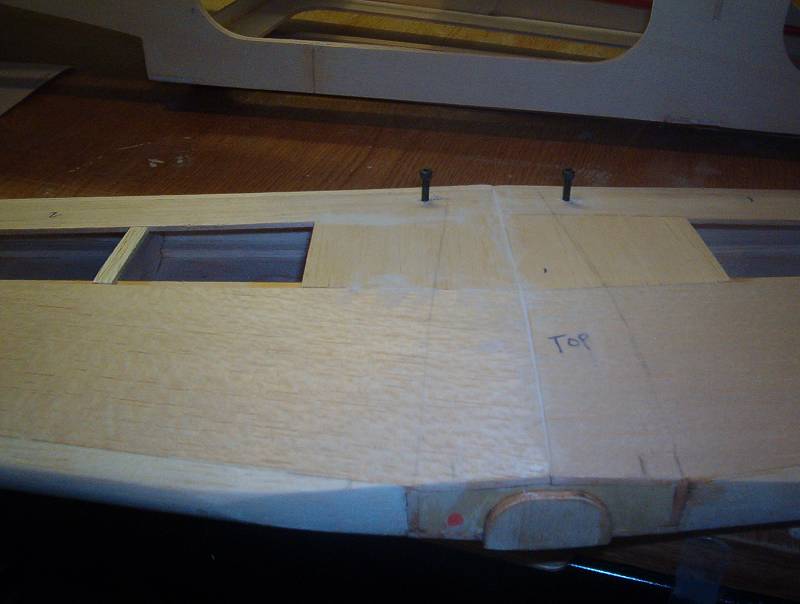

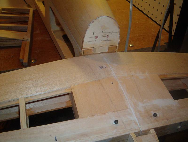

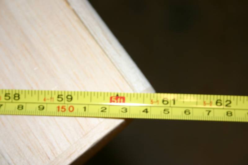

Ok, let me back up a little. Before building the belly pan, and actually drilling the wing mount holes in the fuse I measured from the center of the fuse at the back to the tip of the wing on each side. Actually measured several different places but the tips were primary measuring point. Went back and forth measuring and adjusting until the tip measurements were the same from the fuse tail reference.
I then clamped the wing in place and drilled through the mount holes into the wing hold down block in the fuse. Removed the wing, and tapped the hold down blocks with 1/4-20 tap and hardened the threads with CA. Goofed a little bit here and threaded a 1/4-20 nylon bolt in place a little to early. [sm=eek.gif] You bet, had to cut it flush and re-drill the one hole. I used a little smaller drill bit than the 1/4-20 bolt so I would not get into the wood and then just re-tapped. Worked out easier than I thought it would.

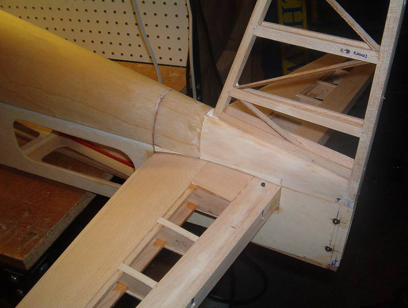

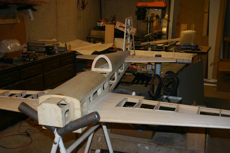

I had to play around a little bit at this point and set the fin and stab in place at the back of the fuse just to see what it looked like.

I almost had a duck earlier today when I leveled the fuselage in a stand on the floor to check wing incidence and that the wing was mounted laterally level in the fuse. Do this by measuring from the same reference point on the wing tip on each side(with the fuse level on the thrust line) to the floor in my case. Wow, almost 3/8!QUOT! off. I scratched my head trying to figure out what was wrong for at least an hour, then I realized it was the floor that was off. Set the whole thing up again on the pool table just to be sure and it was dead on. However, I did get a wing incidence reading of 0 deg.at the base. The plans call for +1/2 deg. Guess I will have to either shim or sand the wing saddle and try again.

Digger, although nothing is going on with my friends 300s rebuild, due to work, I did find your post interesting as to drilling and tapping the wing mount block, with CA hardening. That is how it was on this model and I just assumed the original builder didn't have any tee nuts or shoulder nuts. Now I see that is the recomended install?
I installed tee nuts as I didn't feel comfortable with just threaded and hardened wood. Also we eliminated two of the bolts in favor of dowels on the front of the wing. I guess that there is something to be learned everyday.
This is by far one of the most detailed build threads I've seen. Keep up the good work. Joe

Yea, I know it is common but I too also have my reservations about the short threads,(1/4") even with CA hardening. I think I am going to add some depth to the threads before I fly this bird. Maybe some additional stock underneath the bolt plate. Just dosn't seem like enough to hold the wing in place.
Bob

I'm not to worried about the 1/4 inch hold down plates being tapped and hardened, but I am concerned about the plastic bolts .I know they say they wont come loose as easy but they will sheer off doing violent maneuvers much easier than steel bolts will.I have popped the heads on several smaller planes, just was lucky I still had one holding things in place .Watching a wing float down has to be one of the most gut wrenching feelings in the book,even though as a rule it sustains minor damage a person knows what the scud missile that once was your plane is going to be in a matter of seconds .HEADS UP IN COMING !!!!!!!!!!!!!!!!!!!

I would like to just add about the bolt thing. I think plastic bolts will hold up just fine. Let me just suggest why I would use plastic bolts on wings and to hold the landing gears. Simply, If you happen to land hard and you have metal bolts, Your entire landing mount will rip right under you. If you use plastic bolts, Most of the time if you land hard the plastic screws will brake which is easily replaced. This has happened to me many times and the plastic screws saved my plane and landing gear mount and everything else that could have ripped off. Basically same thing with the wings. Something has to give, I rather have the plastic bolts which is easily and cheaply replaced. That’s just my 2cents.

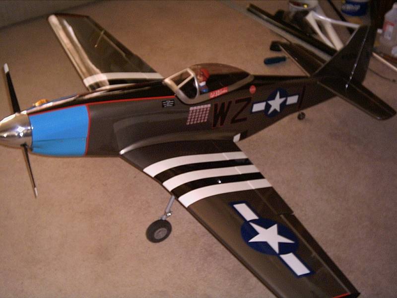

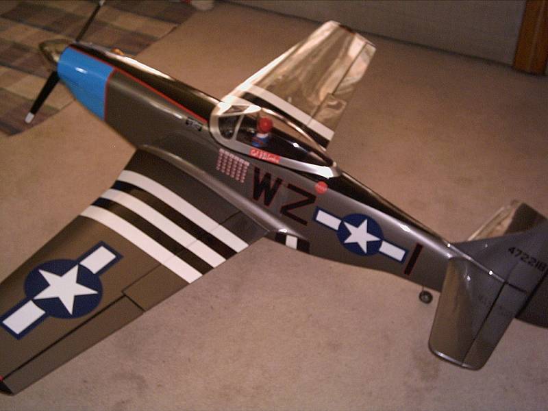

I didnt mean I wasnt gonna build anymore *L* just not the larger planes for myself .I just finished this 51 for a fellow flyer.It needs the muffler which should be here today.

P-51 looks good, was that a kit?

Thanks and yes it was a top flight 60 size P-51,to my amazement it wasnt the best kit that I have ever built.
