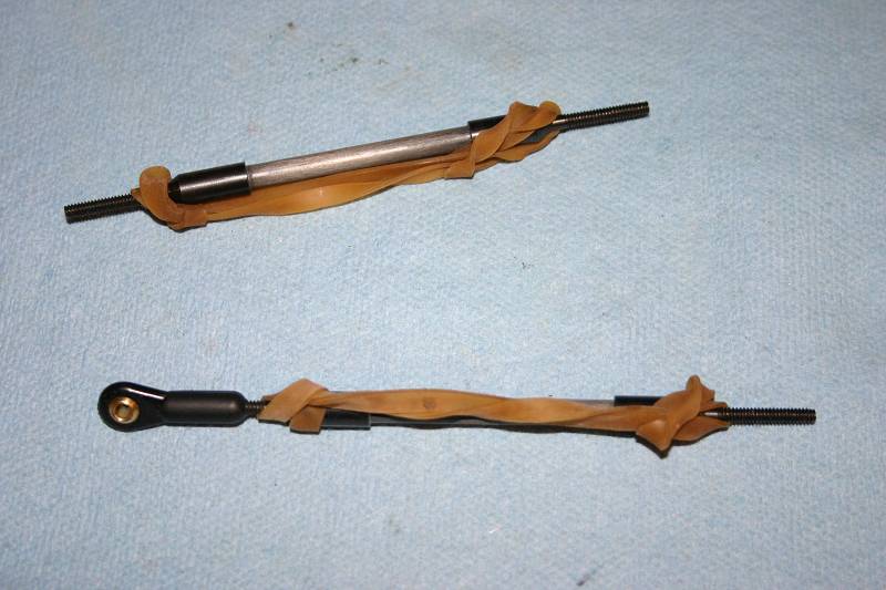

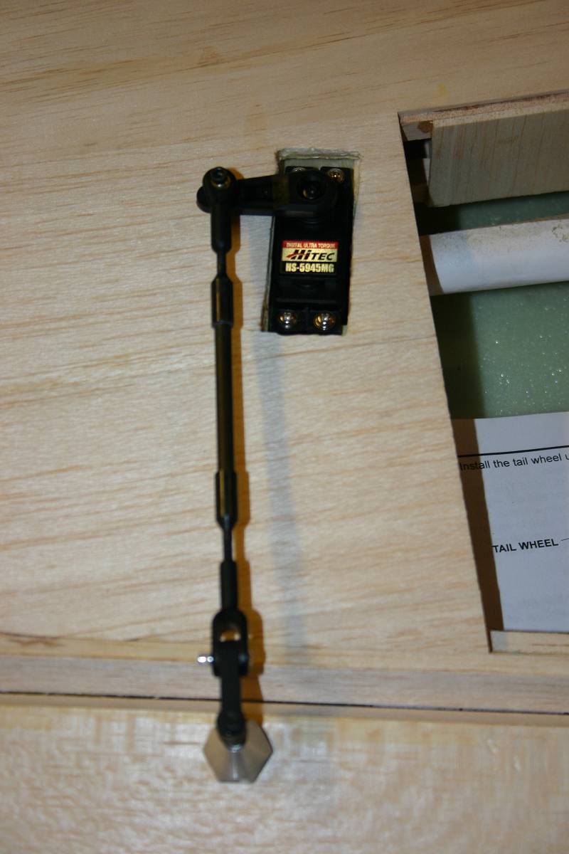

Well, I Worked on the aileron control rods today. Had to rubber band them together while the JB weld dried, they were longer than the small vice opening that I used on the elevator linkage. These linkages are pretty close to the final lengths but some adjustments will most likely be made during final setup. All depends on how well the hinge gluing goes. The last pic shows the finished product installed.

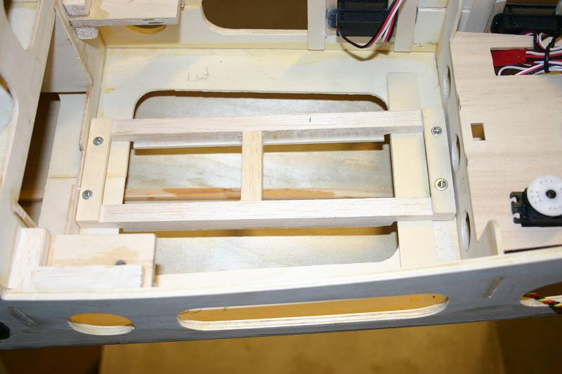

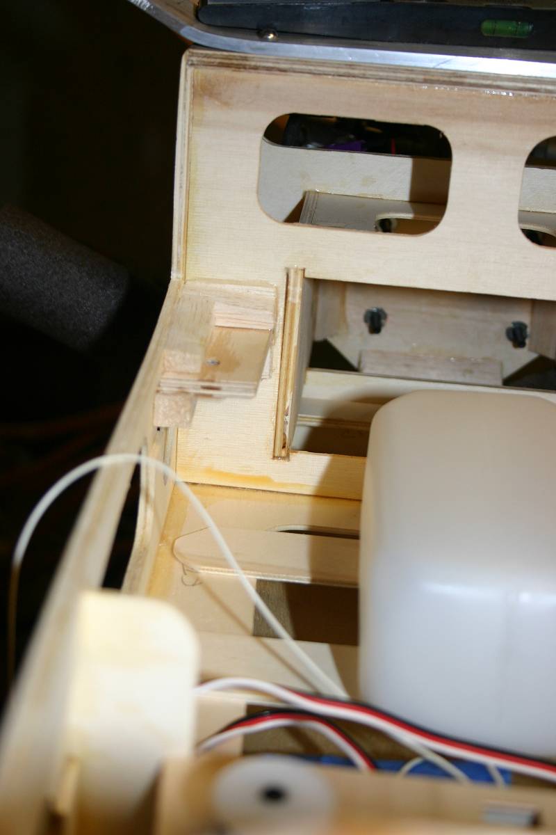

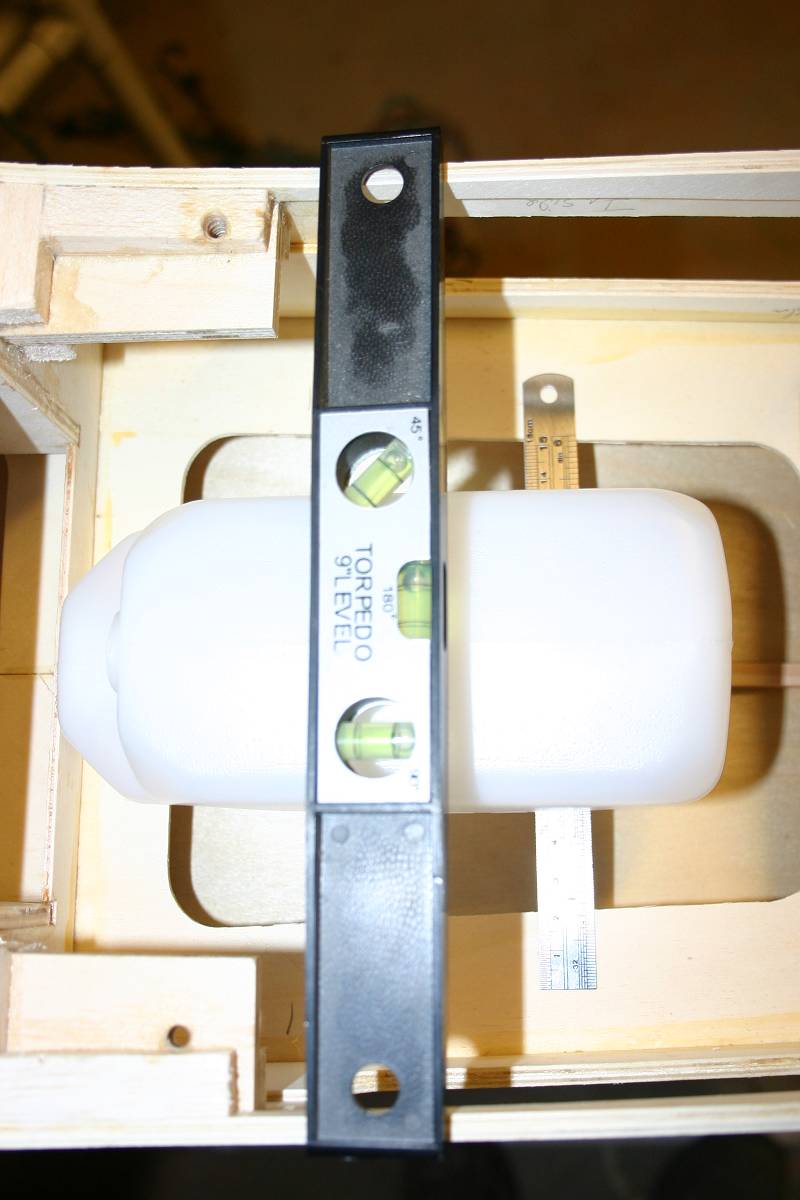

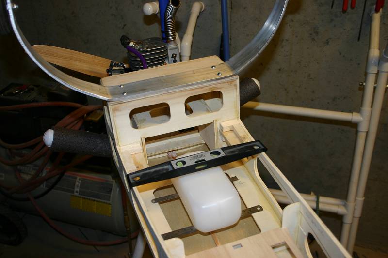

I started working on parts placement today, starting with the fuel tank. The first pic shows the planned location over the CG. The shape of this tank makes me want to turn it around and have the tabs facing the rear. The location in the second is just a little aft of the recommended CG. The left side of the torpedo is the approximate recommended CG. I plan on using good Velcro straps through two pieces of lite ply screwed to the deck in the fuse. about the location of the two rules in the pic.

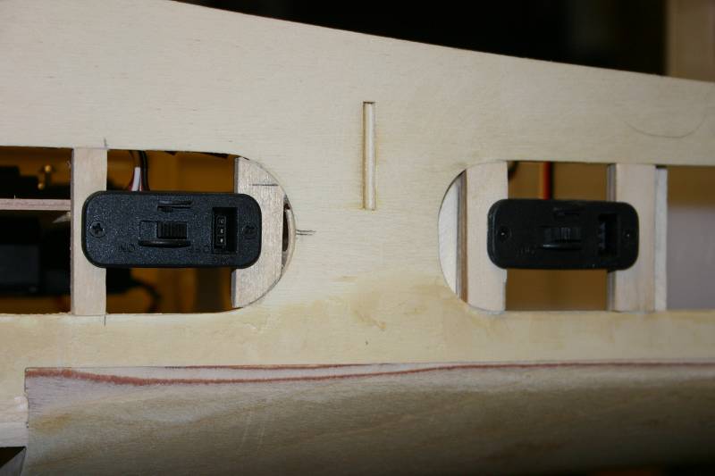

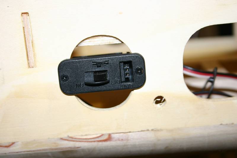

Next is the receiver switches. Two switches in the left side of the fuse toward the rear. I will have to create some better mounts but as you can see it's already half done. The ignition switch is on the right side away from receiver batteries and servo's. The only problem with this switch location is the fact that I have to mount the switch up-side down in order to maintain the on position to the rear, unless there is a better way. Any ideas??

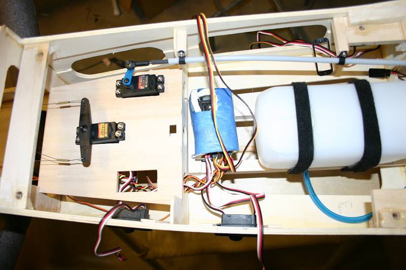

The next item up is the receiver. I am going to try to make a mount under the fuel tank, actually would be in the front deck above the fuel tank when the plane is upright. I will be able to get to the receiver by removing the four screws that will hold the fuel tank brackets in place. The adjustments for the frequency will be exposed in this setup as you can see in the pic.
For the throttle servo I want to try the position in the fuse next to the rudder servo. I know a lot of people put them in the front as close to the throttle arm as possible but I wanted to avoid as much weight up front as I could. I will be using a 4-40 splined nylon nyrod attached to a ball snap for the throttle arm. The second pic shows the straight shot from the servo (bottom) to the firewall, and the throttle arm.

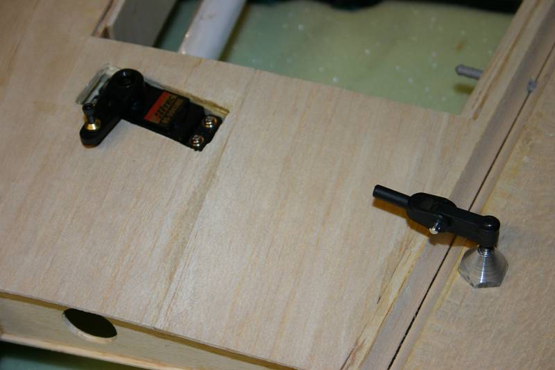

Thanks, the ignition switch is going on the opposite side of the fuse from the receiver switches(2). The picture in one of the last post might not have made that to clear though. I originally placed it in the most forward engine bay but have decided to move it back one bay more into the fuse area above the wing where I can get to it after covering is applied. First pic shows the original location. The second pic shows the location of the two receiver switches mounted. Ignition battery will be mounted on the engine box left side and the ignition itself mounted on the right.

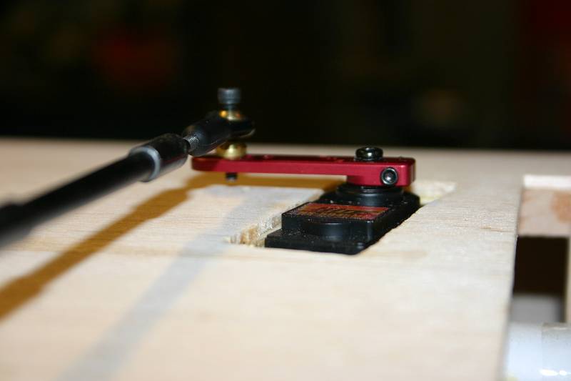

I received the servo arms from SWB and I will have to lift the aileron servo's up in the tray a little to have clearance between the nylock and the wing surface. Third pic shows what I mean, too close for comfort.

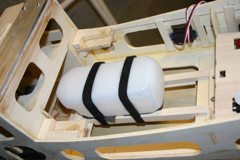

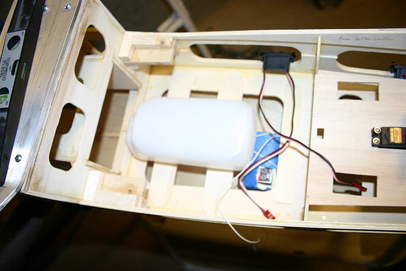

I fashioned a fuel tank bracket that is removable later on if needed. The tank is strapped to the bracket via velcro and will be position adjustable forward and aft. I will be able to set it directly on the CG this way. The velcro was attached to the tank with hot glue.

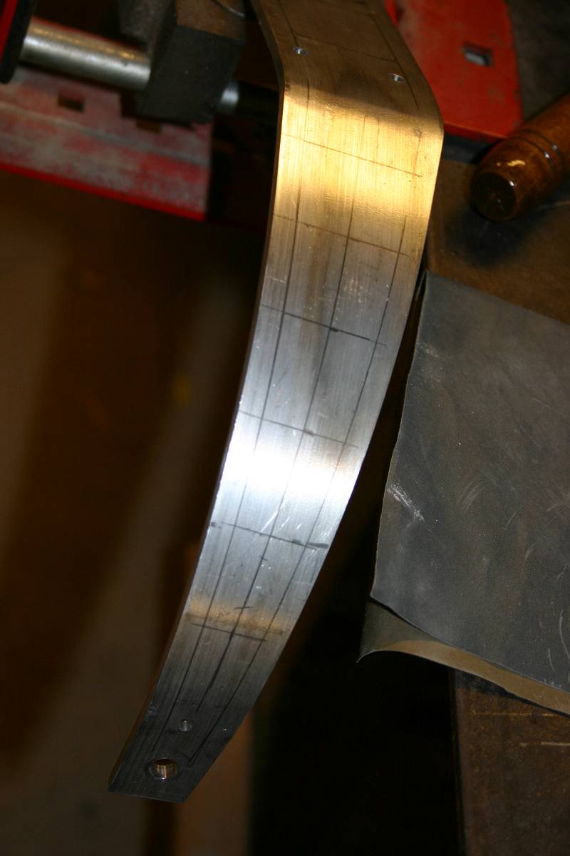

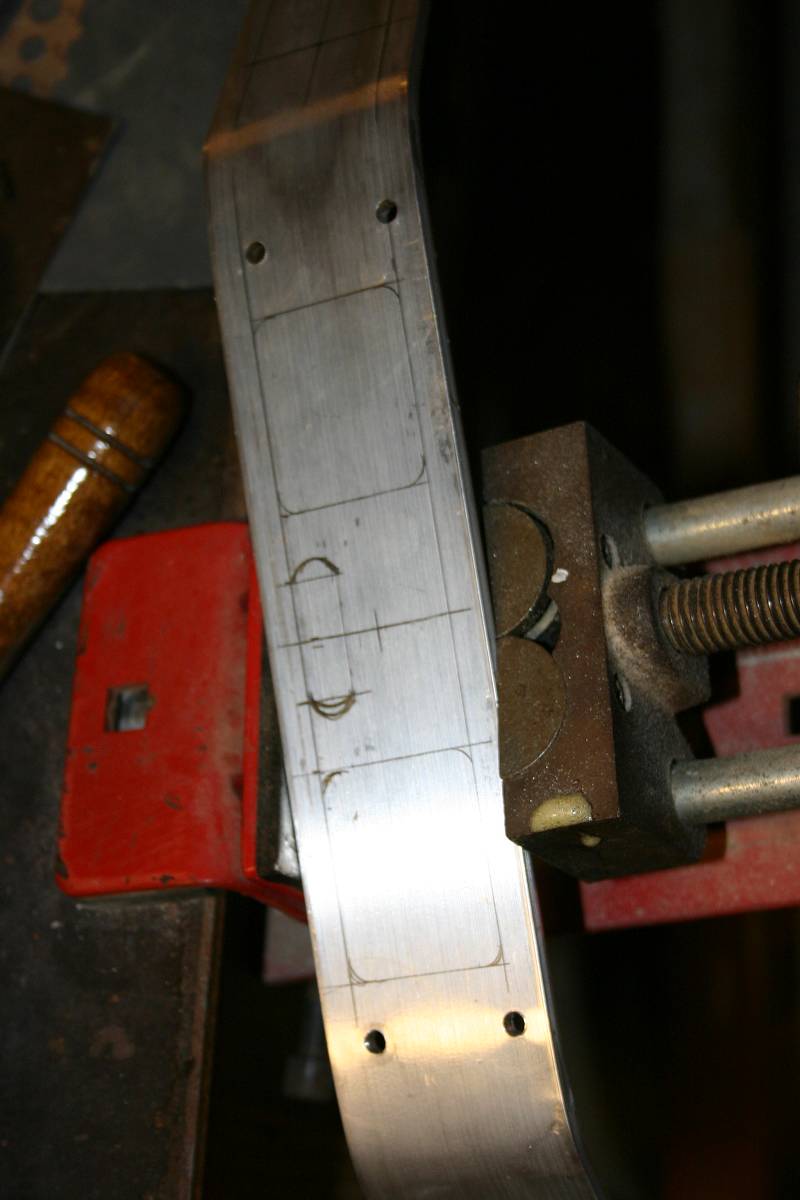

Next I made a steering tiller arm to attatch to the bottom of the rudder. Found a scrap piece of aluminum that fit the bill.

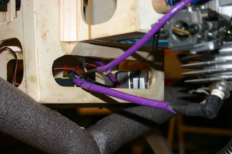

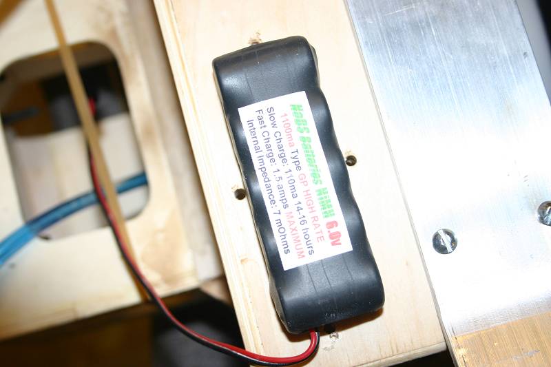

I was going to mount the ignition module and battery on the engine box but found I had room in the lower fuse just below the engine box. This places the parts about 2" further toward the rear. They fit perfectly and I strapped them in. I can move them later if needed. Just drilled holes in the bottom plate for the tie wraps.

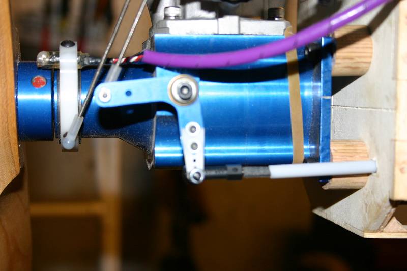

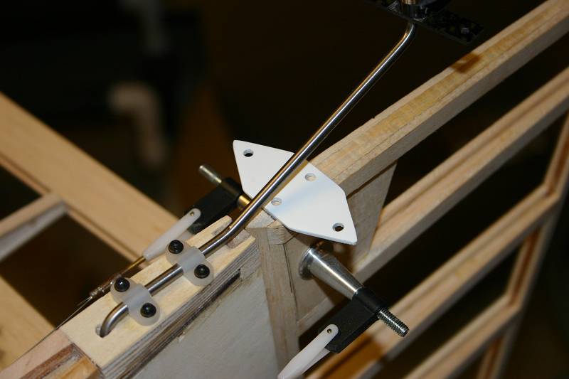

I added the throttle linkage and supported the length with three straps. I will get the other half of this picture next time.

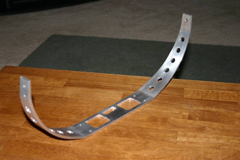

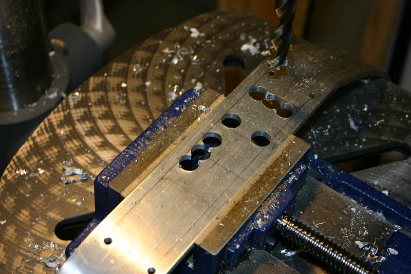

Digger, here is a save. 8.6oz. total weight.
Now this mill job is perfection as it was done on a CNC milling machine. You could give it a go yourself and save but will be a tough job to look this good by hand. Joe

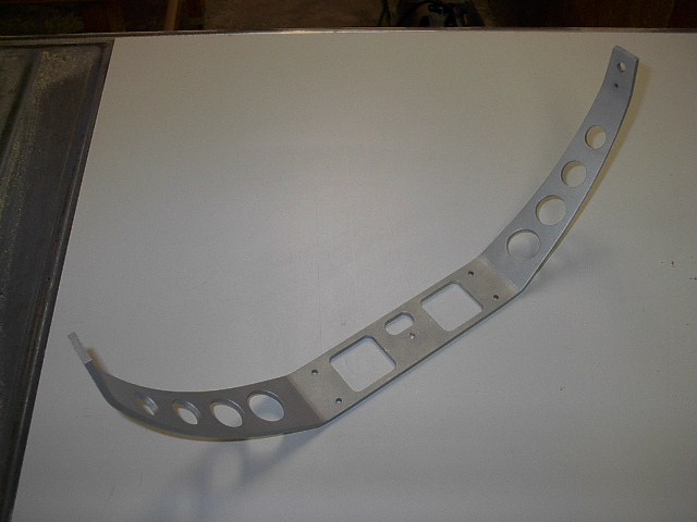

Old 05-15-2006 | 07:37 PM
  #268
Digger44's Avatar
Joined: Dec 2004
Posts: 532
From: Newnan, GA
Default RE: Midwest Extra 300xs Build
Well, I don't have a CNC but a drill Press I do. I think I can get something similar, probably not as pretty but half the weight anyway. Thanks for the suggestion, I will try this tomorrow and if all else fails, Carbon Fiber it is. I will also have to shave some weight off the rest of the fuse.

The CF gear for this model weigh 7 oz. from GraphTec. Loseing weight is expensive. Joe

I finally have the landing gear drilled but still have a little shaping/filing to complete. At this point it is 9oz and some. Lot better than 17 oz. and some. The scale I have does not measure between oz's. Couple of pics of the layout and the process and then the finished gear.

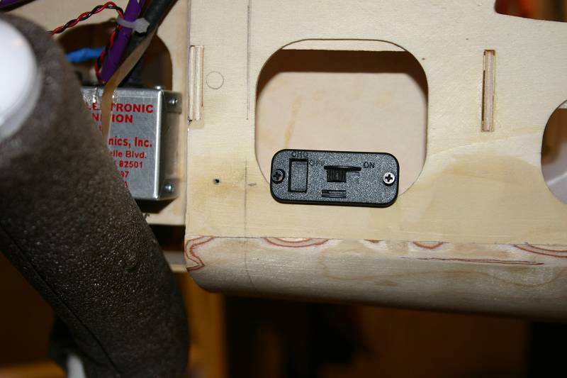

Also have the ignition switch moved back in the fuse where it belongs and drilled the hole to mount the Smart-fly led. Roughly placed the receiver and placed some extensions to the rear servo's. Trying to continue with the dry run on the components before covering. Once everything is installed I will attempt to balance the plane and determine the position of the receiver batteries. Also will attempt to remove more weight from the fuselage frame.

This may be a newb question, but I was looking at your switches and you don't have any wood above/below them. What are you going to stick the covering to?
Graham
Old 06-01-2006 | 06:27 PM
  #275
Digger44's Avatar
Joined: Dec 2004
Posts: 532
From: Newnan, GA
Good eye, I will probably put some light weight balsa sticks in there to secure the covering to. Glad you said something though, I probably wouldn't have seen this until I was actually covering.
