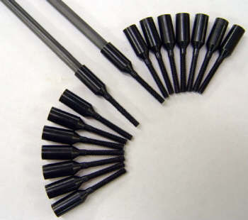

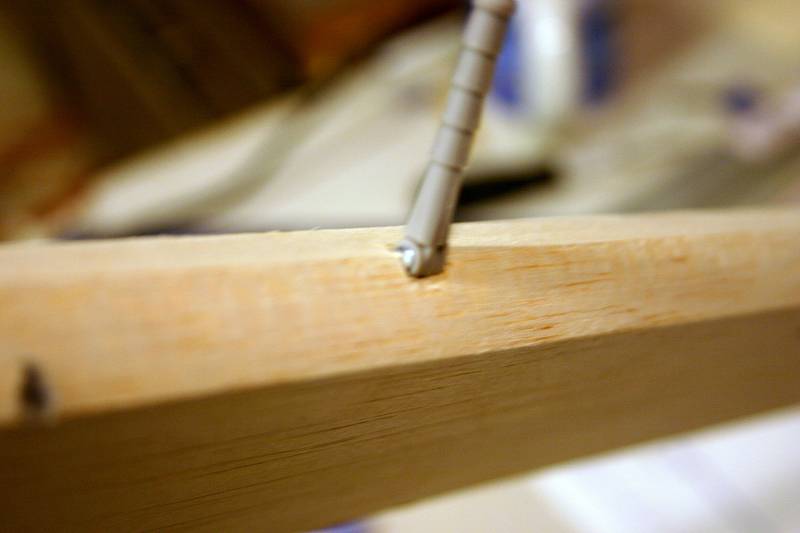

Just wondering, Has anybody here used these rod ends for carbon fiber .188 rods and if so what do you think of them? Found these after clicking one of the links here on RCU.
[link=http://www.abellrc.com/ABELLRCHOME.htm]ABELLRCHOME[/link] These look like a pretty clean setup to me, but again, I am new at this.

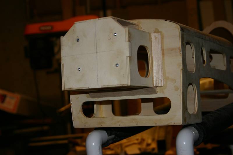

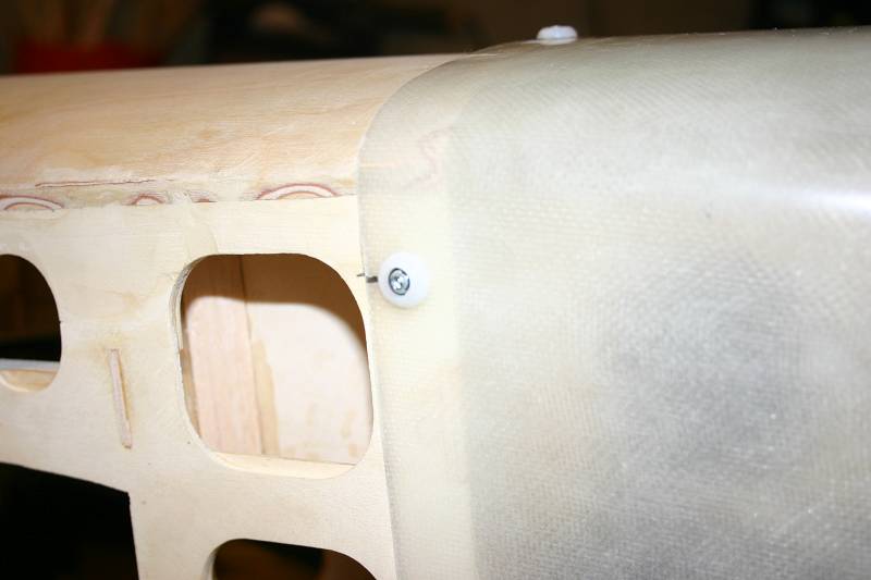

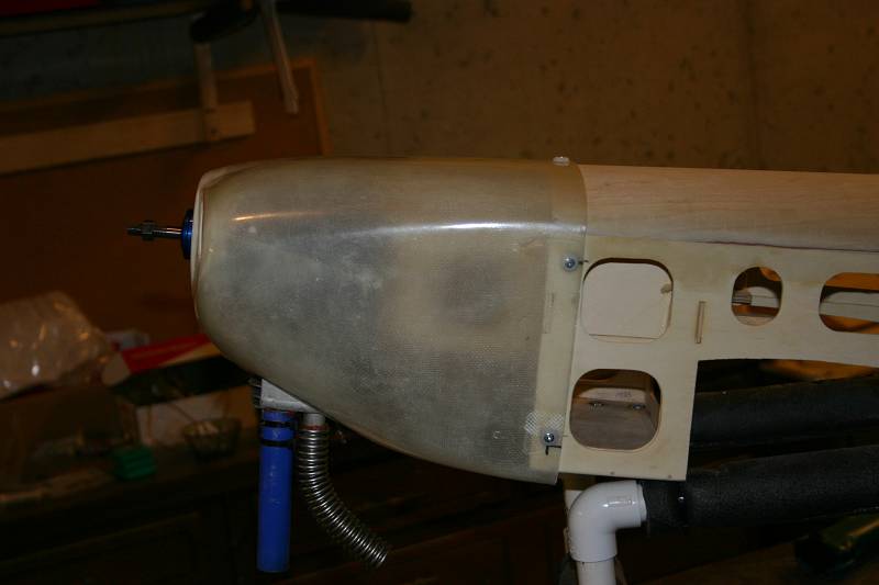

Just a couple of pics of the Cowl mounted. I used the PSP type cowl bushings for the mounting holes.

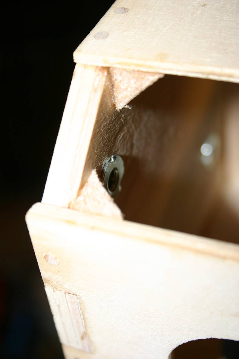

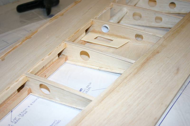

Finally got back to it a little bit. I've been just piddling around and not getting much done. Havn't had the right attitude lately, but the days are starting to get a little longer already so I need to get going. Any way here are a few updates.
I removed the cowl and motor and reinforced the motor box with tri-stock on the outside and on the inside. This might be a little overkill. I also plan on wrapping the edges of the firewall around to about an inch or so with fiberglass.

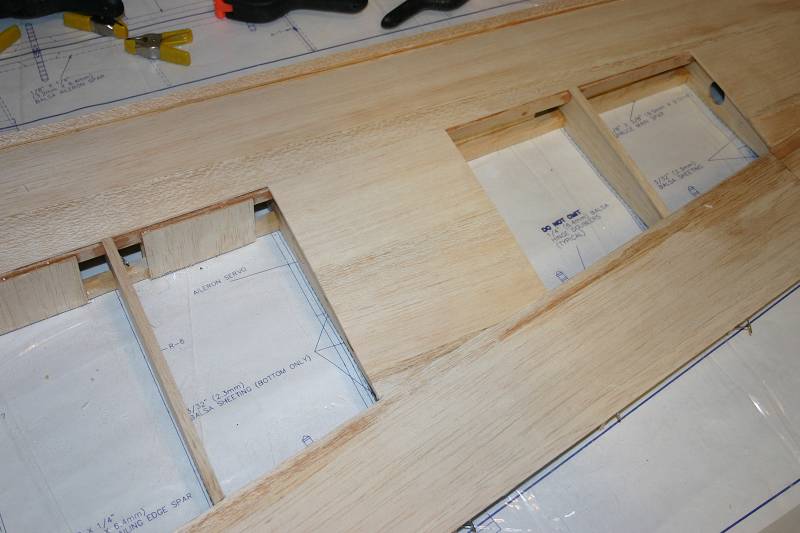

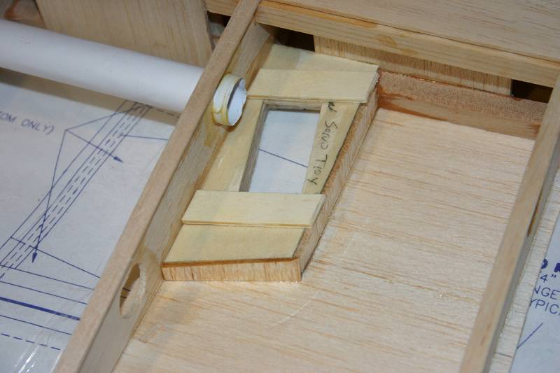

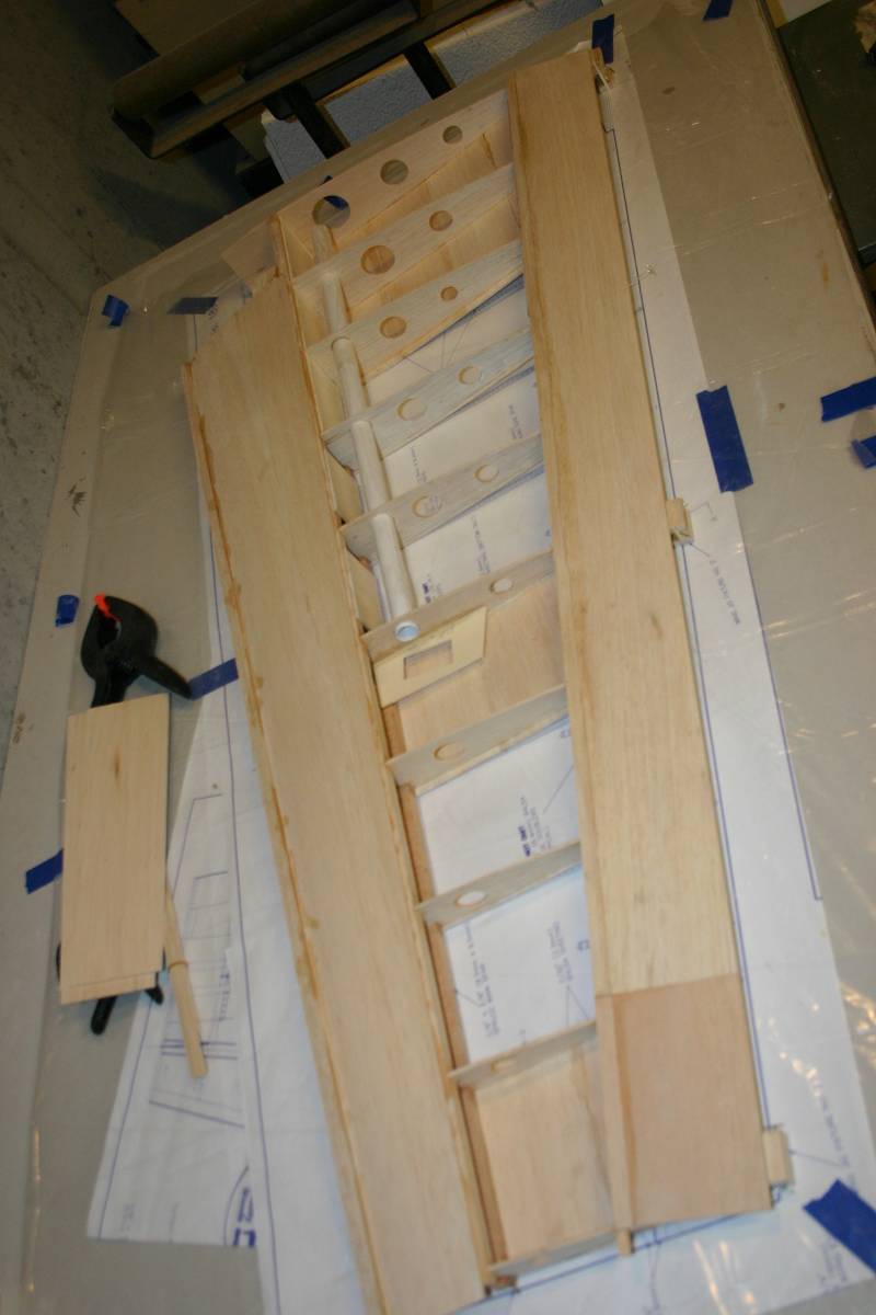

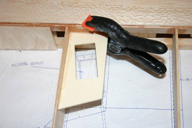

Next, I cut the opening in the bottom of the wing for the servo and installed the servo tray doublers and bracing. Then I knocked out the opening between the top and bottom spars for the dihedral brace.

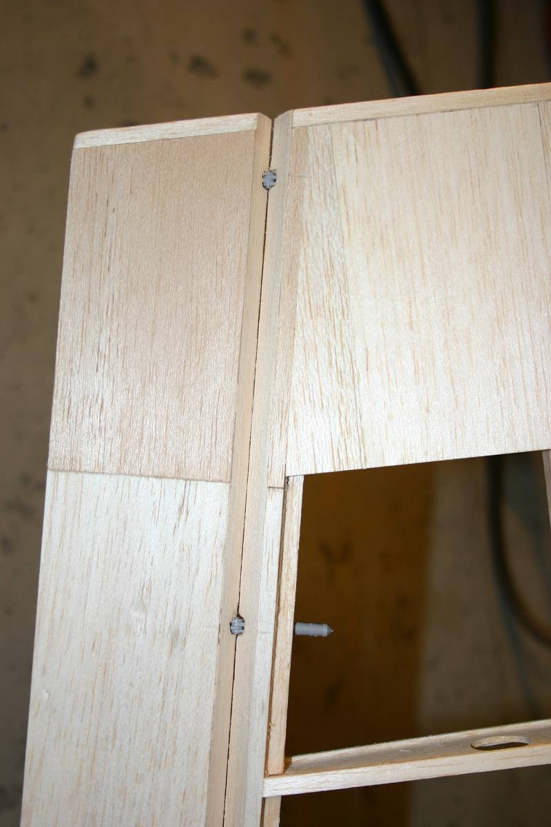

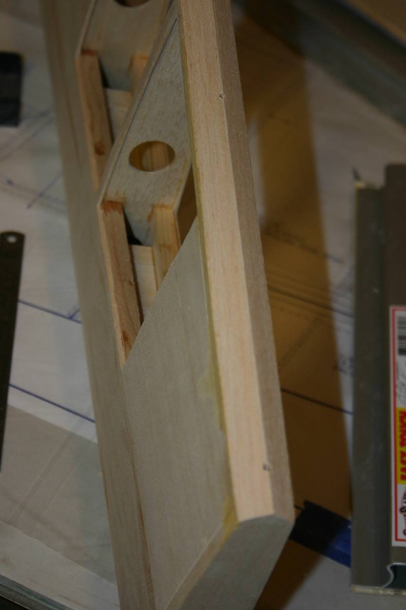

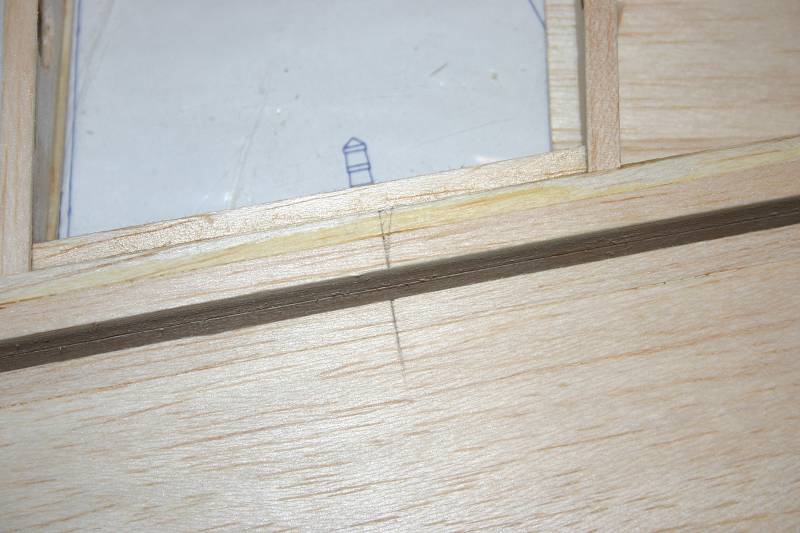

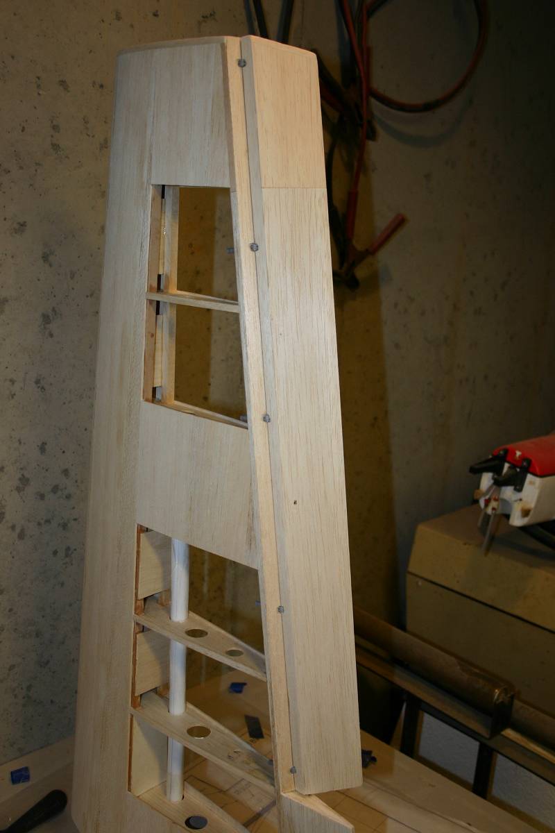

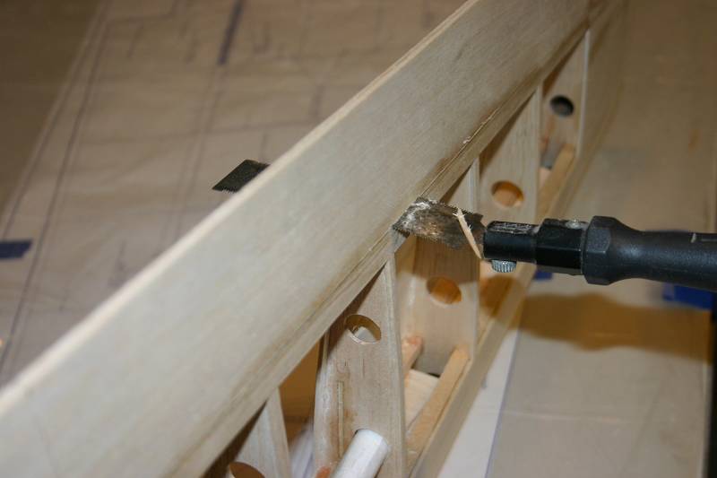

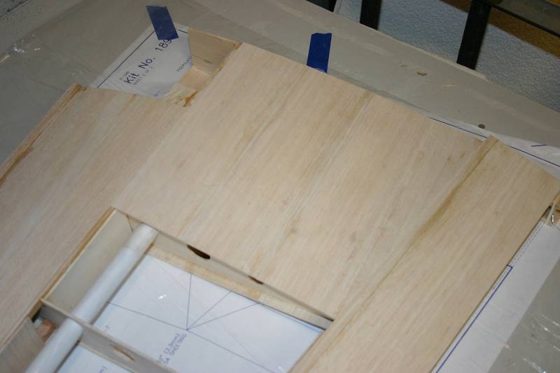

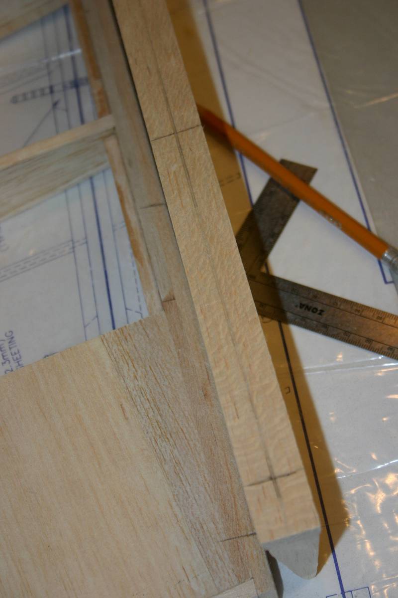

Now it's time to install the hinge points so I drew a center line on the trailing edge of the wing and the leading edge of the aileron. Then, over the plans, marked the hinge point locations on both edges. Drilled 1/16" hole to be used as a pilot for the larger pin size.

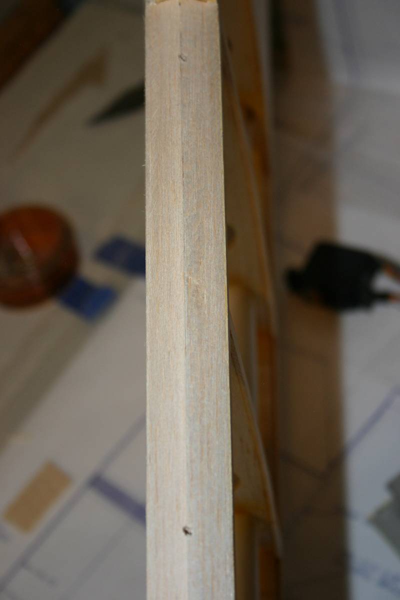

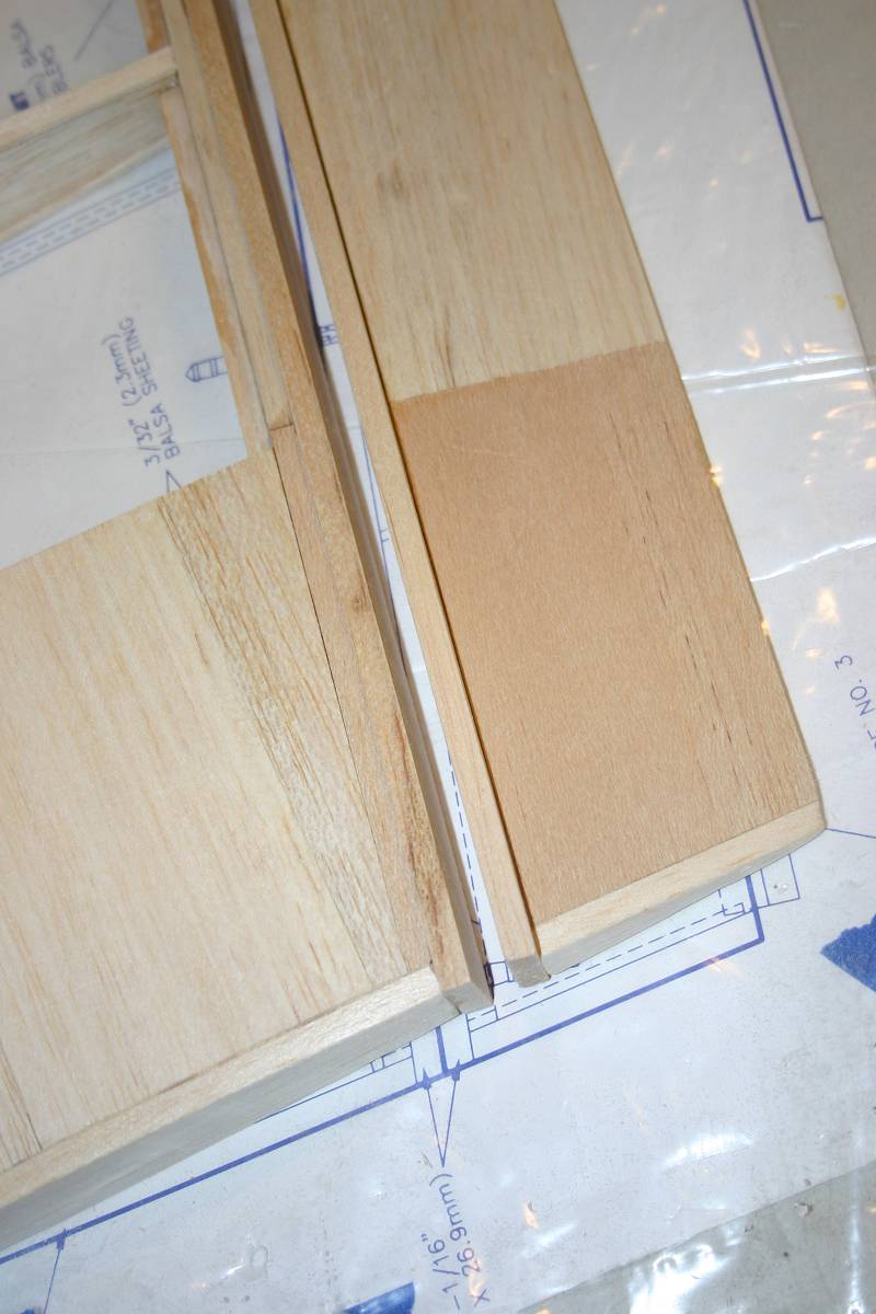

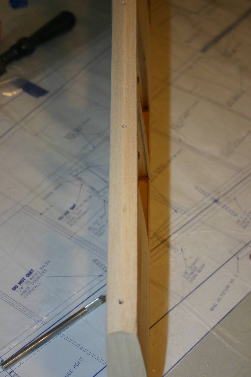

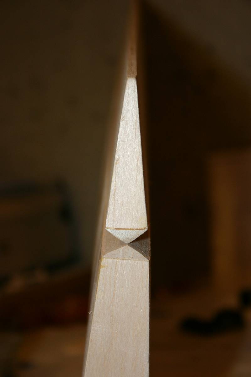

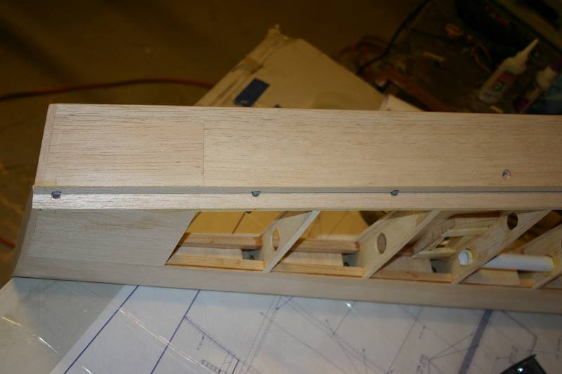

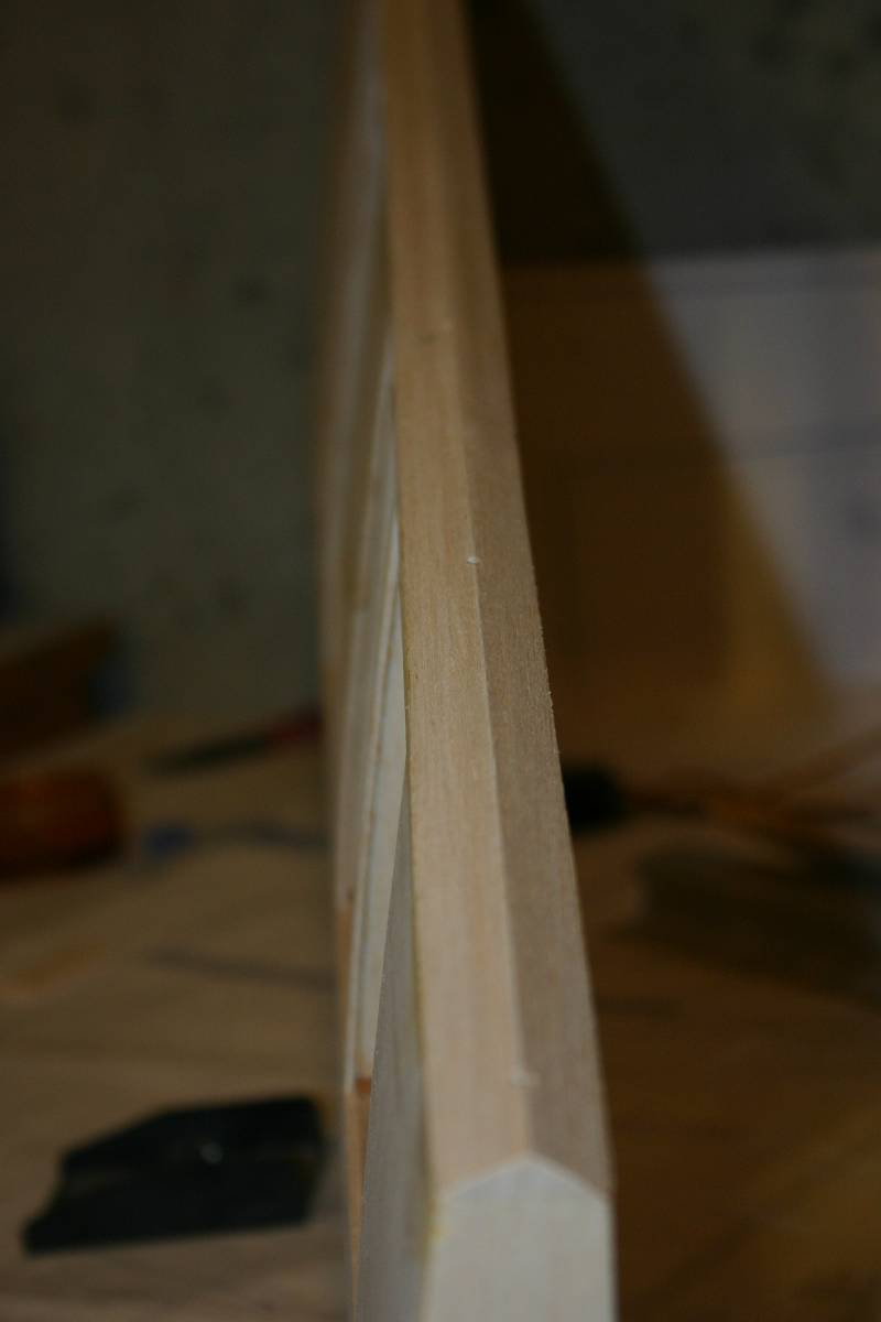

I decide to bevel the trailing edge of the wing along with the aileron. Don't know why this wasn't in the instructions. The aileron bevel is, just not the wing.

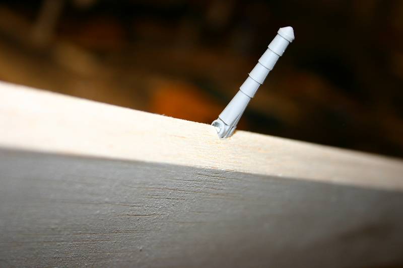

After the bevels were planed and sanded, I drilled the 3/16" (I think) holes for all the hinge pins. Actually I stepped up to this size in steps using a 1/8" first and then the 3/16" on all the holes. You might have noticed that I removed the 6-32 control horn bolt from the aileron. I did this because earlier on I had decided to use 8-32 hardware and 4-40 connectors so installing the 6-32 horn was a mistake. I plan on using carbon fiber .188 rods with the ends shown in post# 153. I ordered these the other day and they look like a pretty clean setup to me. I will also be using the Dubro 4-40 ball joints on the servo end of the rod, and probably RCL horns and connectors at the control surface end of the rod.
Somehow I uploaded the wrong picture??

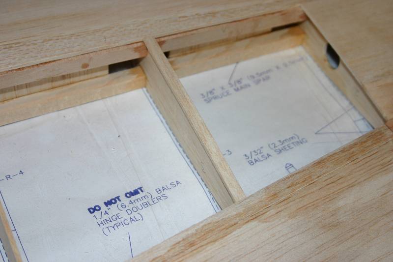

I didn't get any good pictures of the hinge point recess on the aileron and the wing. But while fitting the hinge pins, I cut a recess as wide as the pin and deep enough so that the center pin in the hinge is centered on the peak of the bevel for each surface. This should allow the gap at the hinge line to be at a minimal when permanently installed. Did that confuse you too???[sm=bananahead.gif]

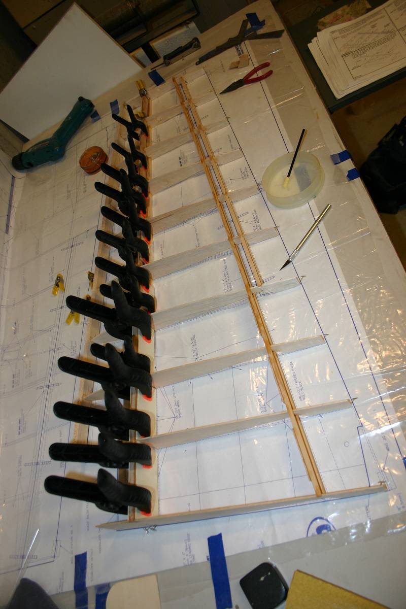

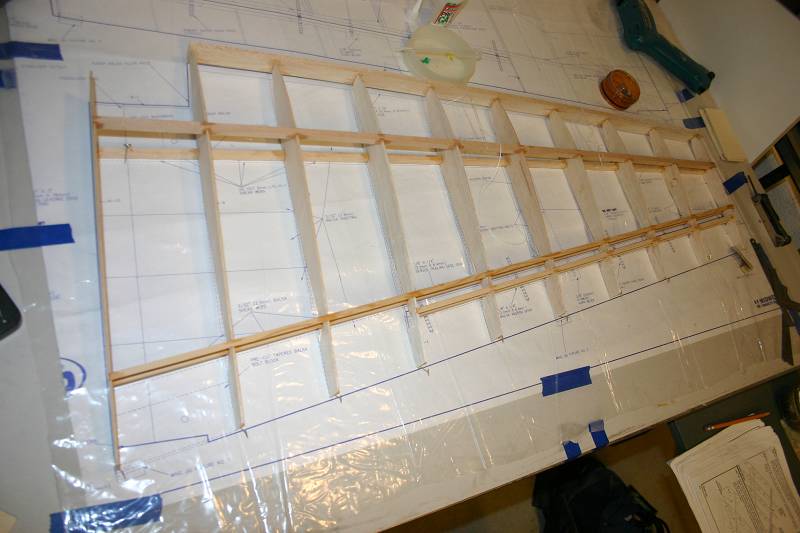

Well, I did get started on the other half of the wing and made a little progress. It's at the point of installing the main sheer webs. I hope to get some more time tomorrow to work in the shop.

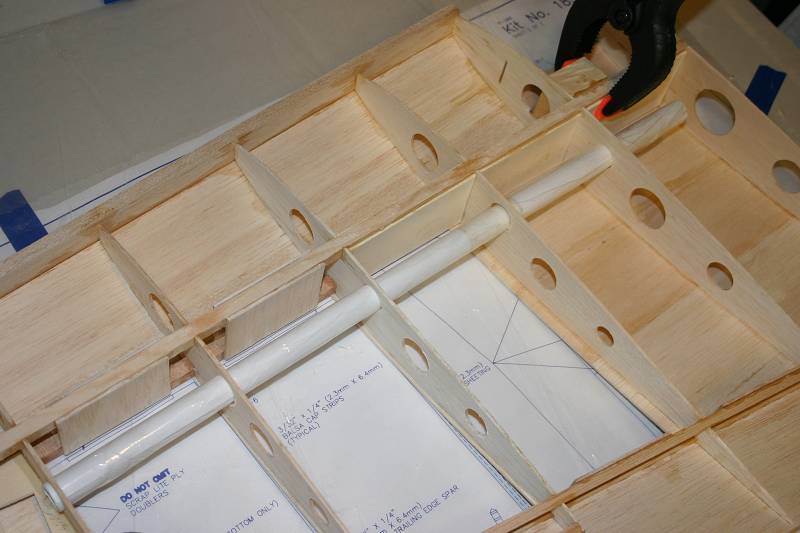

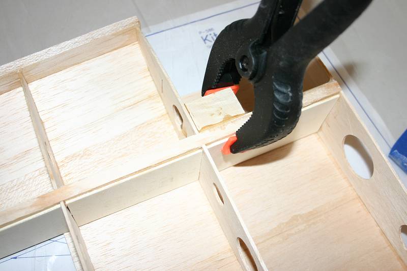

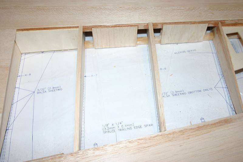

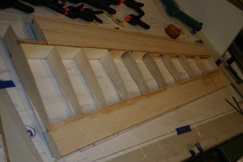

Some pics of the Sheer webs epoxied in place and clamped to dry. Hopefully the sheeting will commence tomorrow.

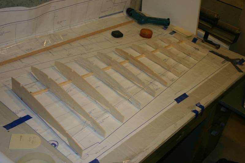

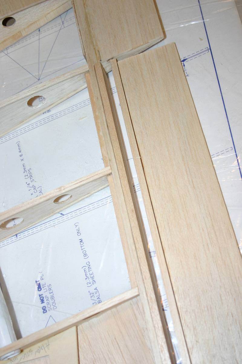

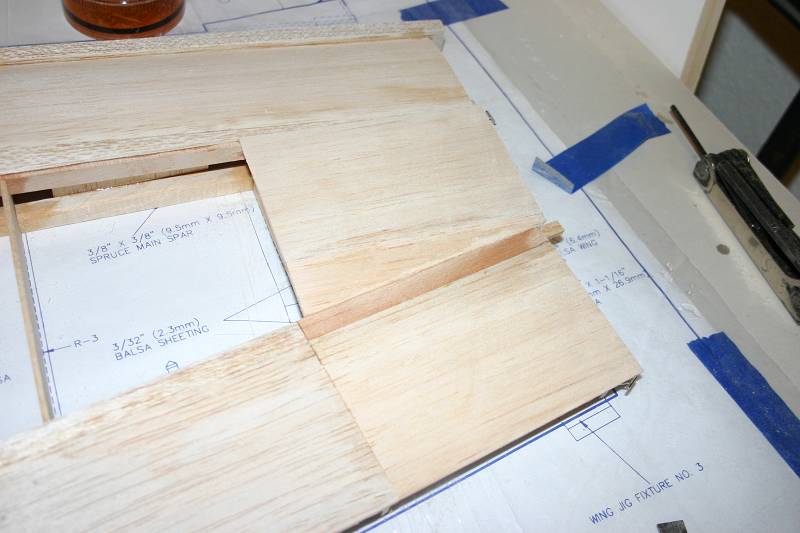

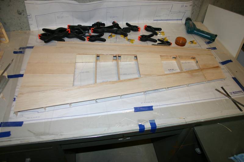

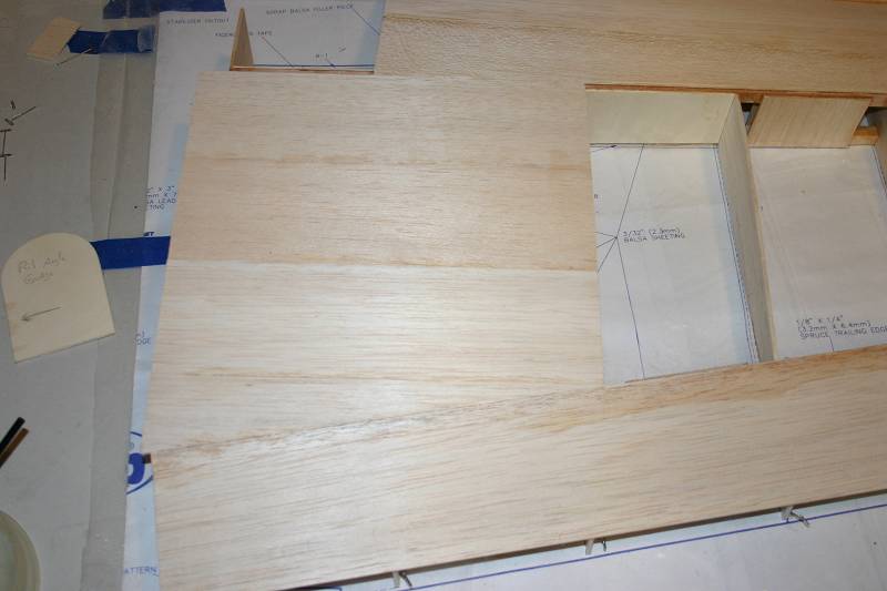

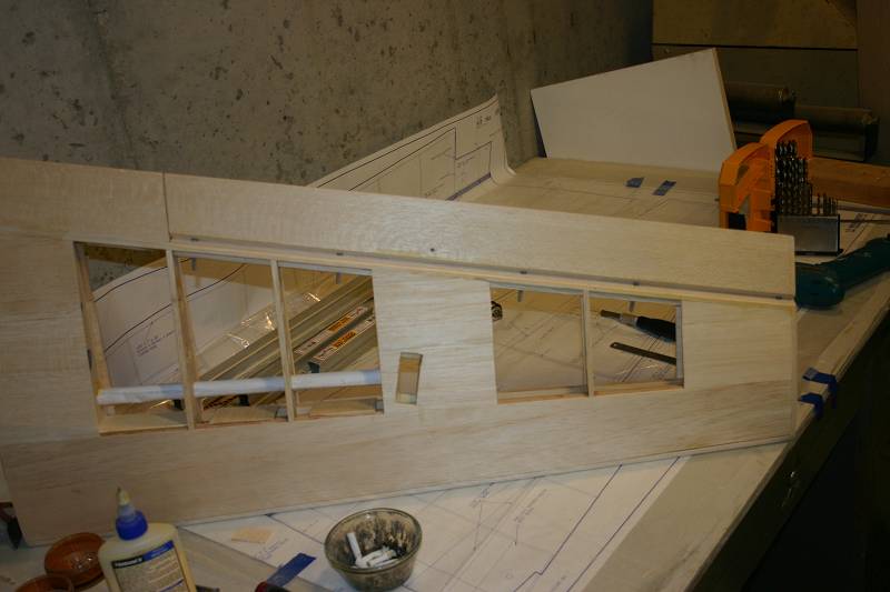

On with the sheeting. Progress pics. Not too much detail here, same as other wing.
1.) Trailing and Leading edge sheeting applied.
2.)Wing base sheeting on.
3.)Tip sheeting.
4.)Servo Tray glued in.
5.)Rib cap strips.
6.)more rib cap strips.
7.)Servo bay bottom sheeting.
8.)Wing root block sheeting.
9.) Bottom sheeting complete.

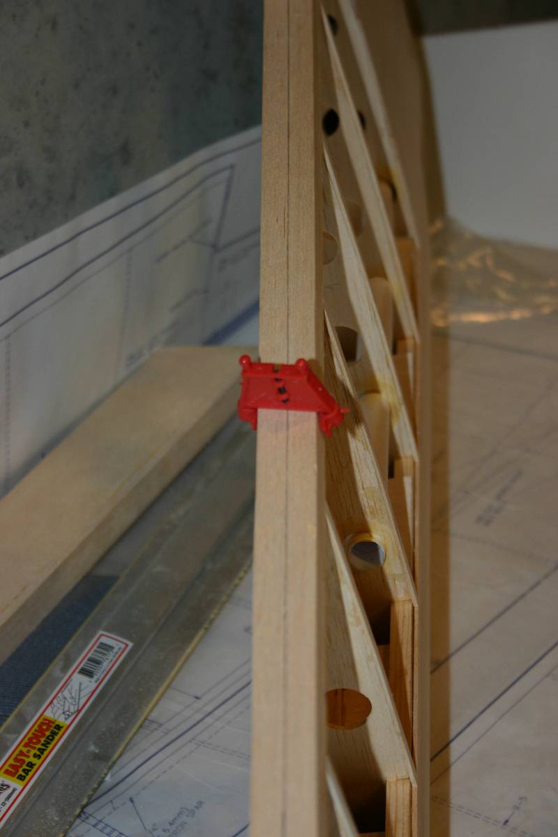

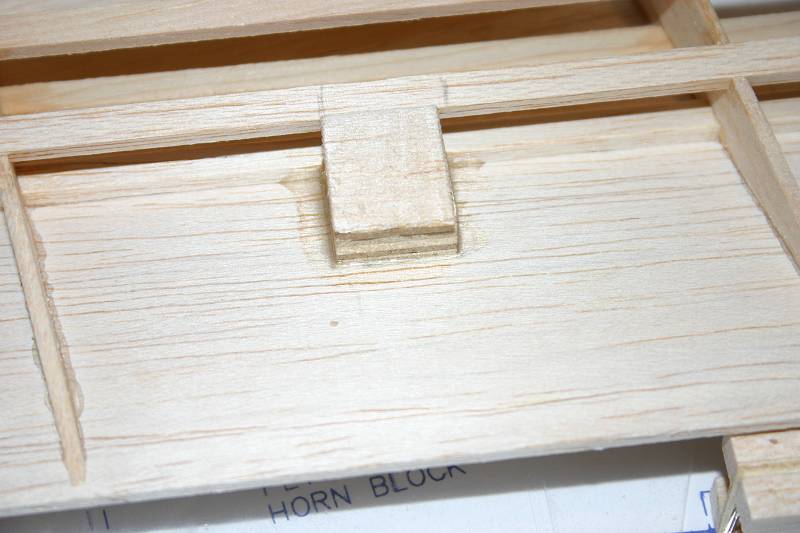

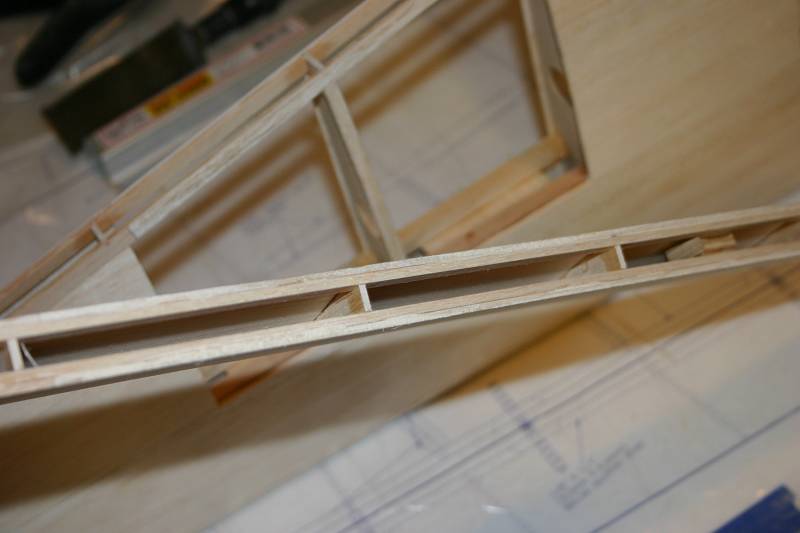

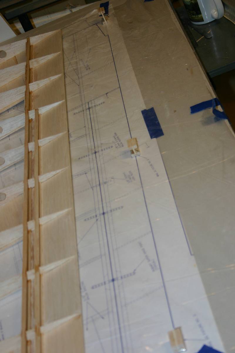

Few more update pictures.
1.)Angle blocks pinned over plan.
2.)Aileron horn block epoxied in place with cap.
3.)Forward wing bolt down block.
4.)Rear wing bolt down block.
5.)Servo wire tube installed.

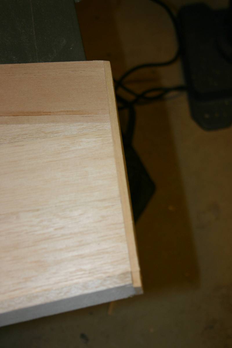

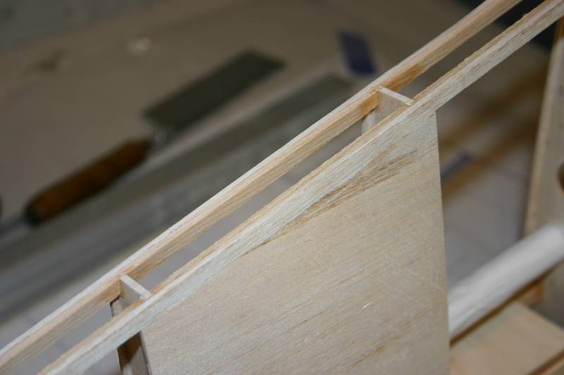

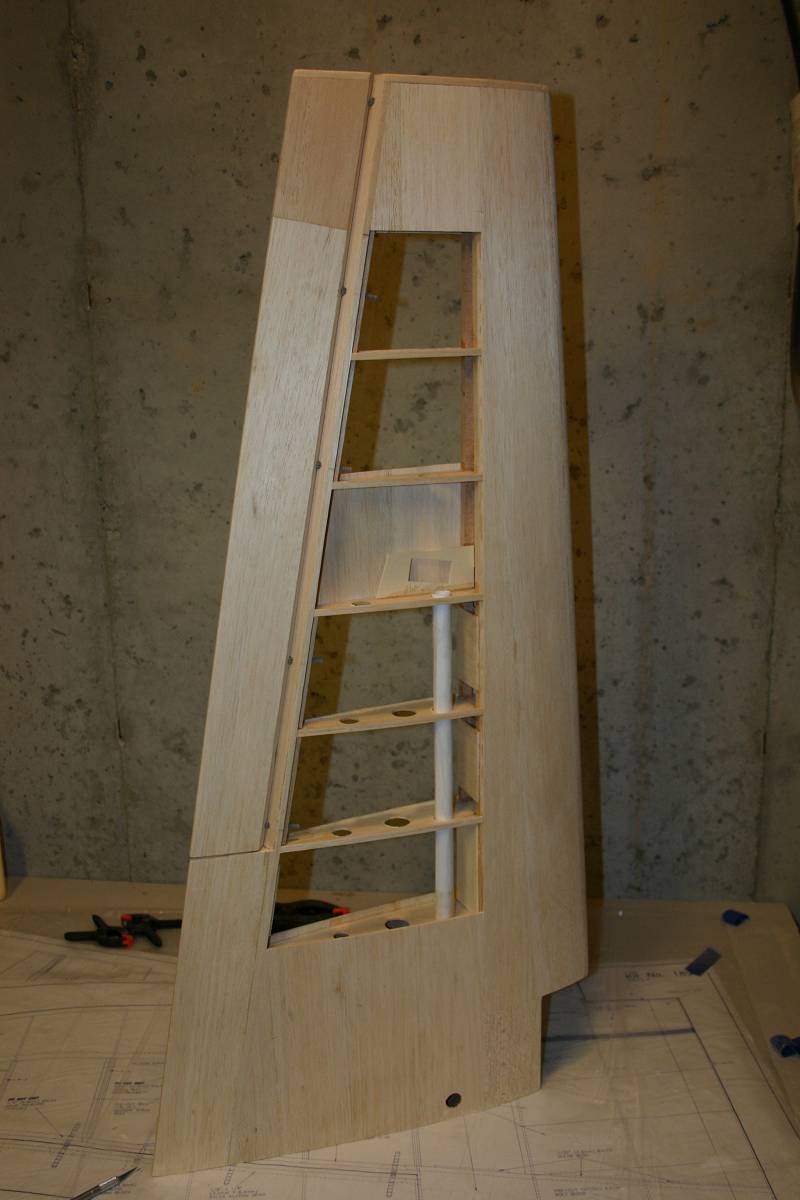

A few more update pics on the wing.
1.) Leading and trailing edge sheeting installed.
2.) Tip sheeting installed.
3.) Base sheeting installed.
4.) Rib cap strips.
7.) Wing tip cap glued on and rough sanded to shape.
5.) Leading edge carved and sanded to rough shape.
6.) Wing bolt block sheeting and aileron servo wire hole cut.

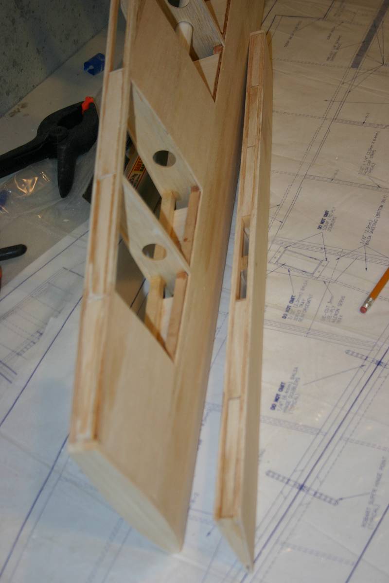

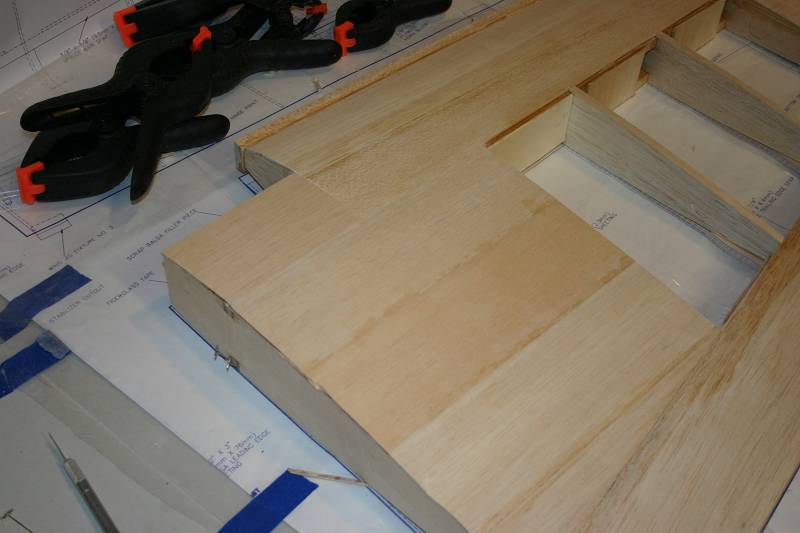

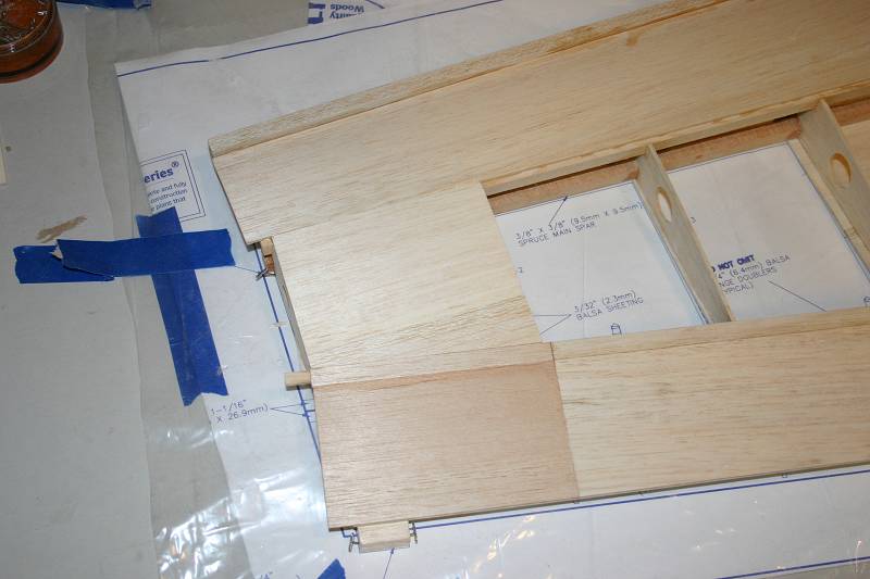

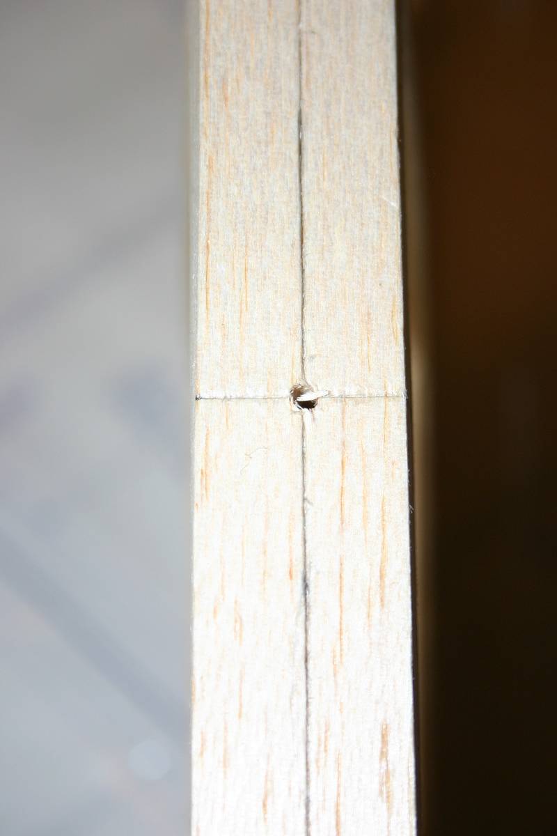

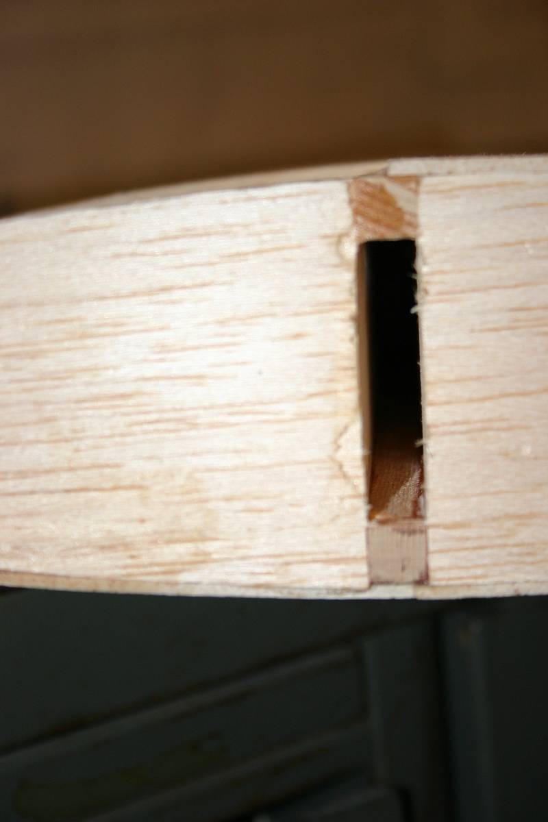

Next step is cutting the aileron off of the wing,[X(] I really didn't like doing it this way. Building the wing and aileron and wing in one piece is ok and pretty efficient I thought, but you could end up re-building them if you are not careful while cutting.
First pic is the cutting process and the second and third are the results after sanding the cut edges flush with the spars. Fourth is the trailing and leading edge hinge blocks installed. Next is the leading and trailing edges glued in place ready to be drilled for the hinge pins and the bevel shaped on them.

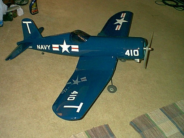

Hey guy that looks familiar Hehehe ,I know how the alottment of time always goes elsewhere , but your getting there ,for ya know it your going to be covering that doll,keep up the good work.I did get back to my little project some ,at least enough to see what it will appear like when finished.I'll be checking back to watch your progress.Looks mighty fine to me great thread.Happy Landings

A few more updates,
After sanding the leading and trailing edges flush with the sheeting,
1.) Marked the hinge locations on both aileron and wing and step drilled to the right size
2.) Beveled the leading and trailing edges
3.) Cut recesses for the hinge point in the edges
4.) Hinged the aileron to the wing to check for clearance and hinge gap.
5.) Full hinge gap
