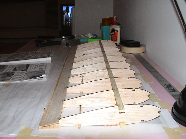

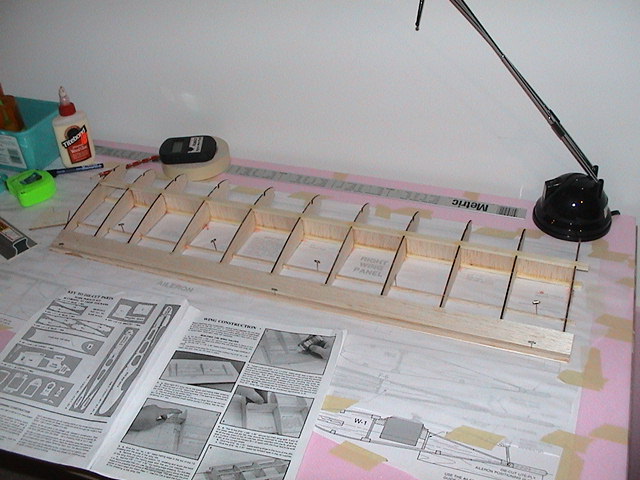

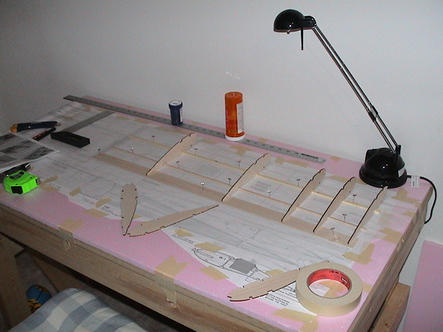

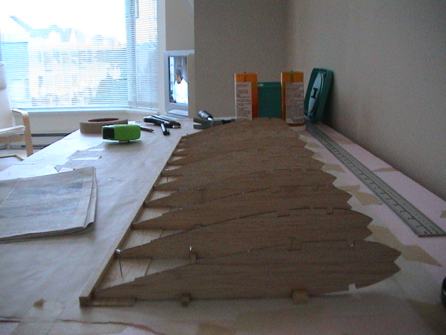

I started building a Sig 4*40. Its my first kit as I have never built one before.
I started with the right wing. I made some progress over the weekend. I installed/glued all ribs plus the T.E. I am now ready to install the rear top sheeting. The instructions recommend using Sig Bond (Aliphatic resin) at the joint between the back of the sheeting and the T.E. as it is easier to sand. So now I have two questions:
1) My LHS did not have the Sig Bond so he sold me Titebond (not Titebond II). Is it ok to use it, or should I get the Titebond II.
2) Is this glue applied the same way with CA, i.e you fit the parts and then apply the CA to the joints where it will penetrate, or do you trial fit, remove the part, apply the glue and then reinstall.
Any help is much appreciated. Thanks

First off, the glue you have will work just fine. You can also use Elmer's Carpenter's Glue too with no problems.
Second question, no you cannot use this glue like CA. CA is designed to wick into the joint between the two pieces and then bond them. With Titebond you are going to have to apply the glue to both sides of you joint and then join the parts together. Make sure you wipe off the excess glue that seeps out when you join the pieces. It's going to take about 30 minutes for the bond to dry to the point where you can handle it. The parts will have to remain undisturbed while the glue is setting up.

I am trying again to upload the photos, I hope it works this time. The sheeting is still not installed.

Yesterday when I installed the top main spar I tacked it in place with thin CA. Today I came to apply medium CA and I realized that at some places the spar is not absolutely flush with the the top of the rib ( the spar is about 1/32" igher than the top of the rib). I dont know why this has happened, I worked hard to make sure that the spar sat all the way down the notch in the rib. Is this a problem. Do I have to take the spar out, or is there a way around it. I thought about sanding the spar a bit.
Your thoughts please.

While the best would to have had the spar sitting in the "bottom" of the notch in each rib, it's not going to be a big deal if not. You would probably cause more damage by trying to remove the spar than if you just left it. Since you're using CA for your build, run a bead of thick CA where the spar and rib meet. Or even a small bead of 5 minute epoxy will do better. Just get something there to stabalize the spar and rib. You'll be ok. Chock it up as a learning experience
Ken
Ken
Ken, I think he is saying that the spar sticks up above the ribs instead of being flush. IOW, the covering will not contact the ribs near the spar and any sheeting may also not fit correctly.
argileh - did you clamp everything in place or just rely on the CA. Are you just using CA? Do you think you could relocate the spar if you used CA debonder to loosen the current joints? Maybe apply a little clamp pressure while applying the debonder until the spar shifts? Then reglue as needed. Let set before removing clamps.
