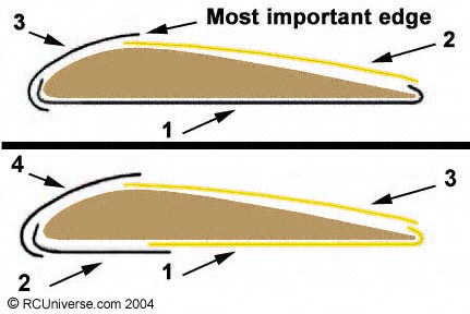

Now I am looking for advice, suggestions, tips (what-have-you) on the covering of the wing tips. I have never built a kit that had flat wing tips so how do you go about covering them without getting deep wrinkles and creases? Do you cover the tips first and then the bottom of the wing, and then finally the top? Or do you pull the covering tight into the tips as you normally would? Please advise.
The prior steps above were done last night, but it got to be too late to post, so now today I am at this step. With the right wing tip trimmed and sanded to shape.
How bout those suggestions. How do you all cover your flat wing tips?

Ok, here is how I would cover the wingtips on this plane. Since the wingtip is flat it's actually pretty easy to do. First cover your wing panels. When you have the covering completely stretched and ironed down on the wing panel then cut off the covering so that you have a "flap" of about 1/4" or so. Fold this over the end of the wing and iron it down to the outside edge of the wingtip. Do the same with the other side of the wing panel. Now use a single piece of covering to cover the actual wingtip, covering over the "flaps" you iron down from the wing panels. Do it this and you'll have a seamless covering piece and the covering will be anchored tightly for the wing panels.
Ken
Ken

STUPID QUESTION: The plans always say to overlap covering at all times, does that apply to this? Do I want to overlap the top and bottom covering the usual 1/8-1/4" with the wing tip covering or end the tips where the wing panels end without overlapping? TOLD YOU IT WAS STUPID QUESTION
It sounds to me the way you are explaining it that I do not, am I correct?

You should ALWAYS overlap the covering where it meets. On the wingtips it's not going to be overly critical because you won't have much fuel residue and exhaust out there, but the covering sealed on top of the overlapped part will keep it from lifting up in the slipstream. Now as for the rest of the plane, you definitely want to overlap. For the fuselage (sorry, I couldn't find a diagram for this) you should always work from the back of the plane to the front. This way your overlaps "face" the back of the plane, this way exhause and fuel reside won't work up under the covering seam and cause it to lift. For the wings, see the attached diagram as to the order of how you should cover it.
Hope this helps
Ken

I do the wing tips basically like Ken but I usually cover the ends first and then the top/bottom. Works well for me.

When you overlap the monokote (UltraCoat is stronger) it's a good idea to use a little trim solvent on the overlap. It's also a great prep to the balsa surfaces if you need to recover an area that blew off in the sky, and castor/fuel has contaminated the wood slightly. After you treat it with this stuff, Monokote will stick good.
