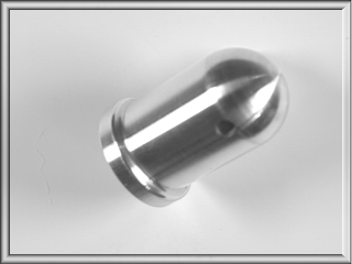

This should be the easiest question to answer this month. I have a Nexstar that I've been flying since this fall (1st plane) I bought a Greatplanes J-3 Piper on ebay a few weeks ago. Decided to try to start it today since after two flights with Nexstar it is just too windy. My electric starter Hobbico Torqmaster deluexe has the large rubber insert , the piper has an OS 60 with a small metal nut/spinner. There is too much slippage when trying to start. I've been browsing through Towers and found the Miller Starter Insert Pink Hobbico. Is this the one I need to order?

I have the pink insert. It works great on spinner nuts, acorn nuts, and prop hubs.
