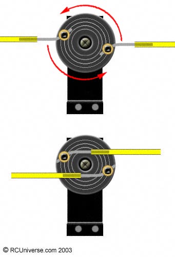

I thought a retract servo rotated 180 degrees. Mine only seems to rotate about 160-170 degrees. Is that normal?

It could be normal depending on the model of the servo and settings within the TX.
What servo do you have?

I found the following in the 9C Super manual
Retract servos are NOT proportional. Changing END POINT will NOT adjust the servo throw.
pg 32 of the manual.

You are actually much better off with 160 - 170 degrees of travel. Otherwise (With 180º) you need to arrange your travel so the pushrods don't hit each other. To do that, they must go past the farthest point and return slightly so they don't hit each other when they are in the opposite postion.
Maybe servo manufacturers are finally starting to realize that.

I might be better off, but I had already set up the linkages for 180 degrees. Oh well just something else on this plane I have to redo. So it is not an issue that the retract only goes 160-170 even though in the Futaba literature it is a 180 degree retract servo?

You're going to redo, for six percent? That's sixty thousandths difference for a one inch travel. I wouldn't think you'd have to adjust the servo arm radius at all. None of my mechanical retracts would require that, and the air retract switch links I use wouldn't be that sensitive either.
