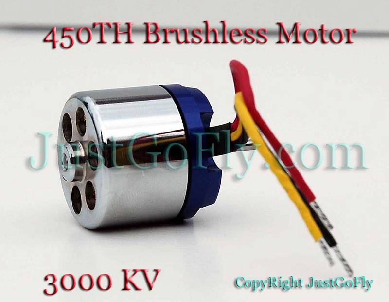

Okay if i do get a brushless engine and a battery from JustGoFly would it work on the stock parkzone controls or should i get a better controller then get the stuff but like what do i need is it a
450T Brushless Motor
and what kind of battery would i need and prop he said umm 7x5 prop. Or to get more thrust i can do a 7x6 so? What should i do help me please lol and umm if i do get it will it have instructions on how to install it?
Brushless motors can not be used with speed controllers meant for brushed motors. You will need a brushless electronic speed control to operate this or any other brushless motor.
The bad news is that the brushless ESC often is more expensive than the brushless motor it runs. Make sure that the ESC has enough amp rating for the motor. Trying to run a 20 amp motor on a 10 amp ESC will fry your ESC.

Dude if that motor in the pic in your first post is the motor you bought with the intension of hoping up your stryker b then it will not fit. At least not easily anyways. What i see there is an out runner type motor (this is where the outside can spins) and what you need is an in runner type motor (where the inside shaft spins)
Now dude listen to me... before you dart off (no pun intended) and buy anymore stuff.
STOP!!!!!
First off its not very cost effective to hop up a stryker b unless you have most of the important parts lieing round
by that i mean
a standard receiver and transmitter (not what is sold with the stryker b)
if you want more fun with your stryker b and dont want to spend too much money right up front contact park zone ask them to recomend a lipo battery and charger for your stryker b
while yout at it buy extra motors for the strker b (your going to need it) and when you use them break them in by removing the prop and running it on low throttle for about an hour
make sure that there is no arching (sparks) on the brushes. Then use the lipo prop that came with your stryker b This is the cheapest route to more fun with your stryker
if you insist on hopping up you stryker then this link below will supply you with all the insite you need and more trust me
http://www.rcgroups.com/forums/showt...89169&page=240
i dunno if the link will be removed or not so go to google and type in "F-27 how far can you take it" click on the link with those words and read read read.
but fair warning
if you are going to try hopping up then just consider this first
you need standard equippment to do this so you need
1) brushless motor inrunner type ranging from 22-25-28- or 3000kv believe it of not parkzone uses the 1880kv on the stryker C and boy does it scream!
the cost of such a motor ranges from $60-$100 most people use mega motors which are round $90
2) standard Receiver $30-$70 and standard transmitter wow that can cost anywhere from $60 and up just depends on what you get
3) two standard servos $16-$21
3) motor speed controller anywhere from a 20amp to 40amp so thats around $40-$70 depending on brand
4) lipo battery pack whats normally used are thunder power packs 3S1P packs from 2100mAh at 20 or 30C ratings your talking round $60-$80 and chager ment for lipo which is anywhere from $30-80 or over $100 depending on what you get.
Im not kidding all of this is what you are going to need to get to upgrade that stryker. now unless you have all of that round somewhere your talking too much money in my opin
listen your best bet..
your very best bet if your yearning for a zippier stryker is to just get the stryker C from parkzone and be done with it
thats only going to run you $250
you get the plane the TX the battery and charger the motor heck you get it all for just $250 and you get a very capable very fast very agile stryker that can go vertical in an instant
its worth it and its a hell of a lot less of a headache than putting it together your self. unless you got money to burn and a load of patience
i really hope this helps i really do cuz just a few months ago i was in your shoes haha :P
that motor you got though.. i woulddnt feel like it was wasted money though.
im sure its a pretty good one so hang onto it and im sure in future you can find good use for it
it never hurts to have extra parts trust me!
xero.

Sorry i forgot to answere your other question
the ESC is actually the speed controller or electronic speed controller (esc)...it basically controls the motor functions
on standard brushed motors there are two wire controllers and three wire controllers for brushless motors
you dont see an esc on your stryker because its built into the receiver that came with the stryker (you know that thing encased in the yellow plastic? thats your Rx or receiver)
the stryker b do not use standard equippment just stuff made specifically for parkzone.. which is cheaper...not of less quality mind you just cheaper in cost, but they are appropriate for what they do and as such they are proprietary meaning they cant be used with anything else but what parkzone makes (unless your really crafty about it)
the stryker b are usually grey camoflage and use brushed motors and nimh batteries while the stryker c are tiger camo with brushless motor and lipo battery check it out on parkzones website or horizonhobby.com
the stryker A isnt sold anymore you will only find stryker b or c
again dude good luck
xero.

The thing is, The servos which are already installed in your Stryker B are (I think) 5 wire servos. Standard servos are three wire. All standard Receivers use Three wire servos (as far as I know anyways). so this is why you would need new servos.
The whole reason for this goes back to your motor.
As the motor is the first thing people tend to think about when they are hopping up any airplane (my opin).
The idea is that you use a brushless motor. The motor you are going to need uses three wires for its magnetic coils.
The only thing which will run such a motor is an ESC and there in lies the begining of your problems.
To use an esc you need a radio receiver which will allow you to plug one in.
The ones which do this are Standard Receiver boxes. Case in point, the one included with your plane is proprietary (they are made specific for parkzone and their applications and hence are for the most part, incompatible with Standard RC equippment)
so then...
you buy the motor, the propeller, propeller adapter, the esc and a new radio receiver box... NOW you also need a standard transmitter and propper crystal pairs on the same frequency before you can use such a Receiver... not to mention that the standard radio receiver will now only be able to use standard Servos.
so... in a nutshell.
YES you need to buy new servos....
Again ill suggest that you just buy the Ready to fly (RTF) stryker C.
Soon thats where my money will be going...
either that or i get the ARF version and just use my standard equippment on it since I already have those lieing round
good luck
xero.
