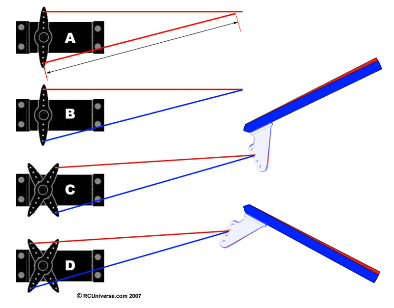

There is a thread here in the beginners forum about two elevator servo's. There are a couple of posts that suggest putting the two servo's on, one on each side, using the up vertical servo arm for one elevator side and the down servo arm for the other elevator side.
I'm sure people like RC Ken, Bruce, and MinnFlyer (Mike) (and, not to slight others, but I'm sure there are more) have done this at least once in their RC career..
and has something to say about this.
My question is this: Will this cause some sort of differential in the operation of the elevator, favoring the up side of the servo arm with more movement than the down side? (consider the angle that the control rod from the servo hits the control horn)
Dick.

It appears that configuration works best when you place the two servos vertical relationship to each other such that the two pushrods come back from the elevator horns as nearly on the same line as possible. That means that one servo is tucked up as close to the horizontal stab as possible, while the other is much lower on the fuselage. The arrangement will drive the two pushrods as nearly the same as can be done when one is being driven from below while the other is being driven from above. The reason the above/below is important is the arc the two servo arms follow. One arc will follow the arc the elevator horn follows. The other arc does not. They will then lose a very tiny bit of uniformity of motion.
The limitations to this are the size of the fuselage back there and the size of the servo arms. Also, you have to know beforehand which hole in the servo arm you're going to use for the pushrod connection. And of course, you have to accept that it's still not going to be absolutely perfect. No matter how you orient where the two different connection holes, the arcs going in opposite directions causes different movement.
Given the tolerances in our hardware, the differences are not always of any consequence.

The up/down arrangement works "good enough" for some folks, but usually only when the pushrods are aligned. There will be a very tiny bit of difference, and you'd better pray that you don't need to change what holes the two pushrods are connected to in the servo arms.
The reversing Y will work perfectly as long as the two servos are matched for neutrals and throws. I'd bet the odds are good of finding two that do. But haven't had to do it. soooo
A computer radio will also work perfectly with each servo plugged into it's own recepticle, AND it'll probably let you adjust neutrals, throws etc for each to get very equal outputs. But then......... what if you want to mix rudder>elevator. Radio probably will do it but could take a rocket scientist to set the radio up. That's just conjecture. I never had the radios I've got today back when I used two elevator servos. Back then I had to rewire one servo.

Dick, unless you're flying very presision stuff, I wouldn't worry about it. In fact, the Pacific Aeromodels Gee Bee "Y" Racer uses this method - this is a 180 4-stroke size airplane which you can see a review of [link=http://www.rcuniverse.com/magazine/article_display.cfm?article_id=132]HERE[/link].
Now on The Gee Bee Y, they DID have one servo higher than the other, and that's a big help, but if you look at the image below you'll see that even with some pretty radical throws, there's not a LOT of difference.
To describe what the image points out:
A) The distance from one side to the control horn is shorter on top than on bottom.
B) The bottom pushrod has been made longer to compensate.
C & D) As you can see, the top pushes a little more in one direction and pulls a little less in the other than the bottom - If the two servos were aligned so thatone was higher or lower than the other, this difference would be even less.
Bottom line, If it were me, I'd stagger the heights of the servos and I wouldn't lose any sleep over it.

Exactly! I run this stuff on several planes. No big deal. Maybe in precision aerobatics obviously but I don't see an issue here at all. One rod is a tad longer at the same angle, so what? Works fine
I will probably just keep it the way it is now and just fly the thing.. ha..
