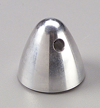

DON'T Start the engine with only 1 or 2 threads on the nut it simply is not enough. I avoid spinners and like to use the aluminum hubs that replace the prop nut. this on is for 049 but they come in all sizes. A picture would help a lot if your able.

Or use one of these.
http://www3.towerhobbies.com/cgi-bin...&I=LXE158&P=ML

i agree if you are gonna use a spinner get yourself an extension and the spinner adapter setup that cgretired has posted is a good setup they are a little small but will work the spinner is the prop nut. apc prop centers are much thicker than mas props.i like the metal spinners that have the bolt adapters you use a setscrew in the front center to tighten down the spinner.
