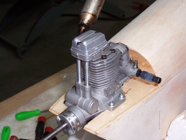

On my Cub, the TT.61RFS is leaking fuel from the high speed needle. The only thing I can think of is it's the rubber o ring. Any place I could get one other than ordering directly from the mfg?

You might have luck at a local hardware or home depot. I'm not sure if their o rings will be fuel resistant, some might.
A little trick I've used before is to cut a small piece of fuel tubing and slide it over the needle valve so it covers the threaded section completly. Might work for awhile until you can get an o ring. ENJOY !!! RED

I`m pretty sure the size you need is a 3mm outside diameter with a 2mm inside. I have a Magnum .52 4c thats giving me the same problem . The HS and LS needle uses the same o-ring.

I have cut o-rings down and used super glue to splice the ends . Never tried it on one so small , think I`ll give it a shot .

I have used teflon tape on a couple of SuperTigres and it worked well, but I can move the HS from side to side , and not sure whats up. Going to tear it down and see whats going on.

Heres my fix, worked better than when it was new.

Is that just plain ol' fuel tubing on there?

Looks like "plain ol' BLUE fuel tubing" to me.

Yep x-large. lol. Works great, takes a little fooling with.
