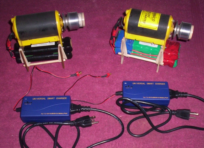

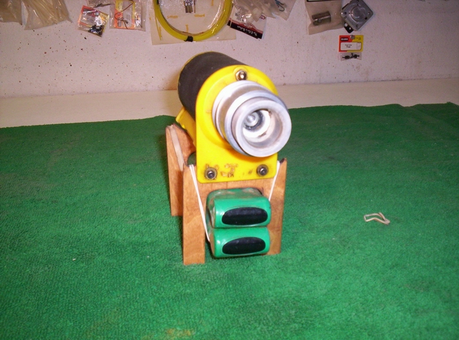

Old 10-05-2008 | 10:47 PM
JohnBuckner's Avatar
Posts: 10,441
Received 11 Likes on 11 Posts
From: Kingman, AZ
Default RE: electric starter
[/quote]
Can you tell me more about the packs you use? Are they sub-c?
[/quote]
The lighter starter uses two 3000 Nimh 7cell packs (sub C size) in series for a total of 16.8 volts and this imparts major performance over all the commecial portables I've ever seen. My mondo starter is the same cheap Tower starter with a high capacity switch and two 5000 Nimh 7 cell packs (C size). This combo outperforms even many geared types.

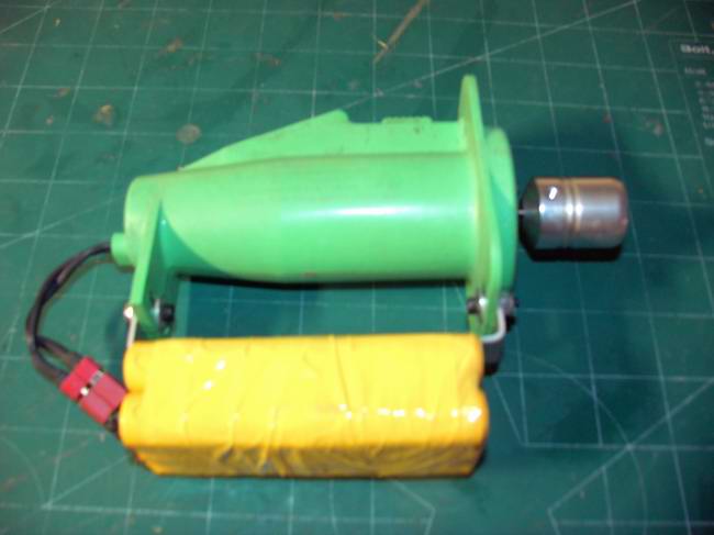

Old 01-18-2009 | 01:21 PM
Jetdesign's Avatar
My Feedback: (8)
Joined: May 2008
Posts: 7,056
From: Honolulu, HI
Just for a little clarification:
I'm unclear about the 'amperage' here. In other threads people were saying that the hobbico power core was weak due to the amperage - 1.2 amps. Is this different than having a 12v 1200mah battery?
I just got the heavy duty starter. There seems to be little difference between that and the regular '90' starter. I tried both with the power core 1.2 amp battery, and then with my car batter.
I then tried my '90' starter with my 14.4v power drill battery, and WOW! I think it's a 3amp battery. This is different than 3000mah?
I want to get two of the 7.2v rc car battery packs and wire them together with the above connector. Will there be a difference in cranking amps with different capacity batteries, or is the capacity strictly the length of time the battery will run?
Also, if my charger can charge up to 16 cells, can I just charge the packs while still connected in series?
I was not looking forward to taking my EE classes, but I'm so sick and tired of not knowing this stuff! Next semester hopefully I will be able to give advice and not have to ask
Old 01-18-2009 | 01:48 PM
Joined: Oct 2005
Posts: 1,993
From: Deland, FL
gaRCfield
I'm no EE.
But a 3000 Mah battery will give you
3 amps for 1 hour.
As for charging, charge each pac seperate.
Also 1.2 Amps is 1200 mAhs.
Bob
Old 01-18-2009 | 01:53 PM
Posts: 7,182
From: Burlington, NC
Go to Walmart and buy a $30 Black&Decker Jumper battery, you will use it to start, charge, all kinds of things, it comes with 2 or 3 chargers from the house or car, will jump off your miata or the honda thats been sitting in the basement for 3 years (yes it will) and anything you need 12 volts for at the field without ruining your car battery (had that happen too)...its a great investment,I saw a guy at the field with one charging his lipo's and I was having trouble (redoing a 91 miata) with a car and BOING it hit me , what a great idea...so I got one, very useful so far and after 2 days of carb cleaning I DID get my 95 Honda Magna running!!!...course the tank is shot but thats another story......Rog
Old 01-18-2009 | 02:19 PM
Posts: 10,441
From: Kingman, AZ
Do not increase the voltage if you expect to keep your starter with your stuff and not have to go looking for it all the time. Its as simple as that. No matter how much you agonize and anylyze. Mine all operate at 16.8 volts seven cell packs and various capacitys the all work great the small half A unit I charge all fourteen cells together and the two larger units each seven cell pack is wired to charge with separte dedicated peak chargers. Bottom line all the starters operate at 16.8 volts regardless. The commercial portable starters that operate at 12 volts are in My Opinion a complete waste of money.
After some years now thankfully a number of the other locals are copying this set up and I finally do not have to go looking for my starters, well at least not as much.
John
