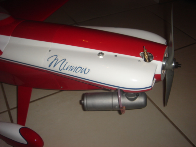

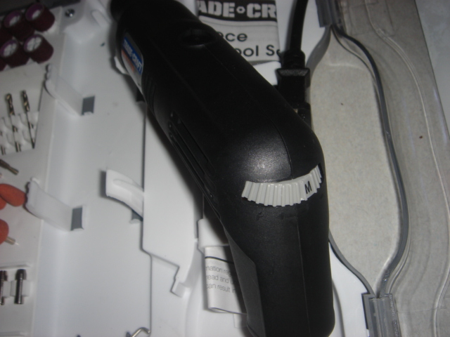

If you're a BJ's member, they have one with all the attachments for only $29.99. Can't tell it from the real brand name in any way at all. I used it on a Minnow recently.

Get a AC one with variable speed

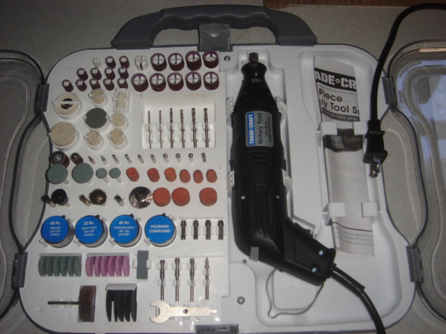

It is

http://shop.bjs.com/Buffalo-Tools-41...VVviewprod.htm
Wow, $34.99 you get a flexible 42" shaft with it. Who wants mine? I'm upgrading!

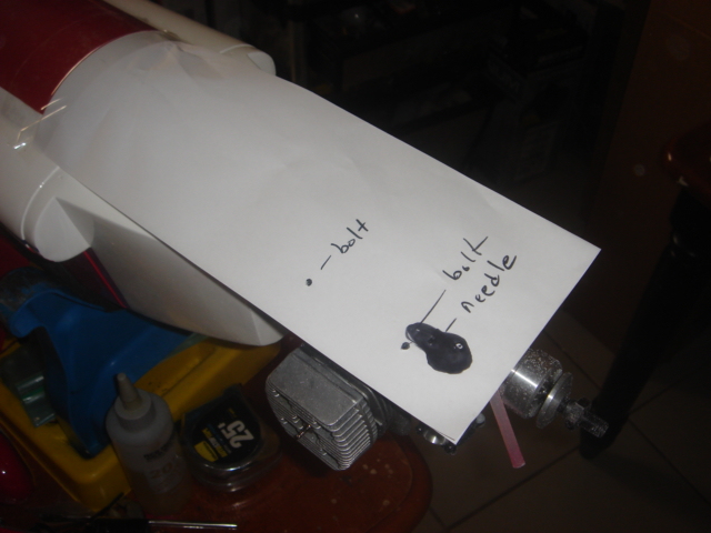

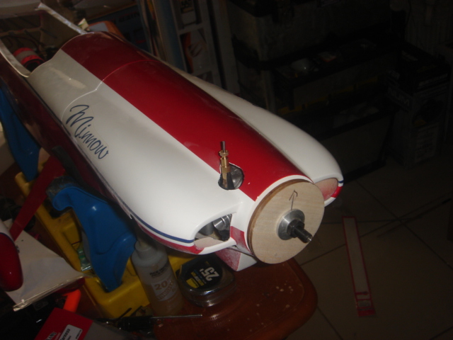

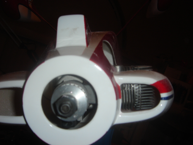

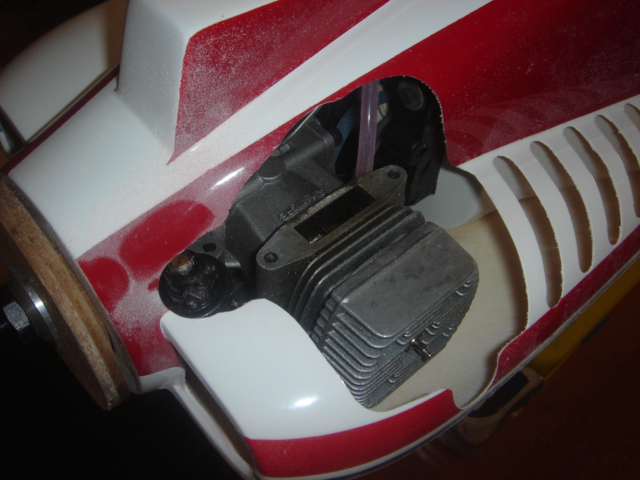

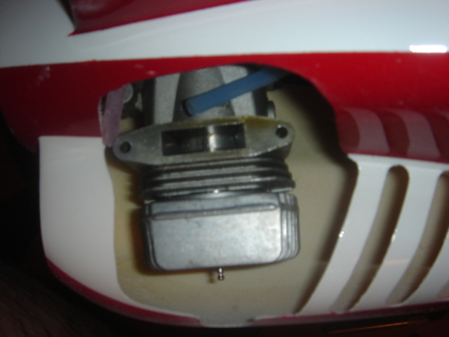

Here is some progressive steps in the photos, as it's been said, the sanding drum moves quickly into the thin cowl. You'll have to elongate some holes to allow the cowl to go on and come off as well.

The best way to avoid dribbling across the surface is to note the rotation of the dremel cutting wheel, and not cut with rotation pulling up, but rather so it pulls the rotating wheel down. Cut less than the outline, leaves room for the sanding drum to remove the frays.
