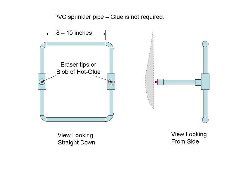

If the picture you posted is how you are balancing it then you may not be getting a good reading as to where it's balancing at. You can make a very quick balancing machine with a piece of 2"x4" board and two pencils. Drill two hole in the board that are wide enough apart so the fuselage will fit between them, then insert the pencils in the holes with the erasers up. Now mark the position on the plane that the instructions indicate as the center of the CG range. Now place the plane on the balancing stand on those marks to see if it balances. As indicated above, since this is a low wing plane you will want to balance it upside down.
Since this is the Hangar 9 PTS Mustang, and it looks like you have the recommended engine on the plane, it should balance with little to no additional weight. I think the issues you may be having come from how you are trying to determine the CG balance point. GIve this advice a try and see if you come up with a better result.
You can also do the same thing with two finger tips to balance on. Just have somebody place the plane on your fingers for you and see where the plane balances. This will do in a pinch, but you'll be better off with a more fixed balance system like the one I described above or possibly a GP CG Machine from Tower Hobbies.

Here's something I found on one of the web sites, not sure which one. Very easy to make.
