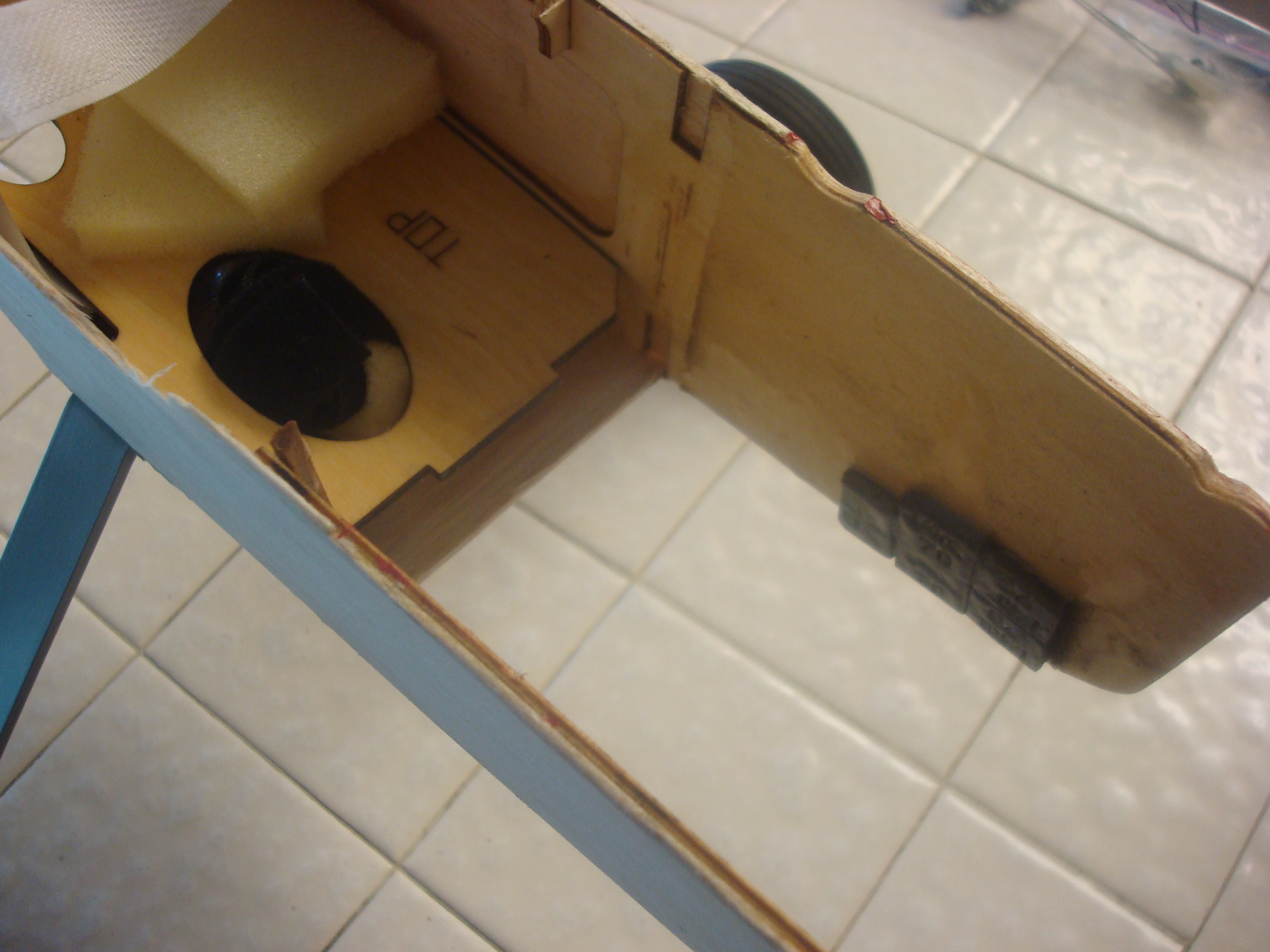

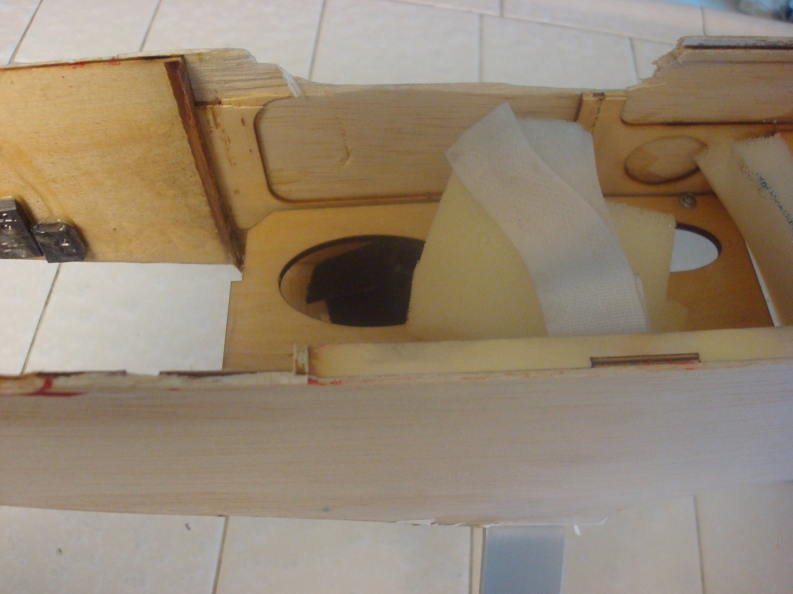

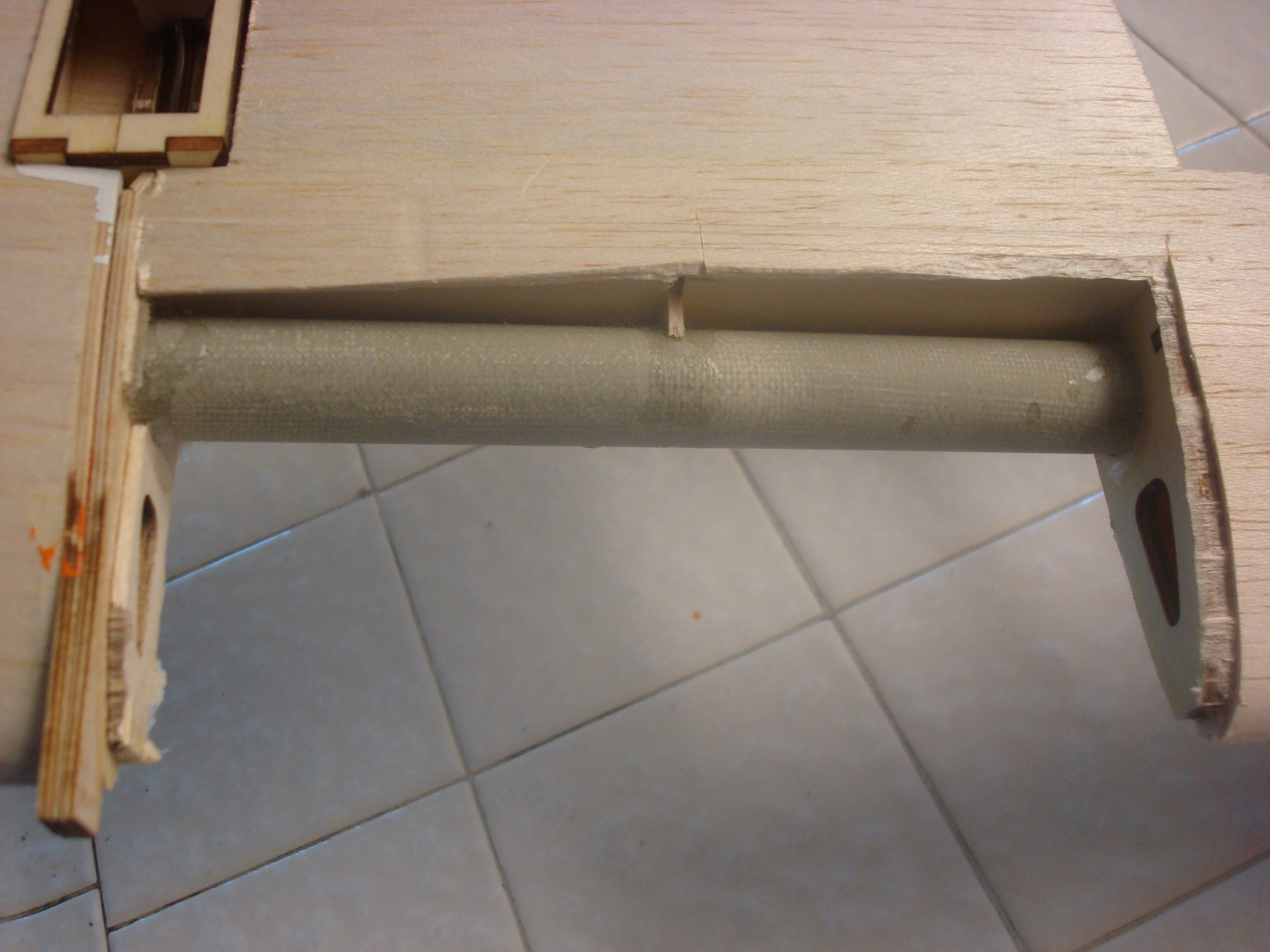

I have successfully flown the Escapade for a few month. I was able to comfortably do loops, rolls, some hover, and stall turns. Of course all this is done really High in the Sky. Landings were never a problem. Most of them were nice and smooth. a couple were bouncy. Yesterday, I was practicing more aggressive landings. I would come in parallel with the runway about 15ft off the ground, turn really tight to bleed off most of the speed, level the wings and used Rudder to align with the runway, and touch down. I was able to do that twice successfully. The third one was looking really good. Even better then the 1st two. But this is when it happened. the wheels touched ground and the escapade bounced up 2 - 3 feet. Right wing looked like it began to stall. I gunned the throttle to redo the landing. The escapade continued to suddenly Roll Right, was almost inverted facing away from me, and hit the ground nose first.
Question:
1) what I experienced was a torque roll?
2) if the wind did stall what should I have done? Or, maybe there was nothing I could have done?
Damage assessment:
The engine and it's firewall was ripped off, the canopy broke in two, the right side of the plane where the canopy would sit on is gone, and the left wing leading edge (about a foot) is gone. The firewall and fuselage I can repair (need to refab some parts). I'm more worried about the Left wing.
Question:
Damage assessment:

Damage assessment:

Very fixable. Jigsaw all the pieces back together. Replace wood that's too badly damaged or missing with the same type. Use balsa or thin ply on the inside to reinforce the pieced-in places. If the firewall is too badly damaged to repair, make a duplicate. Cut the wood carefully and make it fit right. Don't rely on glue to fill large gaps - it will be structurally unsound. However, you can use thin CA to soak the inside of the area. This will make the repair very strong. The wing is easy. Use an angled-end splice to replace the LE, and simply lay down replacement sheeting. It looks like you have enough rib there for the replacement sheeting to rest on.
You'll be using a jig or band saw, probably an X-acto saw, and an X-acto knife. Maybe a drill (holes in the firewall. Sandpaper and putty, too. Thin and thick CA.

Agree...quite fixable, using ust the ideas/methods Dr1 suggests.
One thing I might toss in as well...
As you repair/reinforce the firewall area, you may use thinner wood in one area, or thicker in another, different kinds/amounts of glue, etc etc. All of this will likely change the weight a bit, making rebalancing necessary.
If those weights currently installed will be tough to get to after the repairs, might want to pull them while it's easy.

I don't have a band saw. Nor do I have fine wood working tools. I do have an X-acto saw and X-acto blade. What can I use to cut straight on a 1/4" plywood and make round curves? I don't have one but can I use a Dremel Multi Max tool (oscilating)? what about a scroll saw? I'm willing to go out this week and get some fine wood working tools. Any recommendations?

I don't have a band saw. Nor do I have fine wood working tools. I do have an X-acto saw and X-acto blade. What can I use to cut straight on a 1/4'' plywood and make round curves? I don't have one but can I use a Dremel Multi Max tool (oscilating)? what about a scroll saw? I'm willing to go out this week and get some fine wood working tools. Any recommendations?
In the end you might discover building a kit is more satisfying than building an ARF especially when a landing speed mishap occurs. Kit damage is almost always far more forgiving than ARF damage under the same situation. A similar yet much stronger plane is a SIG Kavalier, Hobby Horse has then in stock for $72. Anyway, that's another thread.
You'll want to cover the joints in your repair with something like epoxy and a strip of thin fiberglass material. These generally require nose weight, so you can remove your lead segments now, recheck CG when you're done.

what kind of balsa do I use to wrap the wings in 3/32" x something x something? I went to my local hobby shop and found the same kind of balsa but it was way too thin - 1/32". I'm just wanting to know what kind of balsa it is so that I can order more from Towers. Also, I noticed the balsa on the body of the plane is harder/denser - its not plywood. that kind of balsa the hobby shop has plenty of.
Join Date: Jul 2002
Location: Spartanburg,
SC
Posts: 3,770
RE: What should I have done?
Balsa typically can weigh between 4 and 14 pounds per square foot. For our use, it can be categoried into 3 types.
"A" Grain - Lightest in weight. Light color, not much grain pattern. Easy to bend without splitting. Typically used in gliders, wing sheeting, and other applications where it must be formed around a shape. Often called "Contest" balsa, and is specifically available from bulk suppliers like BUSA, Lone Star, and Superior. You will occasionally find some in hobby shops.
"B" Grain - Medium weight and flexibility. A good all around wood for general building use. More pronounced grain pattern. Good for fuselage sides.
"C" Grain - The heaviest and strongest grade. Doesn't bend much without splitting, so use it for flat applications. Very hard with a pronounced grain pattern, often grayish in color. Good for bulkheads or wherever much strength is needed.
For your wing, match the thickness with what's already on there.
