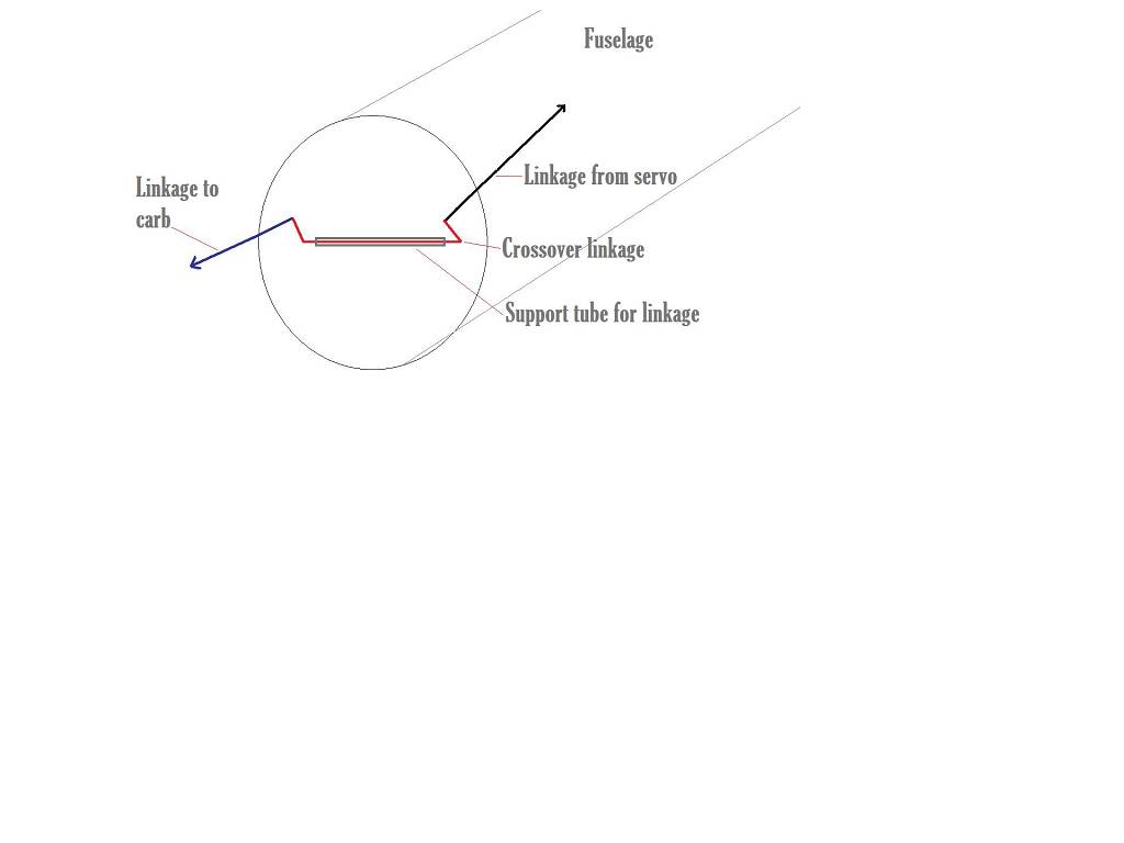

Ummm, how bout something like this? Used it when we did an engine change on a car where the throttle linkage was on the opposite side from the removed one.

That's not a bad idea, though there's a chance that it will interfere with the engine mount.

That does not appear to be a bad idea either. I am not sure what it would do to the torque values on the servo but I am also not that sure it would matter all that much to a standard servo on the throttle linkage.

That is a good idea. On the Saito though, the linkage is going to be in the center of the firewall(almost) and not on the far side. Once you flip the carb it will be on the far right side.
