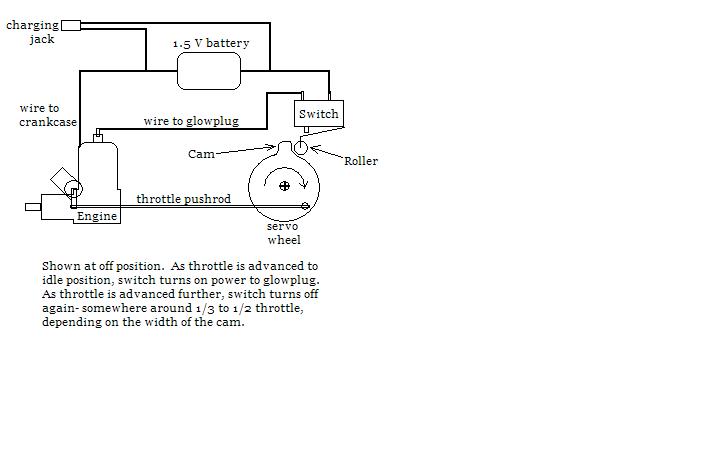

is there any way that a guy can make his own on board glow driver</p>

Sure. A glow driver is nothing more than a battery cell at ~1.5volts. A very basic onboard glow driver is as simple as a battery, a micro switch, and a servo. Wire the battery through the micro switch to your glow plug on the positive side of the battery, and on the negative side to the body of the engine. Position the micro switch so that it is operated by a servo. Now you can activate the switch through your radio.

You can use a round servo horn on your throttle servo and grind it like a camb lobe so the switch goes on from about 1/4 before idle. You also want an on off switch wired into the + wire that goes to the glow plug that is on the outside of the plane so the battery isn't always on when you turn off your plane.

is there any kind of digram that i can look out to help me out

I have built 2 of these 'hardware' type glow drivers and they work quite well. It takes a little patience with a dremel tool to carve the throttle servo wheel to get the cam the right size and shape. And of course you have to remember to charge the extra battery. Here is a diagram I drew up, hope this makes sense...

what kind of switch do i go buy

You need a little lever switch with a roller on it. Like this one from Radio Shack...

I use two switches, the one ho is showing you and in the same bin at radio shack are some without the roller, both work fine.

The roller on the switch lever is a beautiful and eleghant solution . . . but it requires relatively precise alignment. I silver-solder an actuator arm on the end of the plain switch lever and it can be anywhere within 1/2" vertical alignment and then I don't have to worry about making a switch platform to get in aligned with the servo wheel. The elastic pulls the switch back to preclude the rare (but occasional) spring failure in a micro-switch that prevents the arm from returning. We used similar switches in alarm locks where I worked and they had about a 3% annual failure rate.
