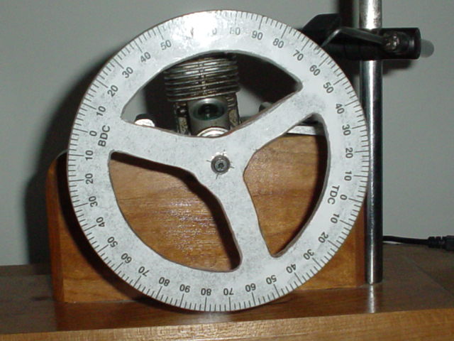

Crank induction duration?
Lateral intake port durations?
Boost port duration?
Exhuast port duration?
How many degrees after TDC does the induction port open after TDC?
I too am still learning about engine modding and am trying to learn as many timing profiles as possible to determine what each profile does as far as low RPM performance, mid-RPM performance, and high RPM performance.

Up until this point I have not radically changed the timing of an engine. I mostly flow the sleeve and wont change the timing profile as that is the characteristics of the engine. I do not want to change that. By lifting the exhaust port I am only moving the power band ex let say the power band was 7000rpm to 34000rpm, it will be 9000rpm to 36000 rpm.
I recently changed the this on my P5X.
The engine had just rediculopusly too much bottom end. Now I find good bottom with a phenomenal midrange and very good top end.
Everyone modifies in their own way. I only mod for more overall power and economy, maybe if it needs better top end.

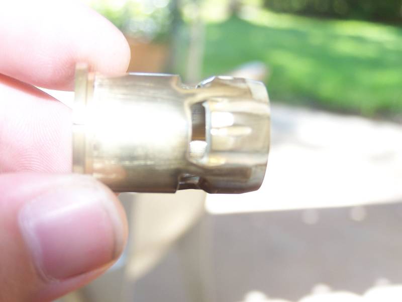

here is a modded Jammin JPX .21 that I just completed..... this work is done 100% by hand using the files in the pictures.the rough surface is deliberate, I usually will polish up a sleeve for taking pictures, but I am lazy today..... so this is how i would run the sleeve in my motor......this is a fully altered motor with pretty extensive port modifications.... Notice how the exhaust port lining is brass not chrome ?

nice job supertib.
did you change the intake timing? because it dosen't look like it.
can you give me a link to where you got those files? I found some but there not that small, and there not diamond files.

the intake timing is altered slightly ( I still have a little more work to do yet FYI) ...notice the front corners of the transfer ports ?
unfortunately you will likely never find these exact files, as they are only available locally to me in a very limited supply.. I would very much love to find a more available source of these fantastic little files ........ Be warned using these files to alter ports takes an extremely long time and also it can be extremely difficult to cut cleanly... The chrome is very tough and very difficult to remove nicely., you will likely mess up several sleeves before you get the feel of the metals......

those will work......... regular files will never cut the chrome...they need to be diamond files.

my normal files I have will cut the chrome, but it takes a long time. you can get a set of diamon files on ebay for $10

your dreaming if you think normal files will cut the chrome......as well it also takes quite some time to cut even with diamond files...... This is not something to be taken lightly..
