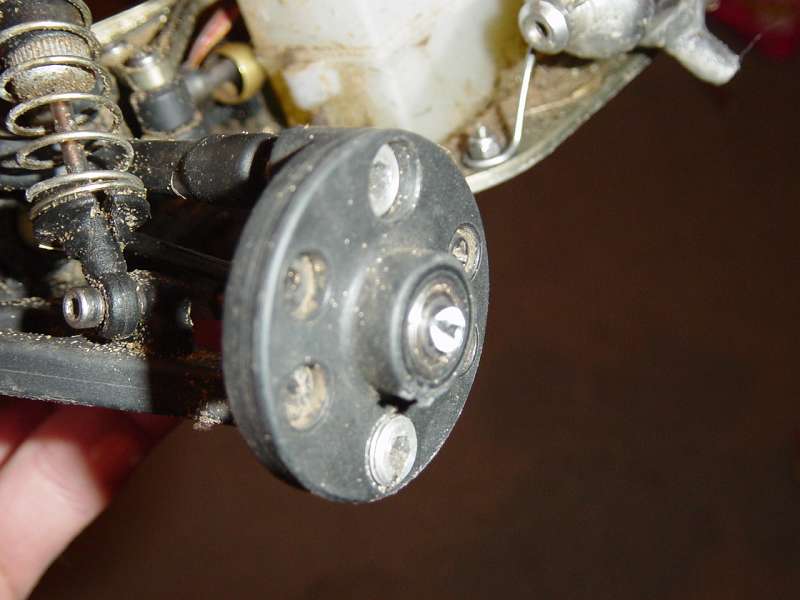

hey make sure u have the set screws tight in ur cvs - if u have the setscrew type...
doing a fast pass with my rally, it suddenly locked up and spun past me - the right rear cv pin had worked loose and cut threw the hub from pillow ball to pillow ball. no other drivetrain damage which kinda surprised me. and yes that is surface rust...
still a single speed rally setup, to hell with 2nd gear, i have a 18t 1st gear pinion - works great!
whoops - forgot, pic of typical break in my cv... always the same.

rolland - yep all of mine that have broken have been on that point, even with 2.2" rally tires and wheels fitted - granted tho, i am an artistic crash master... all have been at a fair turn of speed and have normally involved a large immovable object, was a litter bin this time around that i was using as a corner marker, only 18 innches between the bin and a wall, so i was pushing my luck i guess.
as for strengthening it... i cant see a way myself, what are u thinking?

Rolland: Na I havent tried it yet (dogbones up front).
As for strengthening what we have, what about a heat treatment like heating them up with a gas torch till they are red hot, then dumping them in oil? Im not too sure of the precise process but an engineer would know.
I sort of went down the road of getting some stronger cvd's made but nobody is really interested here in NZ.

On the strengthening issue I need to do some looking around but I have the ability to surface harden, temper, and even mig weld, there is also the possibility of having them chromed (might be to expensive) or powder coated. If that is a common place for them to break then the twisting is more than likely the cause and that is what has to be limited. I know of some machinists and cnc guy's, I'll have to talk to them about it. But I'm thinking a quick temper and some surface hardening will help them out alot.
