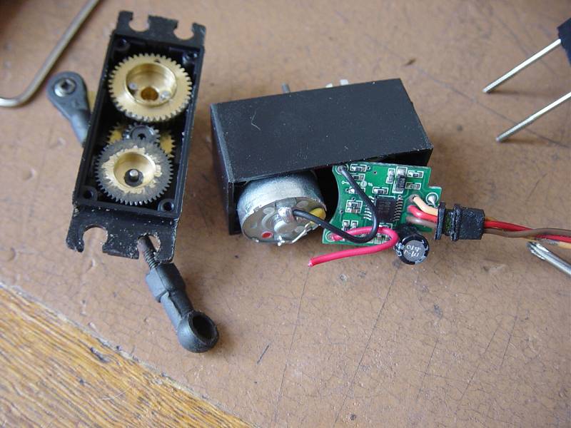

ok, just run another couple of tanks, but my steering servo has just stopped working. dunno why, it does nothing at all, was fine then nothing. im guessing at a dodgy connection somewhere, will take it all out and have a look.

aha - sussed the servo... strange one that, due to vibration i guess, as i havent crashed it...yet...
