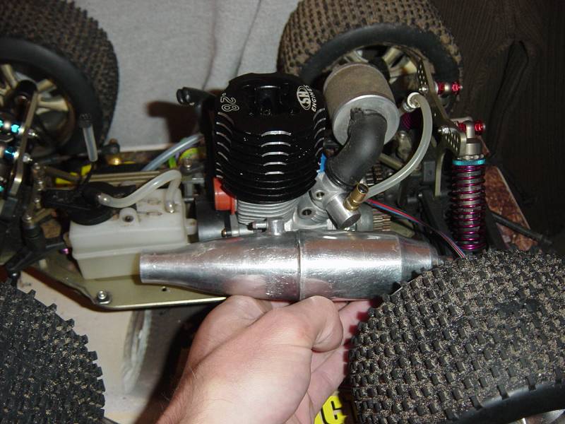

got this far today...
the pipe will just fit, and i mean just, along the side. i had to move the rear tie bars to the rear of the suspension arms, and make some new holes, but they seem pretty secure on there, no nasty suspension angles or owt. on full compression, the tread of the tires just rubs the pipe with full left lock on. mounted like this also only just gives me enough space to use the U bend from my old spare cen manifold, the rest i will make up as i go along...
gonna have to chop a hell of a lot outta the side of the shell to get it on tho - the whole pipe and manifold are gonna be hanging out the side. might look good, might look stupid, will find out soon.

i could do that yea, but its gonna look a bit funny(er) that way and wheelies/flips could well pull it off all the time. i hear u tho, its gonna knock performance a bit this way, which might not be a bad idea for the first few runs, im just trying to keep it as tidy as possible. the tuning might be a prob tho, not sure. i will ask antwar how he gets on with his, as thats a similar setup to what i have here.
have read about the fuel consumption of this engine too, was gonna go for one big tank down the right side, but the weight distribution would suffer more that way i reckon, so im going for this layout i think. just need a battery box and mod the mugen tank and the rear box mounting points.

how about putting the silencer down the left side as normal, but the other way round?
i dont see why i cant use a length of silicone tube, like the silencer couplers, but longer, to make pretty much all of the manifold/header from. that way i will just need a short, straight flanged stub from the engine to the silicone pipe, and can also keep the manifold length sensible.
the silencer fits there and the shell would need minimal if any cutting for it to cover it.
any reason why i cant use a length of silicone pipe?

Yea thats sound good. Heres what I would do tho, take your manifold, cut the flange of it, and the end you have just cut, put a silicone joiner on it and join it to your silencer (you have basically flipped it the other way round). Get another header, cut it so you just have a straight piece with the flange on it, join this to the old header with silicone coupler tube.
I reackon that should work ok.

i noticed last night that 22mm copper pipe is about the same id and od as the manifold. got lots of offcuts here too from sorting the gas supply out on the house. so i will pay a visit to the father in laws - hes a plumber with a 6 acre back yard - woohoo!
still curious about a length of silicone hose tho, i have a couple of metres of it somewhere - any thoughts on using this?

The problem with using just the silicone is when it gets warm it is going to expand and get really flexible, which could cause it to kink and let the pipe come loose.
If you use copper you can solder the joints together and have a rigid non-flexible connection to the pipe that won't kink or come loose.
Keep in mind that the longer the head pipe the more backpressure it will make. This in turn will cause the motor to make less horsepower but more torque. If you make the head pipe to long it will effect both HP and torque. I am sure that there is a formula somewhere to calculate head pipe length but I have no idea where to look for it.

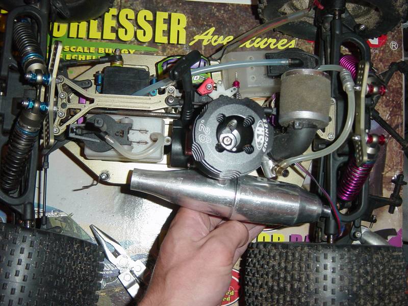

like this:
does anyone know offhand a manifold that will fit?
yes i am searching for one, but ideas are more than welcome as there are millions to choose from!
its interesting that the dynamite manifold is so long, as its for a car which i would expect to be tuned more for hp than torque. i was under the impression that the length was very crutial for proper engine running, this manifold suggests to me that there is a lot more to play with than i thought. depends on the engine tho i guess...

thanks for the input, guys, i think ive sussed it now. dont know what i was messing about at, i had the bits here in front of me all the time. will sort it tomorrow

still got the manifold to do, see above post
ha. it all looks like it will work, might be a bit ropey with 2 couplers in the manifold and 1 to the pipe tho... but its my best bet to do it the way i want to, with the parts that i have. expensive bloody hobby.
