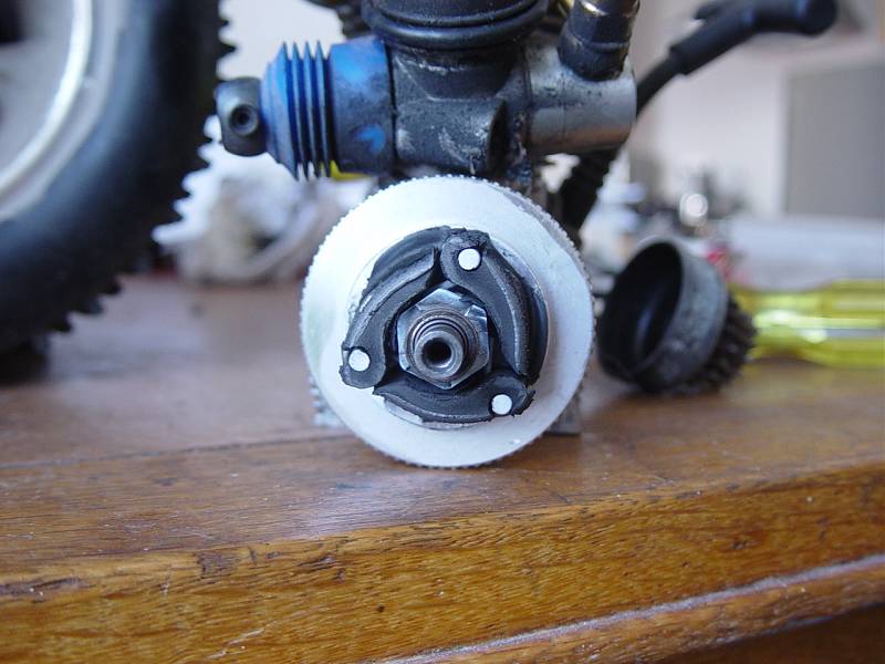

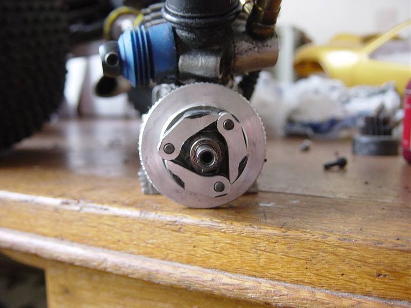

arg! still cant upload pics!! aha - i can if i edit my post!
left to right - teflon shoes.... erm dead? alloy shoes fitted, alloy shoes after 3 tanks (both tanks)
seeing that black on the shoes reminded me i didnt clean the bell out after toasting the teflon shoes... might have been an idea eh? bell is scuffed up and ready to try again. also the engine back plate had got loose, which answered some starting and running issues i had - cant believe the manufacturers dont use threadlock... shocking really...

Could it have been the black crud in the clutch bell that was smoking? Those old black clutch shoes are KNACKERED. Not sure two tanks should be able to do that to a set of shoes!
About the 1mm springs, yes Mugen make those and they should be available from the same place.
Been asking around and the Hyper 7 clutch nut will work (apparently). There have been several people telling me that they run exactly that set up.
