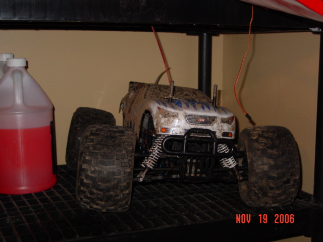

you need a chamber guage, its the angle that the tires sit on the ground.here is a pic of the nemesis and look at the angle of the tires, they are pointed out a few deg.for any large truck with a high powerd motor the chamer guage is your best friend.

Hey Jombo, The nemi needs a bath!!!

yea its been a bit muddy here in dec. soo much rain and i really wanted to run it. lets just say 1 hour run time + mud = 2 hours of cleaning and wd40 but it was FUN.
