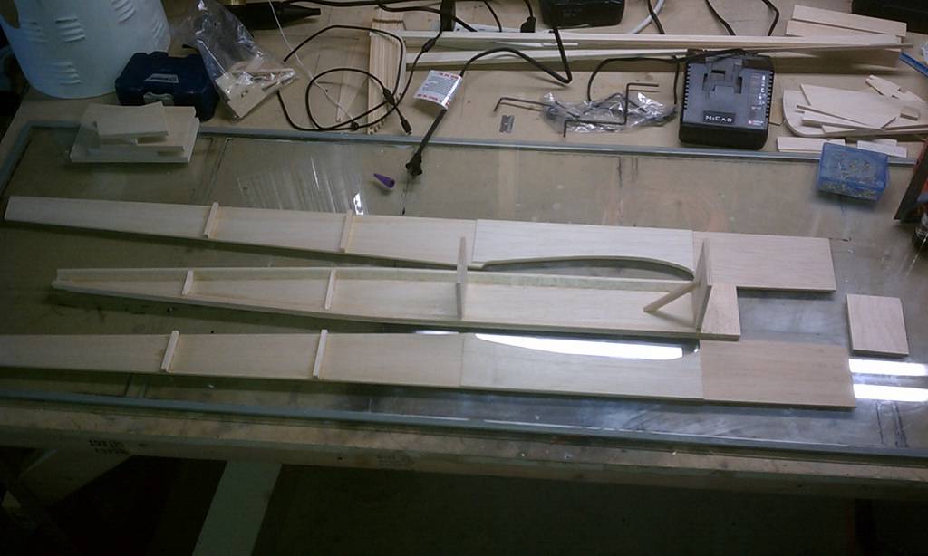

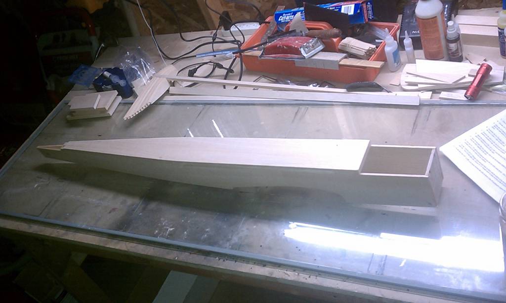

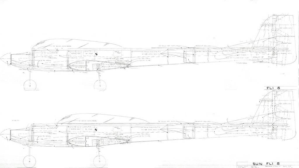

Thought I'd post some picturs of the Bridi Sun Fli 5 I'm building.
I've recently moved in with my fiance so I've been without a shop for a few months. I finally got around to getting a bench and a light set up in the new garage so I can build something.
The fuse is constructed first. The construction is very simple with two piece sides and balsa doublers at the wing saddle. Tri-stock is added to the top sheet and the sides are glued in place with the top sheet on the plans.
The forward section of the top block is made into a hatch to access the fuel tank area. The canopy is attached just behind the hatch. I have a scan of the plans, so I was playing around with the location of the canopy and since it's very similar if not the same canopy as the Dirty Birdy, I put it just behind the firewall and like the way it looks, so I think I'll mount it there and make a hatch on the bottom of the fuse to access the tank.
I'll most likely power the Sun Fly with an HP .61 Gold Cup.

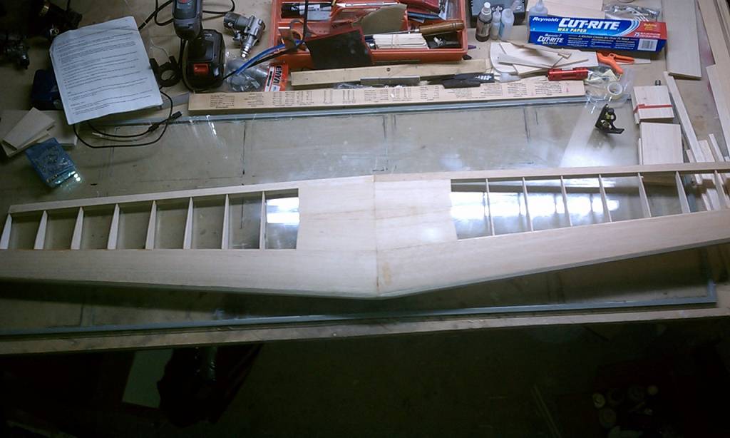

Vertical, no problem posting photos to this thread. I'm not doing a piece by piece build, but rather just some random shots to document the build.

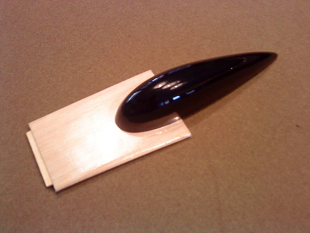

This weekend I didn't get much accomplished. I have both wing panels mostly framed up except for the landing gear blocks, leading edge and center sheeting, wing tips etc, but it is starting to take shape. So far everything has fit well and it's coming out dead straight.
I have decided to move the canopy forward and put the fuel tank access hatch on the bottom. Attaced is a screen shot of the plans with the canopy in it's stock location and with it moved forward.

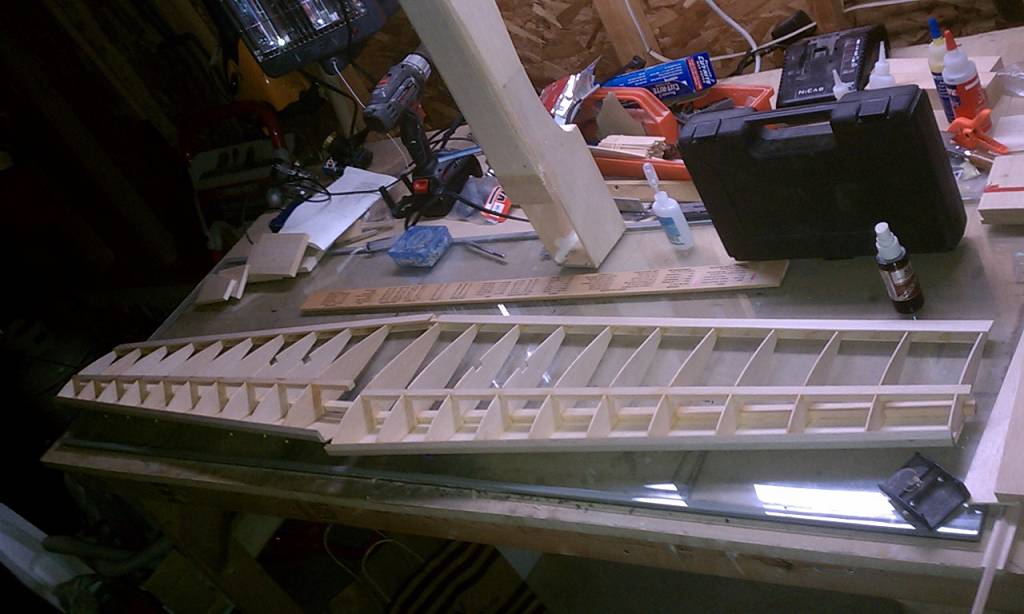

Last night I joined the wing halves and sheeted the top center section. Next step is to fit the wing to the wing saddle and mount the wing to the fuse. I will also convert this wing to dual aileron servos. In hindsight I should have drilled holes in the ribs for the servo wire. [:@]

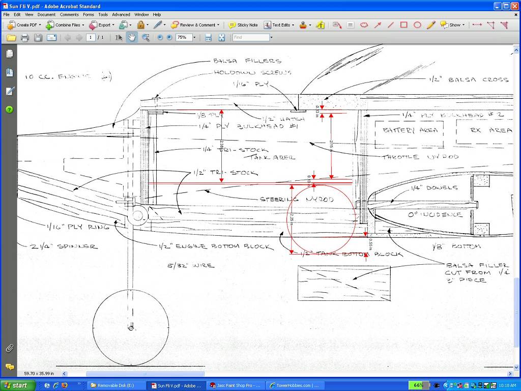

I was getting ready to install the main gear blocks in the wing and kept thinking about adding retracts. Adding the retracts to the wing is going to be no big deal, but I don't think I have enough room in the nose. I've attached a drawing of the front end for discussion.
I'm planning on using a Hayes 16oz slim tank that is 2.125" inches tall, the .13" measurements are for foam padding allowance.
If I switch to a 2.25" wheel, there is about a 1/2" sticking out below when retracted.
Ideas anyone? [&:]

what about a 14 oz Hayes and a 2" nose wheel?
Mmm... no 14 oz and the 12 is only 1 mm shallower. Pretty tight quarters in there.
The only idea that occurs to me is to use a 2 tank setup with the main behind the wing LE former feeding a 2 oz in the tank bay.
You could also alter the profile of the fuse front bottom... heresy?
Oh, you might have to forget the hatch with retracts or make the retract fuse bottom opening removable. I did that on a small model.
David.

I might have to pick up one of these Sullivan Flex tanks. Notes say it can be re-shaped with a heat gun. Anyone tried that?
This Is 16oz Slant Type Flextank for Glow Fuel Operation from Sullivan.

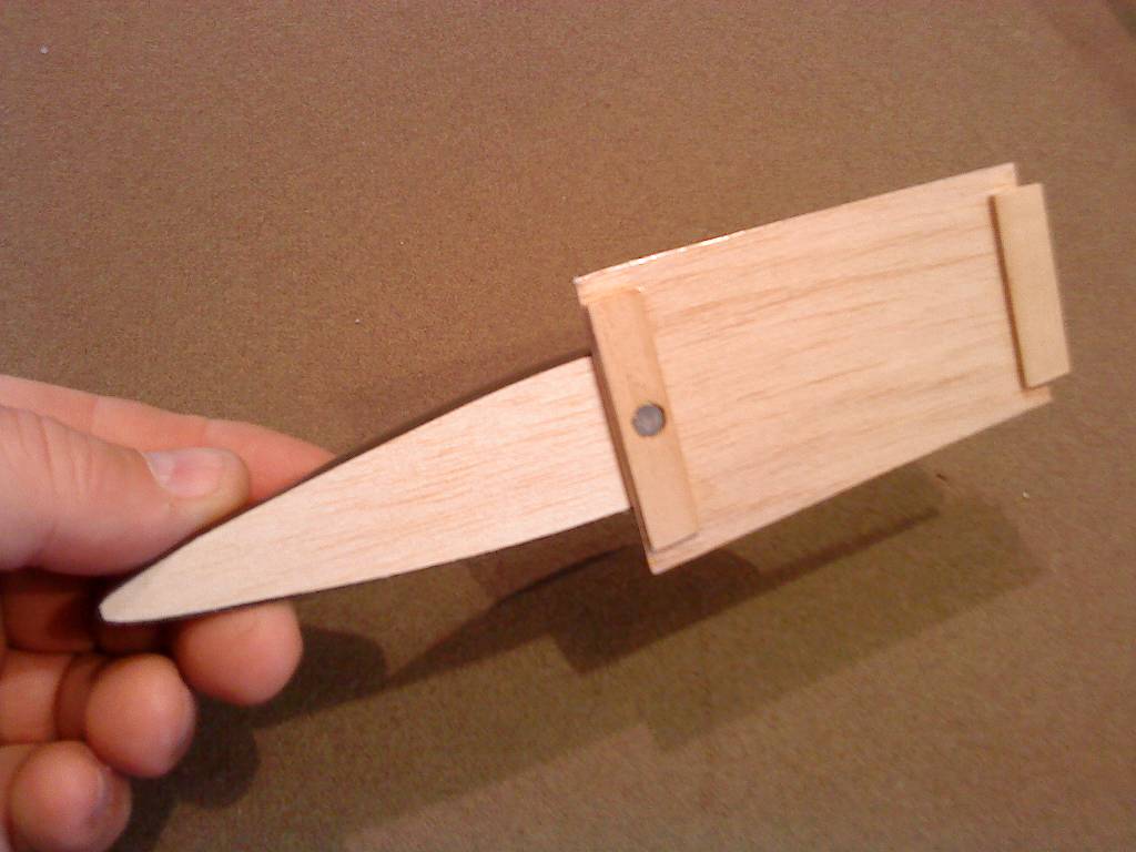

That canopy looks great in the fwd location. A top hatch would be very useful also. I solved my canopy vs. battery hatch problem on a small electric Kaos like this. With a few more magnets maybe something like this would work for you?

I'm sticking with tricycle gear with retracts. The nose wheel may hang below the bottom of the fuse a little, but that won't bother me - much.
