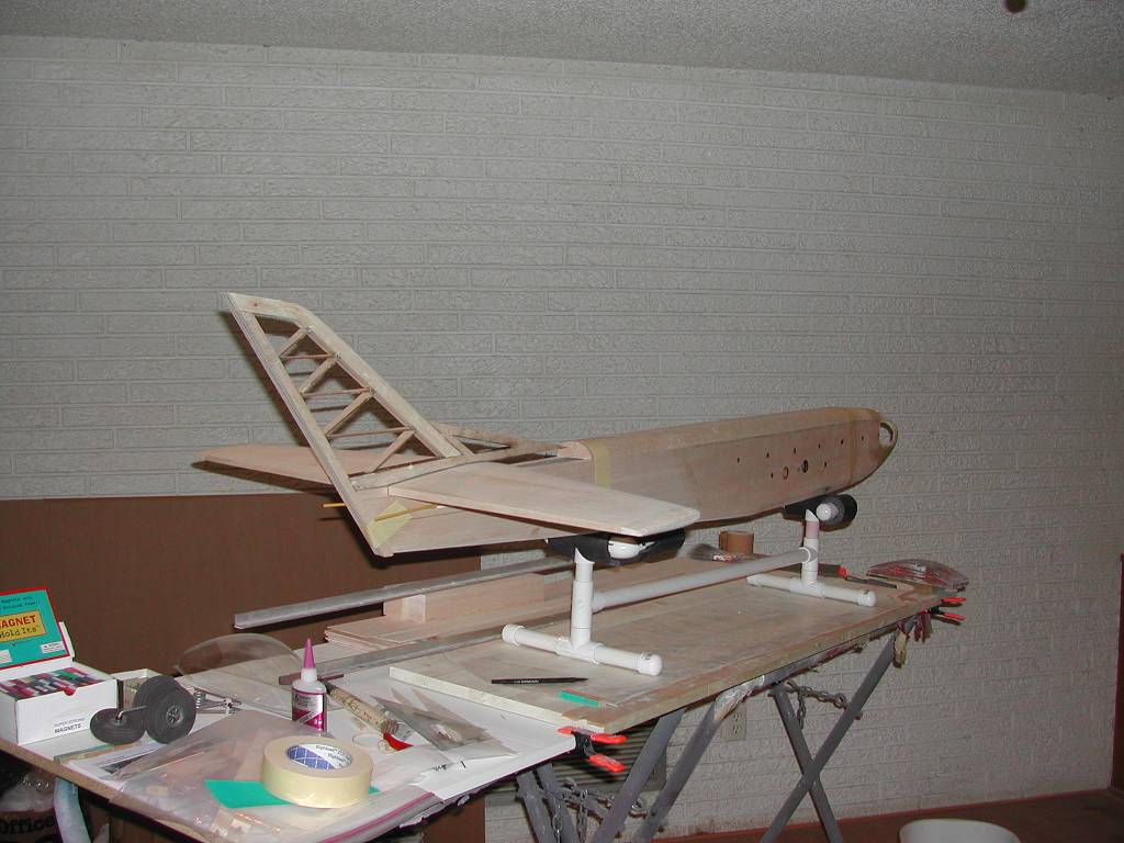

This is an early version of how I did my stab so I would not have any problems cutting the elevator from the stab. Since the ribs have reference lines for the cuts, I sheeted the elevator up to one line and the stab back to the other line, leaving a gap. We'll see what happens when I cut the sections apart.
The stab is now going to wait for the arrival of the 1/4-inch CF rod to implement Bill's idea. I'll start on the fin and rudder while I wait.

Richard, I usually crudely test the rigidity of mystabilizers by grasping them at thetips and giving them a twist. In the case of this stab with the CF tube there was absolutely no discernible flex at all. It seems to be incredibly rigid. Assembled weight without the elevator and before finishing, 5.5 oz.

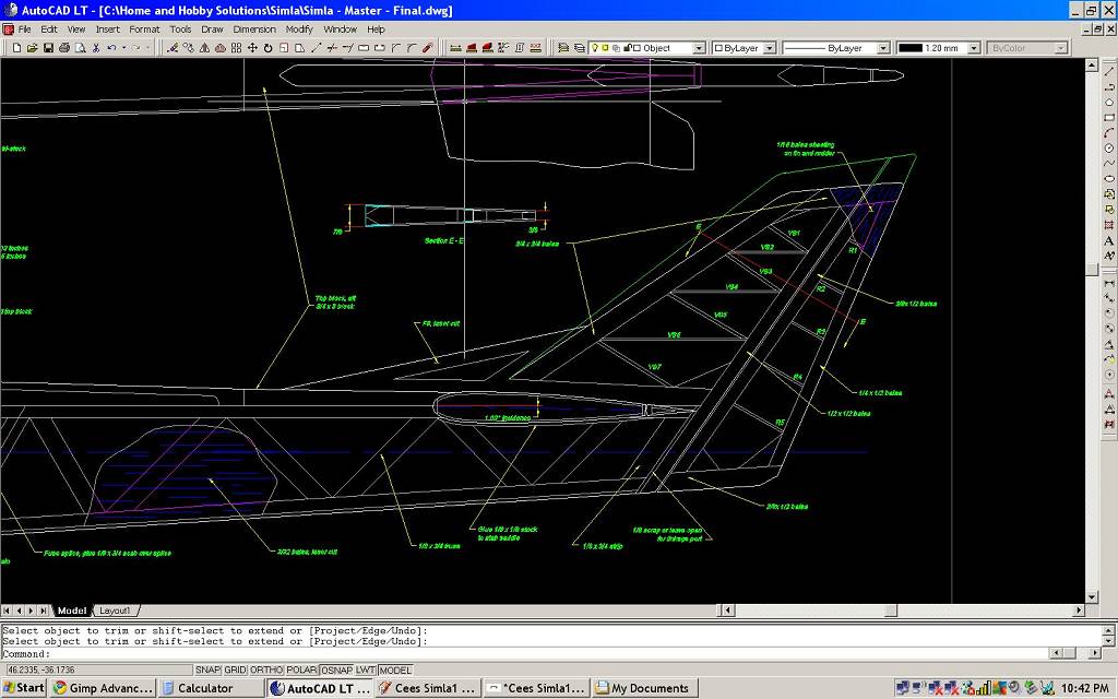

Speaking of the fin, here is Jeff's final revision of the fin compared to the prototype. We decided to change it after carefully looking at the pictures vs the prototype/plans a number of times. Something didn't look quite right. We came to the conclusion the fin should be a bit taller, with an altered fin "rake". As I said, other small revisions were made to the fuse nose section, fuse thickness, to reduce the "tallness" of the fuselage rear section forward of the stab, and to raise the height of the wing about 1/2 inch.
We are happy with the final product, but we would never rule out other changes if they can be proven to be necessary.

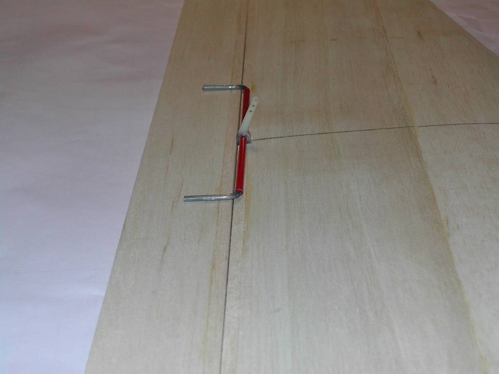

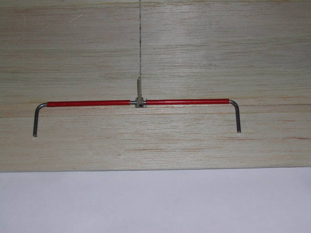

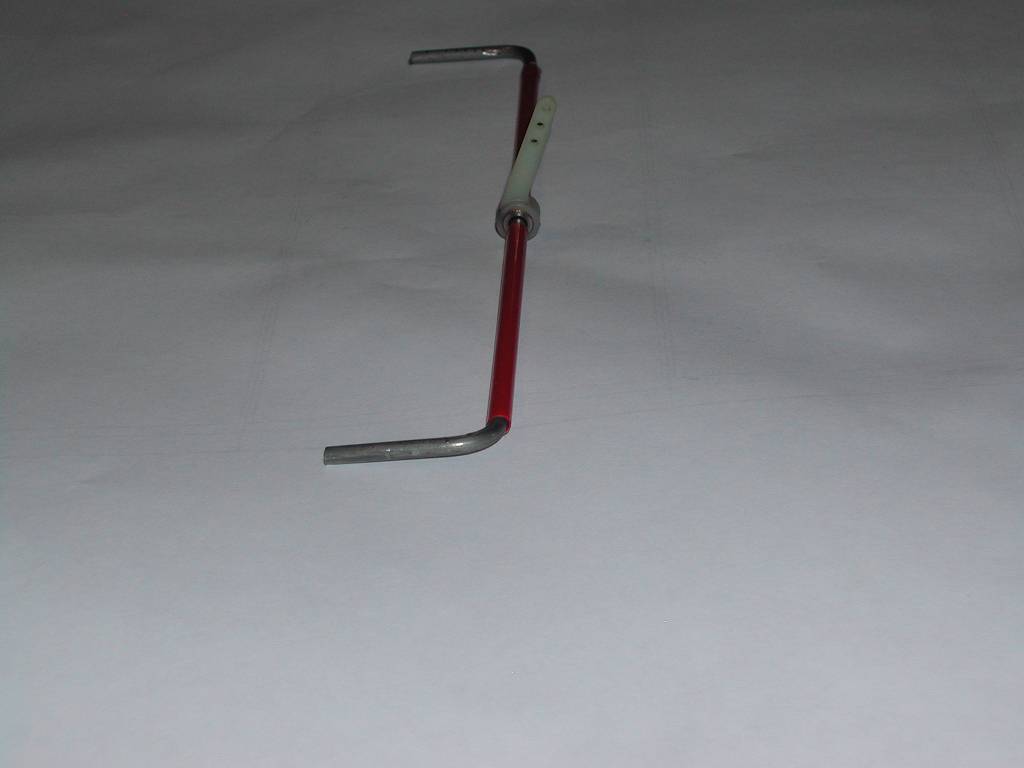

I, too, have been giving thought to the internal elevator mechanism. I was thinking in terms of using some excess 1/4-inch CF rod in place of the hardwood dowel elevator joiner and possibly making a control horn from a few laminations of CF cloth I have. Your arrangement does have a number of pluses, however.Richard
I have a friend who makes CF pushrods. He has told me you need to wrap and crimp the ends with small sections of aluminum tubing to keep the tubes from splitting, or otherwise breaking. He made a couple for me, and I'll post a picture later. You drill the ends for 2/56 or 4/40 fittings depending on the plane size. He personally uses these short external pushrods with the servos mounted on the outside of the plane, (on the fuse wall), for better pattern performance.
These short pushrods reduce the possibility of "play" in the linkages for competition purposes. I'm doing this for my King Altair #4 which had the old nyrod plastic pushrods...(I've learned a few things in the last 5 years), they were braced, but there was still heat expansion "play" within the tubing itself, which eventually introduced rudder "flutter".
The internal elevator pushrod is "elegant". It's neat to see the surfaces moving up and down without an ugly linkage. It is also interesting that Ed kept an OPEN HOLE at the rear fuselage bottom (as described earlier), rather than use a hatch. Even the Taurus kit shows a small hatch held in place with a screw.

Duane, when I built the fuselage I set it up with nyrod push rods for the elevator and rudder, however, since I am going to use the internal method for the elevator I had an extra push rod exiting the fuse aft. Fortunately I set them up as mirror images so they exited at the same point on opposite sides of the fuselage so that I can use them as a push/pull set up for the rudder. Interally the rods are supported every six inches and since I am not likely to compete in any contest, I'm hoping this will serve adequately.

Okay, here's some photos of the elevator control set up. The 5/32" rod just looked too big and heavy so I went down one size. I'm not really sure where the steering armcame from since I've been carrying it around for 36 years, but I suspect something off a smaller tricycled landing geared aircraft will do. I started by bending a 90 degree bend in one end of the rod,measured how much bearing I needed and cut two out of red nyrod sleeve. Then slide one bearing on the rod, followed by the steering arm attached so that when the elevators are in their neutral position the control horn roughly parallels the angle on the trailing edge of the fin. That will give it enough clearence to give at least1" deflection in both up and down directions. I had to notch the trailing edge of the stab for the control horn to fit and have enough clearence. Next, I will notch the elevators to fit around the bearings, drill the holes for the rod to be inserted in the elevators( before I finished sheeting the elevators I added blocks for the rod to slip into). I hope this is clear enough for anyone interested in trying it this way. Oh, I almost forgot, be sure to file a flat spot in the rod for the steering arm set screw and use some sort of locktite on the threads of the set screw. Once all that is accomplished, bend the other end of the rod accordingly, making sure it isin the same plane as the first bend. That should do it.
