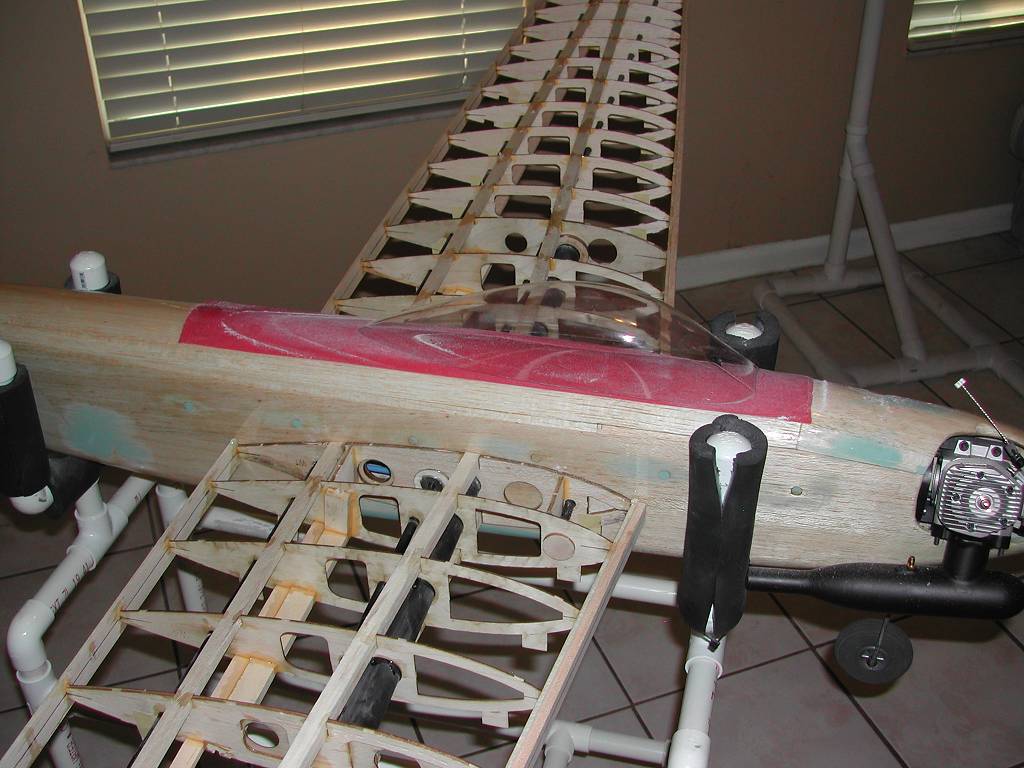

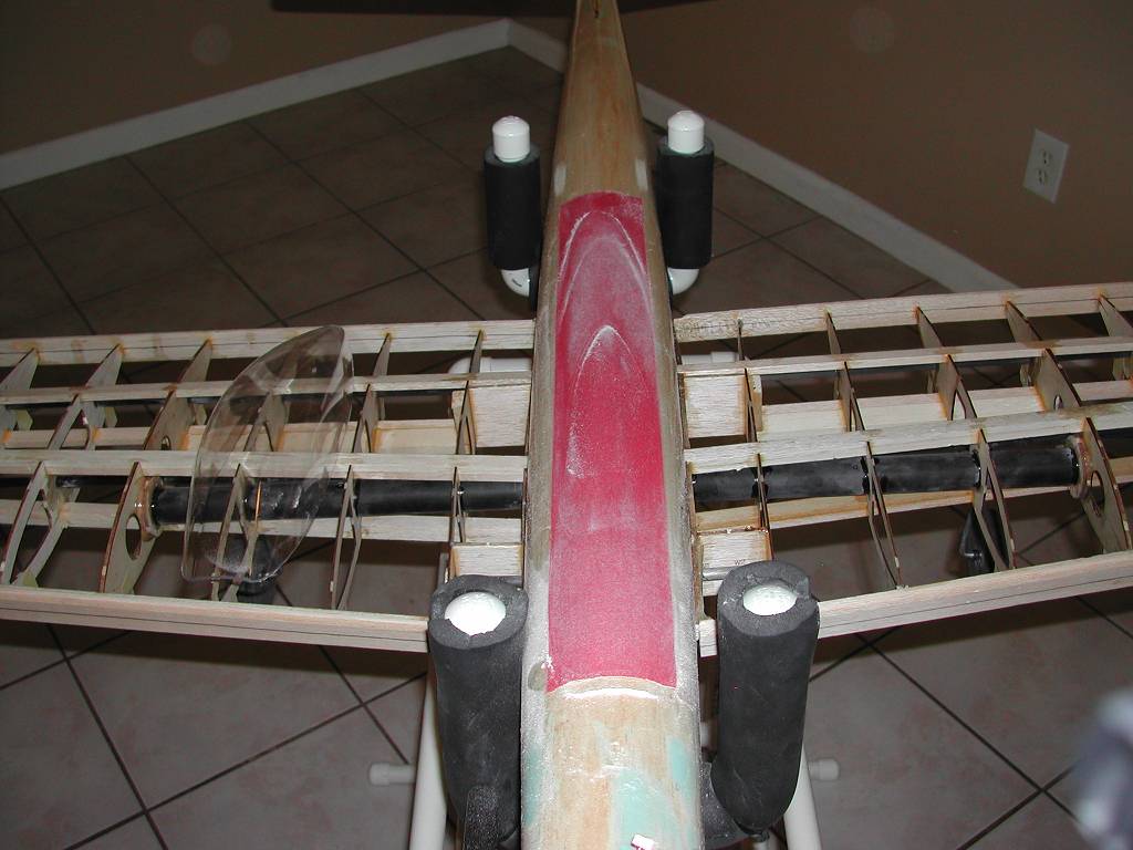

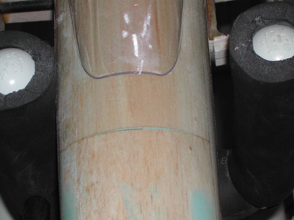

Just a couple photos of fitting the canopy to the fuselage. The red sand paper on top of the fuselage is 180 grit that comes in a three inch wide roll with adhesive backing.

One more thing. Earlier in the thread I saw some discussion of use of carbon veil. I have used the veil between the foam wing and the 1/16 balsa sheeting but have not used it for any other application. I couldn't find it but I think that there was also some discussion about the application media (PPG urethane I think) was not hardening. I have tried many different types of media to apply glass cloth to airplanes and after evaluating different brands of stuff, I have settled (been using it for the past 10 years) on System 3 brands (www.systemthree.com) epoxy. If you go to their website you will see different types of epoxies. They have the run of the mill epoxy ( they call this epoxy resin) which many use to glue things together, they have their structural epoxy (called T-88) and then they have an epoxy called Clear Coat. I use the T-88 for glueing firewalls and other pieces that are very structural in nature in the plane. I use the general epoxy for stuff like glueing the wing tubes into the fuse and other items that do not have as much stress applied on them. I use the Clear Coat to apply my glass cloth. The Clear coat is very light (thin) viscosity (something like the viscosity of Aero Gloss clear dope). If flows very well. If you are going to glass an airplane the first thing to do is to try to seal the wood so that little of the epoxy is soaked up by the wood. What I (and others) do is to put two or three coats of Balsatire or clear dope on the wood (sanding between coats). In my last plane, three coats of Balsa rite to the fuse (the fuse has a total area of about 800 square inches (this is total for both sides of the fuse) I added about 18 grams (about 2/3 ounce)) to the weight of the entire fuse. Once this is done, I then lay the cloth down, apply the clear coat expoy. Once the cloth is wettted out completely, I take an old credit card (need to have rounded corners and very smooth edges) and squegee most of the epoxy off. When you do this, you are looking to have the cloth all have the same color. Any light areas will be a lighter color than the cloth that is wetted out. Put the expoy where it is needed to wet the cloth out. I typically use very little epoxy to wet the cloth out. Although I dont recall the exact amounts, I believe that for the wings for my latest pattern plane I mixed about 28 grams of epoxy. I used this to cover the top (for example) of one wing panel (approximately 475 square inches). ONce the cloth was wetted out, I squegged more than half of the epoxy off. The current target wieght for a 475 square inch wing panel (sheeted, with wing tube sleeve, glassed, painted and with servo and control horns installed is about 14 ounces .
If you are looking for a source for very good glass cloth, try: www.thayercraft.com. They sell good quality glass cloth for very good prices. I recently ordered 25 yards of 1/2 oz cloth that is 22" wide and I got it for $27 (shipped). I also ordered 50 yards of 3/4 ounce cloth that is 44" wide for about $65 (shipped). The current trend on glassing pattern planes is to use the 3/4 cloth. It seems to be a little tighter weave than the 1/2 ounce and consequently it seems to absorb less epoxy.
Just my 2 cents.
Ed
#300
Ed,
Yet another very informative post. Many thanks.
I'm the one planning on using the carbon veil instead of glass. I read about its use on, I believe, a CL plane, and again more recently where it was described as being light and offering a bit more ding prevention. I've got some .3 oz. that should be arriving today from ACP.
For sheeting foam cores and applying glass, I've been happily using West Systems products. As you advise, wet out the cloth and then squeegee like the dickens.
This time, just to be different, I plan to try Bill's 2-part urethane method. Thanks to you mentioning the possible problem of the PPG (not the brand I bought) urethane not hardening, I will do a test. Besides, I need to find out if Ultracote will work over the carbon veil and urethane. Since my field is at 7,000 feet, I want to use the Ultracote to save some weight. If it doesn't work over the veil, I'll find someone who knows how to paint. I've never done it and don't have any equipment.
Cheers,
Richard
Cheers,
Richard
