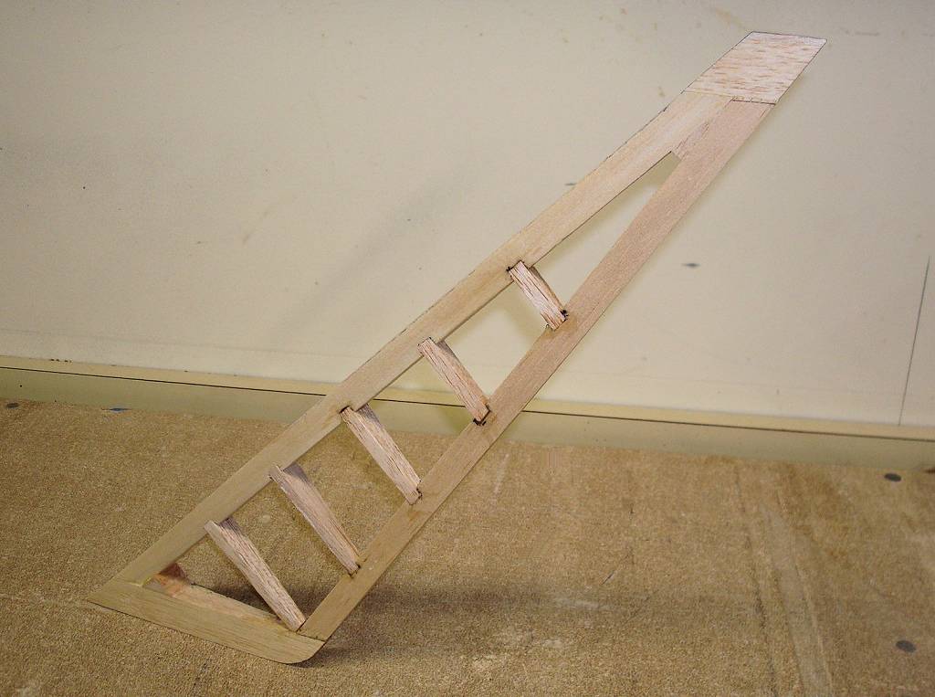

ORIGINAL: billberry189
Built the fin frame this morning. Pretty straight forward stuff, but it did help me to mark center lines on the inside and outside of the fin leading and trailing edges as well as the ribs. Line up the center lines and fast CA gave me a frame in just twenty minutes.
To me, the fin, (and especially the rudder), is a little tricky becase at the base the finished, sheeted fin is 3/4" wide, and at the top, (tip), it is 1/2" or less depending on taste. You have to shape the fin from bottom to top, and curve it from front to back to give it a Kaz-like airfoil shape. Ed didn't build it as a 3/4" simple slab. You can see Ed's looks relatively slender at the top, and rounded/tapered at the leading edge.
Rather than just sheeting the structure, you may wish to shape the fin as described above, and taper the truss in the building process, because the sheeted structure can be sanded only so much. I am just describing what I did, (for better or worse). I wanted my fin truss pieces to support the sheeting...that's why I tapered each piece. Notice the oblique view...you can see the tapering. Once one side is shaped and sheeted, you can flip it over and shape the other side some before sheeting.
The built-up rudder in particular, (which is much thinner than the fin except at the L.E., and tapers to a point), requires that you block-up the T.E. 1/4" when building. At least that's the way I did it. I actually cut little notches in the rudder truss, (also tapered), for a little more strength, and added some wood at the bottom to handle the eventual rudder control horn.

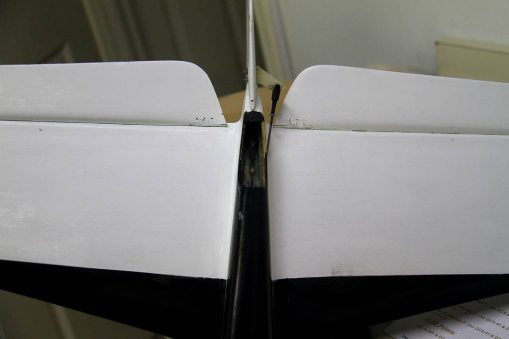

One more thing I'd like to share with you today. This is something that hasn't been discussed ANYWHERE in connection with the Simla, but is common to ALL of Ed's planes that we know of. We never even thought of discussing it during development of the plans and building the prototypes. It has to do with Ed's method of handling the elevator pushrod WITHIN THE PLANE, and not using an external elevator pushrod. I carefully looked at every picture of the Simla, and to the best of my knowledge, I have NEVER seen any evidence of an external elevator pushrod.
If you look at Ed's Taurus, the Taurus II, and the "Unfinished Fuselage", they are all done the same way...with a small, uncovered HOLE at the tail that accesses a home-made dual-pronged elevator "horn", (see photos). The elevator horn is similar to the tradional way of doing aileron horns for strip ailerons back in the day.
We used the, (to us), "traditional" external elevator horns and split pushrods...but in fact, it is much more likely Ed used an INTERNAL pushrod accessed with a screwdriver from below. This method is actually very "cool" looking, because all you see are the elevators going up and down "like a real plane". Somebody should try it if they are handy with piano wire with a small plate soldered to it, (WELL).
In the pictures of Ed's original Taurus II, and the Unfinished fuselage all primed for painting, notice the ORIGINAL Kaz linkage and soldering. In both the Taurus II and the "Unfinished", the wire elevator linkage is sewn in place in the traditional way back in the early 60s. The white "Unfinished" fuselage looks pristeen in comparison...already to go, but never finished. As I said, ALL of these planes were finished the same way, and I have every reason to believe the original Simla had the "hidden" elevator linkages as well.

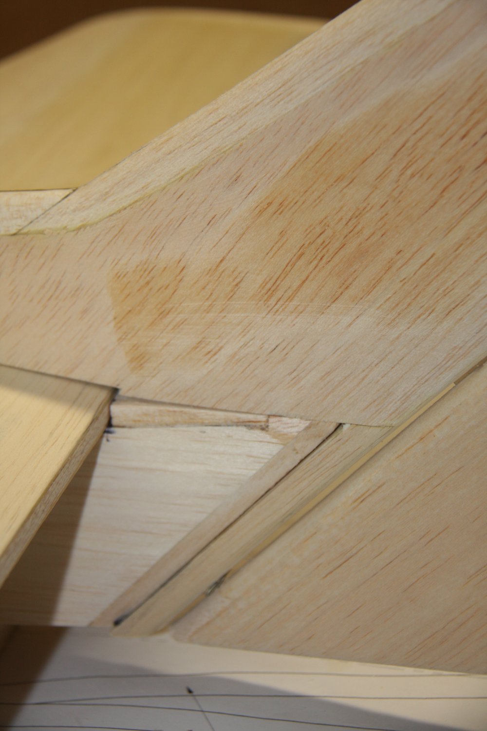

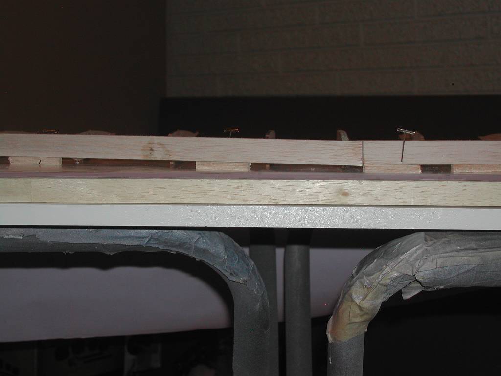

I would like to offer a thought about building the stab and elevator as one piece and then cutting off the elevator.
I was concerned about how I was going to make two perfectly straight and vertical cuts, as described in the instructions. This is what I did:
- Sheeted the elevator area up to the cut mark on the TE of the rib.
- Sheeted the stab area starting from the forward cut mark on the rib.
This has left the correct width unsheeted area, which will be easy to cut and sand before applying the stab TE and the elevator LE.
I'd like to add a few "lessons learned" about building the stab. (Images coming.)
1. To conform to the 3/32 sheeting, I believe there is supposed to be at least 3/32-inch available from the top and bottom of each rib LE to the top/bottom of the LE strip. This doesn't happen with rib 2 from the kit. It will need to have its contour sanded to shape *before* gluing on the LE strip. (I didn't notice this until after I had glued the strip.)
2. Make a template for the sheeting. I free-handed the top sheeting and it was a pain.
3. If you use Jeff's revised method that has the grain of the sheeting at the LE parallel to the LE, fit and glue that first. On the top sheeting, I started with the straight sheet across the TE area. This meant a lot of fiddling to fit the front sheeting between the LE and the sheet already at the back.
4. The curve of the ribs at the LE is quite pronounced and makes it awkward to fit and glue the sheeting. I *think* that *lightly* spraying the top with Windex will permit an easier bend. I also *think* that it might be easier to fit and glue the leading edge of the sheet to the leading edge strip and the very front portions of the ribs, let the adhesive dry/cure, and *then* bend and glue the remainder of the sheet into position. I'm going to see how this works on the bottom sheeting.
5. I like Bill's method of replacing the temporary aligning steel rod with a carbon fiber rod glued into place. That should add lots of rigidity with minimal weight.
Actually, if I were to build the stab again, I would be very tempted to fit and glue the LE sheeting *before* attaching the LE strip. Not sure it would work, but I think it would be worth trying.
