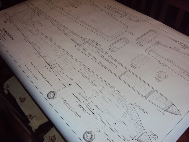

Building a Tiporare .40
<p class="MsoNormal" style="margin-bottom: 0.0001pt; background-image: initial; background-attachment: initial; background-origin: initial; background-clip: initial; background-color: white; background-position: initial initial; background-repeat: initial initial; "><span lang="EN-US" style="font-size:7.0pt;font-family:"Arial","sans-serif";mso-fareast-font-family:"Times New Roman";mso-ansi-language:EN-US;mso-fareast-language:ES-AR">Hi, I´m going to build a Tiporare .40 from Doxilia´s set of plans.
Engine will be an old O.S. .40FS.
The goal is to build it with retracts, as light as possible and with material that I´ve in my workshop.<o

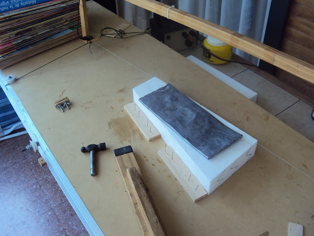

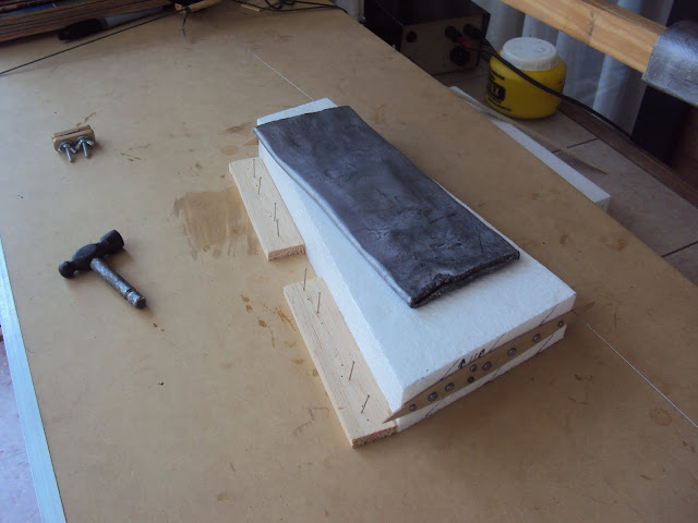

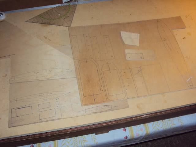

Making the templates:<div>

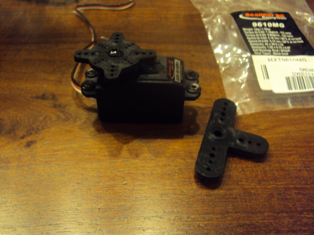

In order to save weight and problems regarding space for retracts have you considered the use of servo less retracts ?
e.g. hobbyking offer some servo less retracts at a very good price, I would consider this if I were you.

</div><div></div><div>And this is the retract servo:</div><div></div><div>

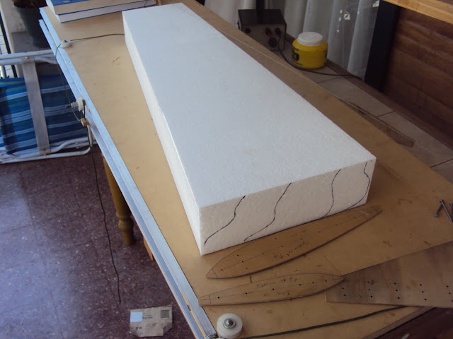

Cutting the wing and stabilizer foam cores:<div></div><div>
