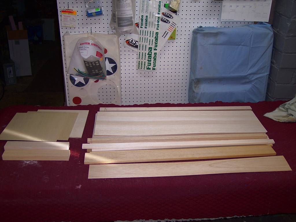

Here is the kit from RCAIIR. I just received the wood for it today. I'm going w/ 10x36x1/16" wingskins. Power will be from a Rossi w/ Mac black pipe. It will be a tri-gear using e-flight electrics. I hope to start this during the holiday shutdown. The T2A is done and flying, the Deception is ready for graphics I'll make and then clear coat in the Spring. It is building season here in NE Ohio but is sure doesn't feel or look like it YET!

Yes I got your PM. Thank you very much. The 2" anhedral sure looks funny to the 4-1/4" for the Tiporares.
The wood called out on the plans (9/16 stock), I couldn't get it from Balsa USA. So, I went w/ 1/2" stock. I'll just trim the cores to adjust the difference.

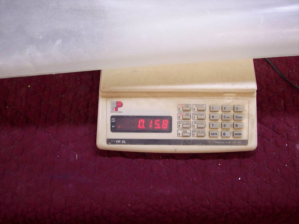

I am addressing some minor issues with the fuselage. I looks like it didn't pull out cleanly from the molds. I am filling in some chips from the sharp edges and fillet. I am also hitting the seam line while I'm at it. The green Bondo has fiberglass in it to fill and build strenth. I will use the light blue filler for the pinholes. I figure now is the time to hit most of them while nothing is attached to beat up later.

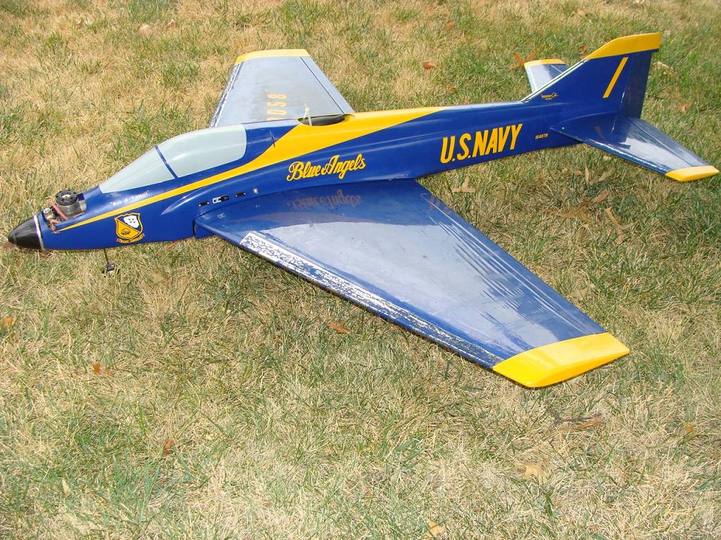

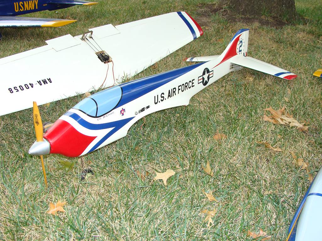

Paint schemes, some eighties jewels here from an estate sale in Kansas City summer before last. Curare in Thunderbirds and EU-1A in Blue Angels paint.
Chris...

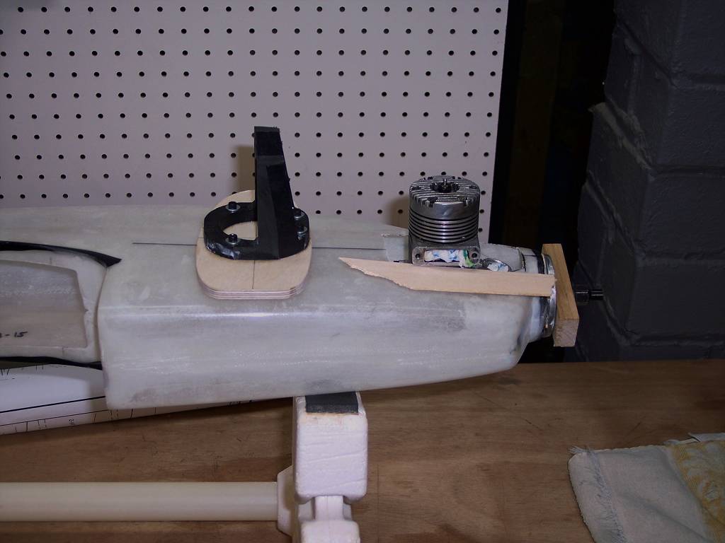

The tail post and fin are in place. The engine/mount setup is done and ready for glassing to the fuselage. The engine is setup less the 90 degrees but not the 80 degrees called for in the plans. I didn't want to make a big cut out for the carb and ruin the look of the nose.
This will be a good spot to stop until the weekend. We have a big push at work before shutdown. Ho Ho Ho

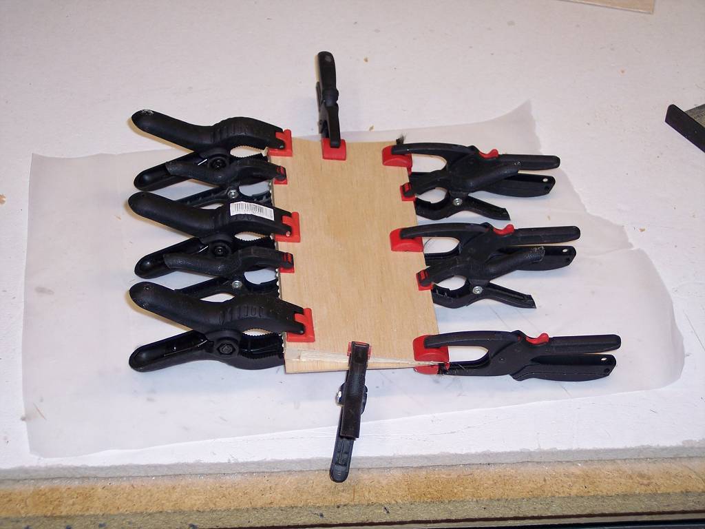

Well, I have the firewall and wing hold downs installed and ready to install the tank floor and nose gear. I also have the rudder built as I was getting tired of messing w/ fiberglass.
I will load pics as soon as the server lets me[:@]

We have pics. You can never have enough clamps
