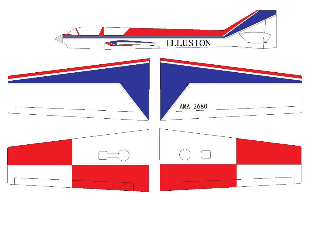

can you do a drawing with the pee green changed to red... ?

Here you go Scott. The camo is only a what if. I even thought of the old Cicus Circus paint scheme. I have painted or covered so many red, white and blue birds.

The camo is cool!

The red,white,blue looks sweet.

I think the camo is cool also, maybe a few well placed markings and the bottom white and it would look the part!

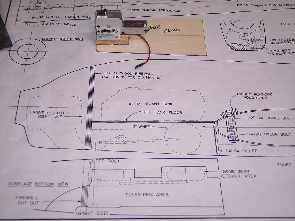

The rudder is now done minus the 1/4" dowel for the pull-pull system. The tank floor is ready to go in after adding blind nuts for the gear. There is plenty of room for the tank compaired to my H9 Phoenix 7. I may slide the tank floor up a bit to eliminate the little bend in the gear.

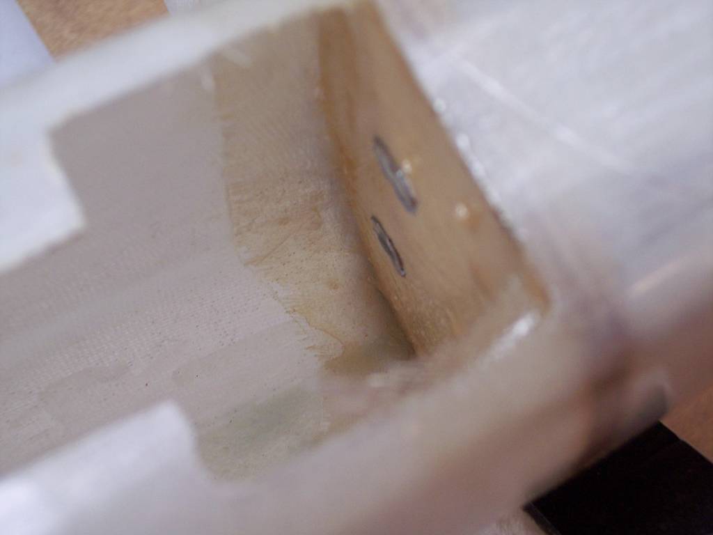

Firewall is now glassed from behind and tank floor ready for install.

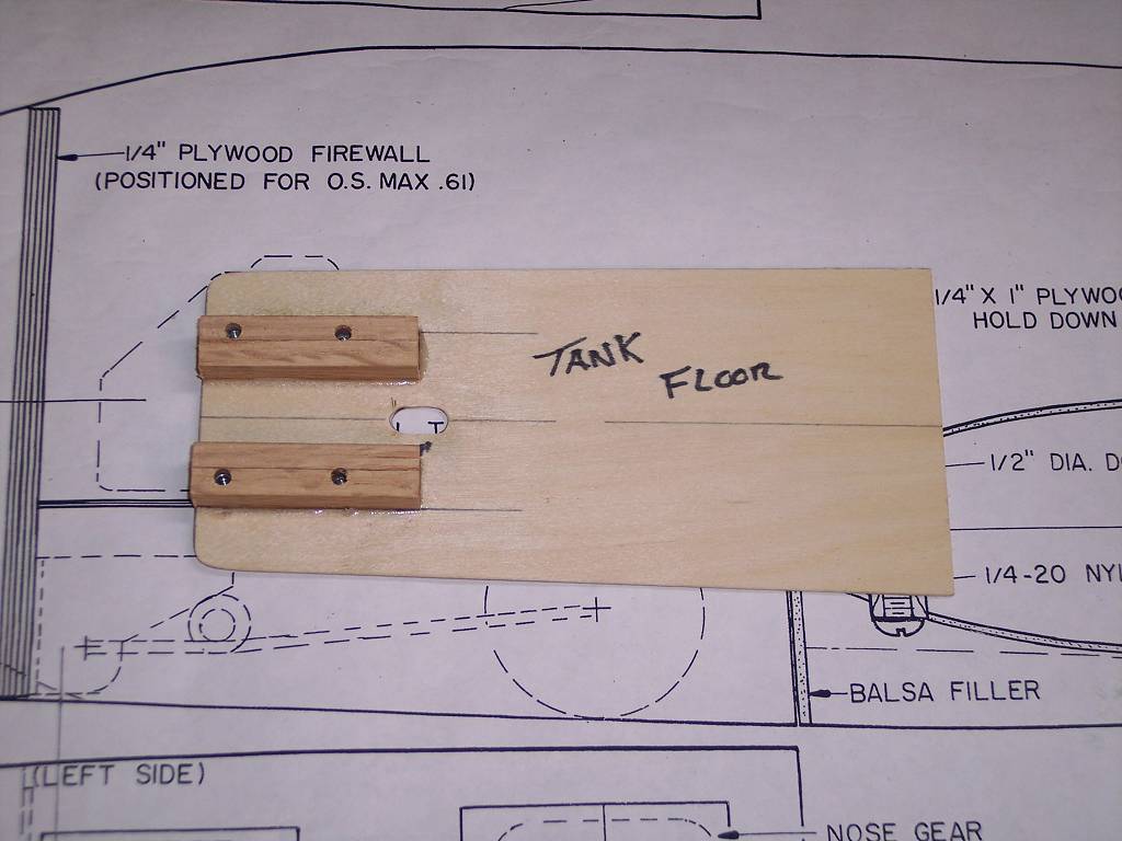

The tank floor is in and ready to be glassed in after the filling epoxy sets. I did move up the tank floor 1/4" from the print.

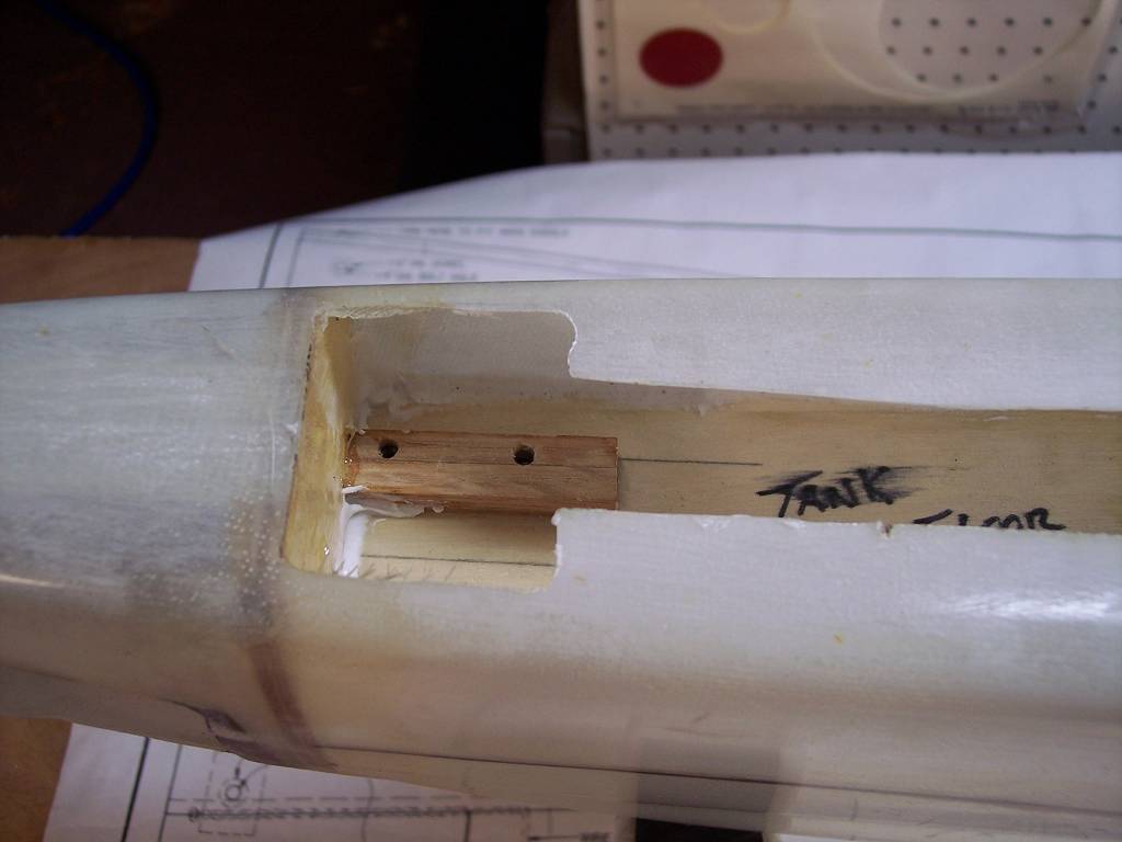

The nose gear is set. I did lengthen it a 1/4" and will do the same for the mains. We have a great, well manacured grass field. 99.9% of the time

The engine/muffler cutout are finalized. Now the fun part starts, WINGS/STAB

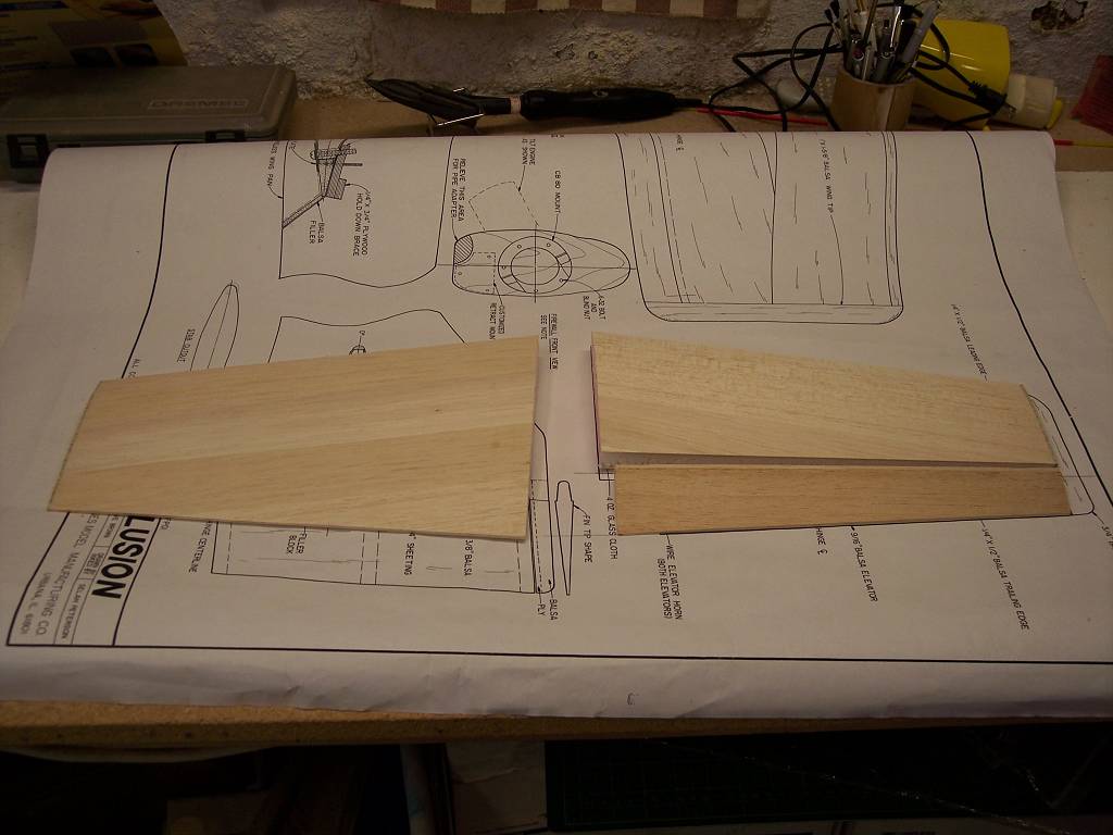

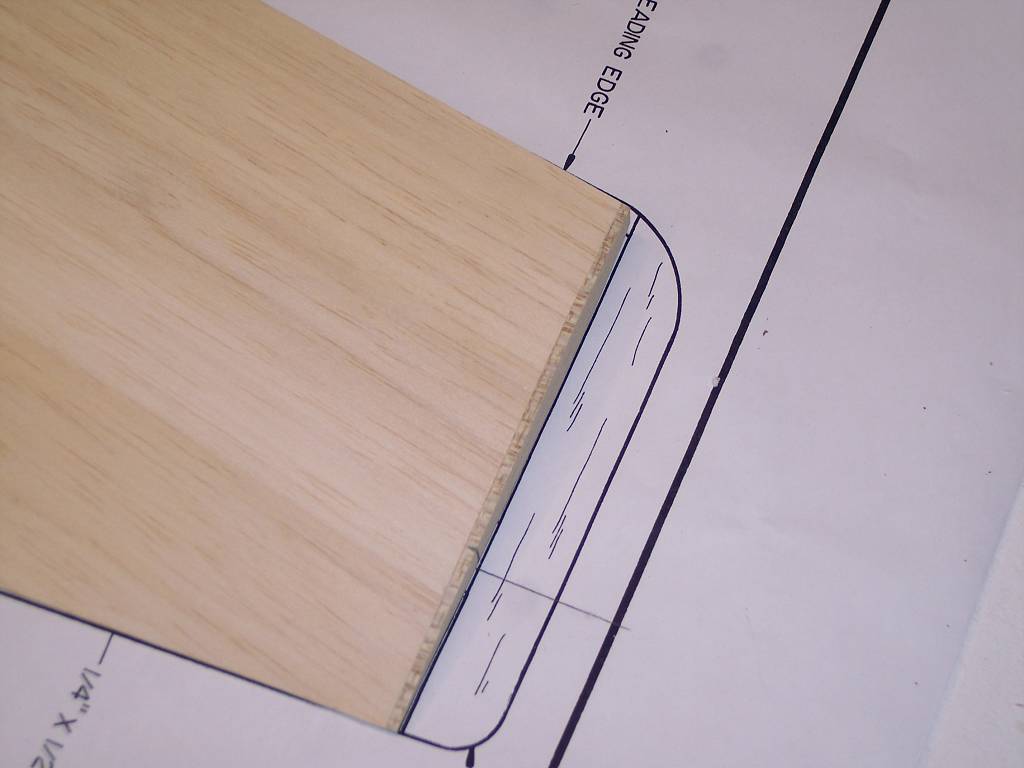

I had a minor problem as the cores were cut askew. I trued up both the root and tip. I then added 3/32" to fit it to the print. It took longer for the glue to dry than fixing it. I cut out for solid elevators. I didn't have much to glue my hinge points to. The stab is ready for joining and the anhedral sanded in at the root roughly 2 degrees per side. This gave me the 2" called for at the tip.
The wing are also sheeted. I have added some Cf horse hair to the TE hoping to help w/ the dings[:@]

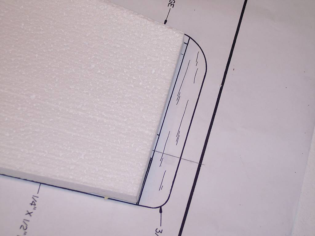

The wing cores are trimed and sized. This is a good place to stop until Thursday. ( that pesky work thing is starting up again[:@])
