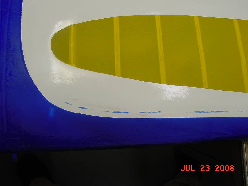

Awww dang it....Your not going to like me for this...Sorry..
My experience:
Your going to need to seal that "blue section" otherwise your feathered paint lines will show through...Even though you have done a nice job of feathering with 400g paper I fear that you will see the lines...You'll probably have some shade differences too (especially since your paint is sooo transparent)...
I'd recommend masking off and shooting a coat of epoxy primer over your "blue area"...Let it cure and give it a nice sand job but try not to bust through...If you do bust through then re-spray...
I didn't catch what brand of epoxy primer you're using but that should be perfect for this task...You could use that straight out as a primer...Or if it's an automotive epoxy primer such as PPG DP series you have an option to reduce it more and use it as a sealer...Never the less follow the directions on the can...If it does not specifically call out instructions for additional reduction as a sealer do not modify the paint...(The only advantage to a "sealer" is it would be a thinner layer of paint)
Whatever..Don't get discouraged!! She is looking great and you'll get her straight...

Default RE: PassTime Perigee Build thread
Thanks for the input. The new blue paint I am using is very opaque, it will not bleed through (check the photo in post #256). I can live with a little feathered image, I just want to get this done!
So last night I sanded the wing panel to remove the ridges for when I re-paint. Not so lucky this time around, went through the white in a few spots. Not to worry, it is easy to re-shoot just that area. All I have to do is mask off the yellow center panel.

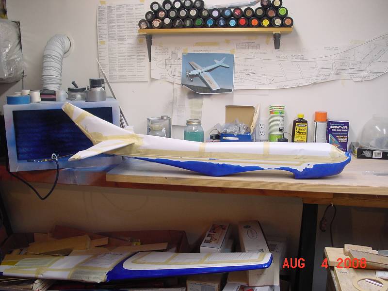

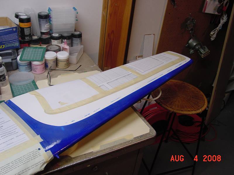

Old 08-04-2008 | 07:50 PM
  #280
WEDJ's Avatar
Joined: Feb 2007
Posts: 1,739
From: Stockton Springs, ME
I have no excuse, I just have a case of jitters to do this right. So then I talked to myself and said "well, c'mon, you've taped and painted dozens of planes, why are you chicken about this one?"
It boils down to having been bitten a couple of times already, I am reluctant to risk F#$%ing it up again. Well, it's showtime, gotta move on, risk or not. So I have masked things off tonight, and will spray tomorrow. Wing needs white, and I will use the white to seal the masking of the fuse, too. Here's some progress photos.

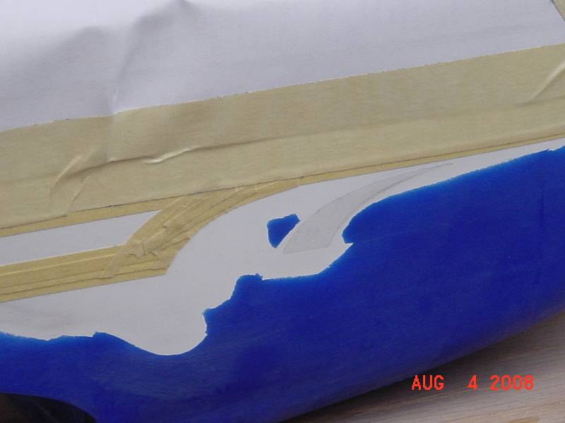

Well, we painted tonight. SUCCESS! Well, relative to the last time I painted the blue, anyway.
First, the white on the wing and background for the body:
So on to the blue. Not a perfect job, but acceptable when you will see it at 85 mph in the air.

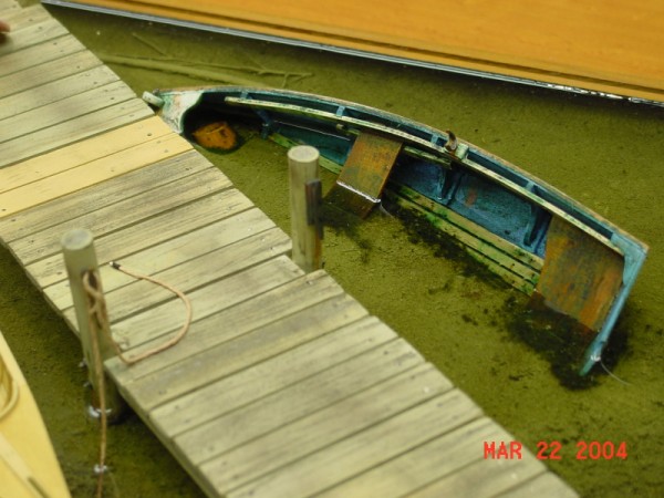

Report from the IPMS convention:
My Canoe diorama got 2nd place in ships.
I scored the right size US flag for the Perigee body sides.

Old 08-13-2008 | 01:33 PM
  #289
My Feedback: (28)
Joined: Oct 2007
Posts: 407
From: Saratoga Springs, UT
Awesome modelling- congratulations! IPMS Nats are for the best of the best. Now if you came out of the vendor area with only a couple flag decals, that would be unbelievable. I've come out of there so broke I couldn't pay attention!
Old 08-13-2008 | 02:01 PM
  #290
stuntflyr's Avatar
Joined: Oct 2007
Posts: 1,891
From: Tucson, Arizona
Oh for sure he bought more! Like Dave, I too have an eye out for water slide American flag decals wherever I go.
The diorama is awesome, what did you use for water? It's beautiful... I'm jealous. My stuff only looks good from five feet!
Chris...
Old 08-13-2008 | 04:02 PM
  #291
WEDJ's Avatar
Joined: Feb 2007
Posts: 1,739
The water is Envirotex Lite Epoxy - took 3 quarts of it!

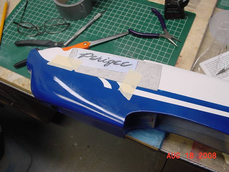

Well, I passed up taping the wing for this - the final body details. Much more gratifying, I can assure you! Let's start with the REAL Perigee lettering, which I took from the original photo, then stretched, skewed and reduced it for scale. Put it on the body and put carbon paper under it.
