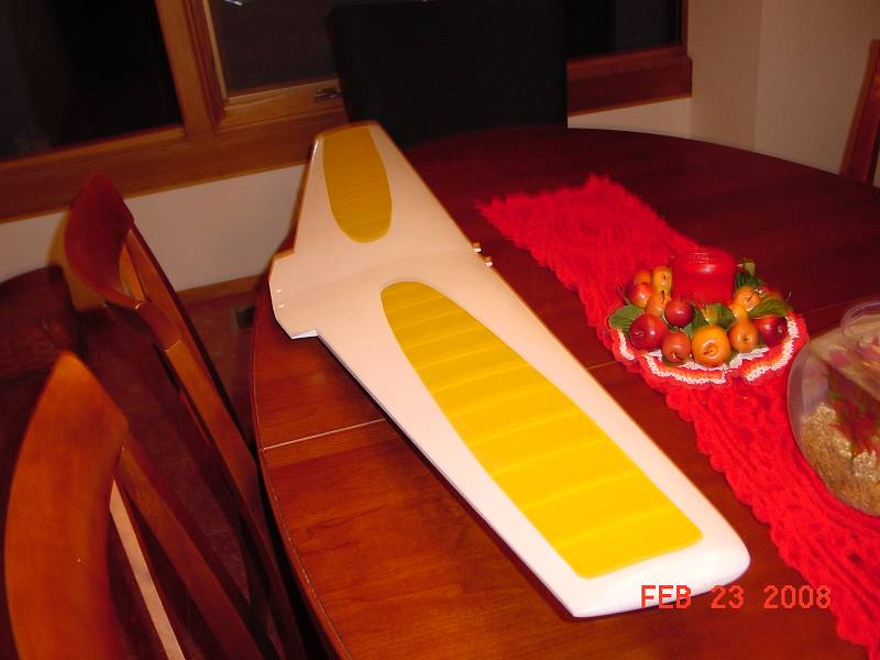

so, after finishing the wing covering, there was this little problem, the overlap of the fabric covering.
No problem, just paint a little primer on the overlaps and sand down, right? That's what I thought. In reality, the primer went on OK, but when I sanded it, the solartex finish was scuffed up. Then I painted it, and the damage was visible because of the nice shiny epoxy finish. At first look, it is fine, but I will have to re-finish spots with 400 wet and then re-spray. No big deal.

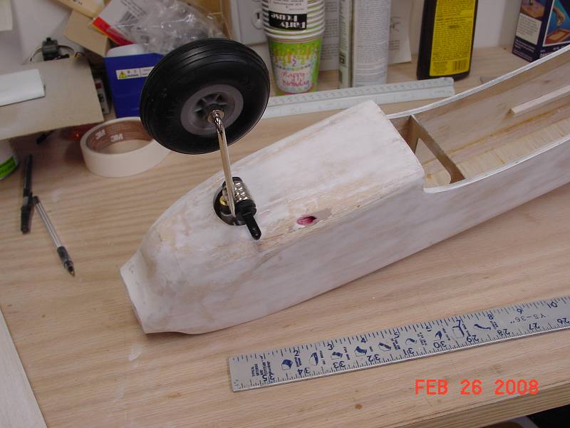

This part of a build always bogs down for me. So much detail, so little worth sharing on a build thread. OK, here's a shot of the install of the nose gear steering. Not much I can say, it is really very basic. Cut a slot, CA the nyrod outer, fill in the blanks with Epoxolite, sand smooth. Any questions?

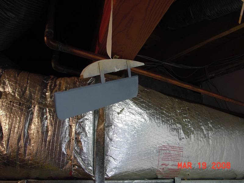

This may be old hat to some, but if I can help a newbie, I'm glad.
Problem: How to paint both sides of a control surface and still be able to hold it?
Answer: Use the hinge slots. stuff a length of 1/32 ply, then CA to scrap wood handle. Photo kinda shows it all.

I do that, only I use hinge points, so I put a 1/8" dowel in the holes I drill in the plane to hold it and glue the dowel to a 2x4 with CA to hold them in place while I am painting it. Put a dowel in the fin with a bigger chunck of wood in the nose and you can paint the fuse and just roll it around while painting. Works great. Take a peice of wood and make a V notch in it on both ends the size of the dowel and you have a very stronge support for painting. You can paint the whole fuse in one go like that.

So here's the proof, hanging up to dry.
