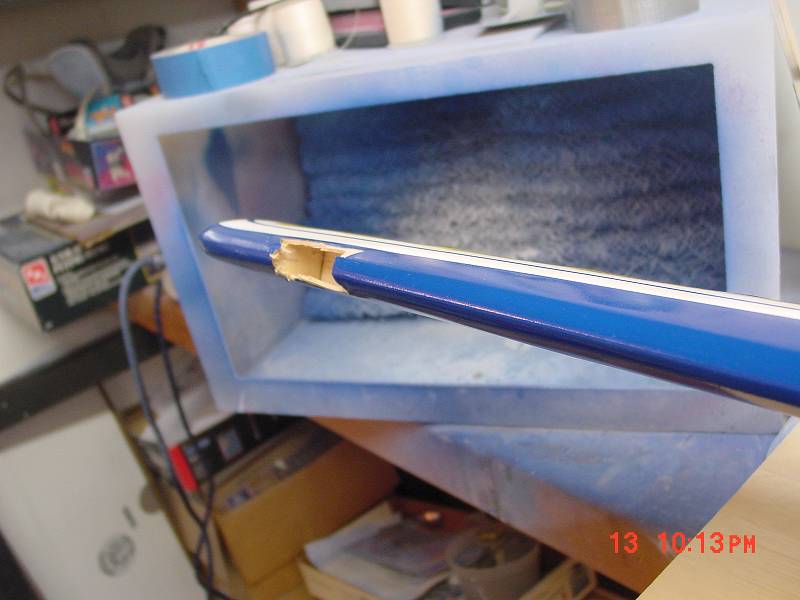

OK, so after building and flying, what comes next?
REPAIRING!
Oh, God, I hate this part.............
So, for some background, I had a small mis-hap at the Octoberfest VR/CS meet this past w/e. Some my fault, some the other guy. Net result, a bad gash into the wing LE. At the field, some good samaritan gave me some clear plastic tape to prevent wind erosion while I flew the events.

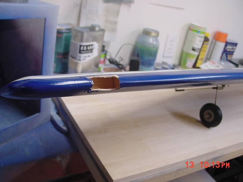

So now we cut into the damaged area. lucky, no ribs were damaged, it is all contained between them. This makes the repair easy. I will cut out the damaged area smoothly, then insert a block, sand down and re-paint. piece of cake.

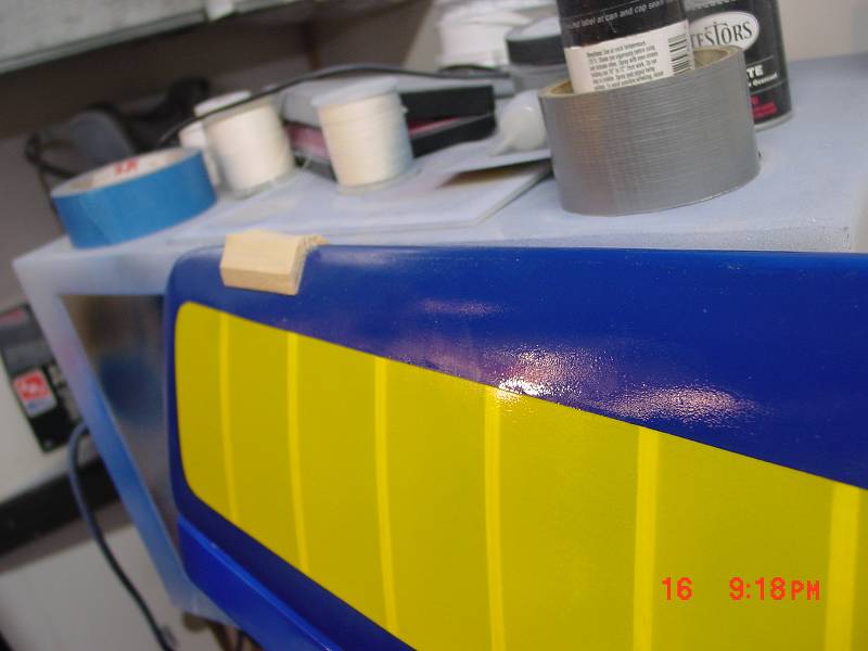

Next step is to get a big light balsa block and trim it to fit the opening

rough trim the block, and then epoxy it into the opening. That's all for tonight, next step is to shave/sand it to the airfoil shape tomorrow.
