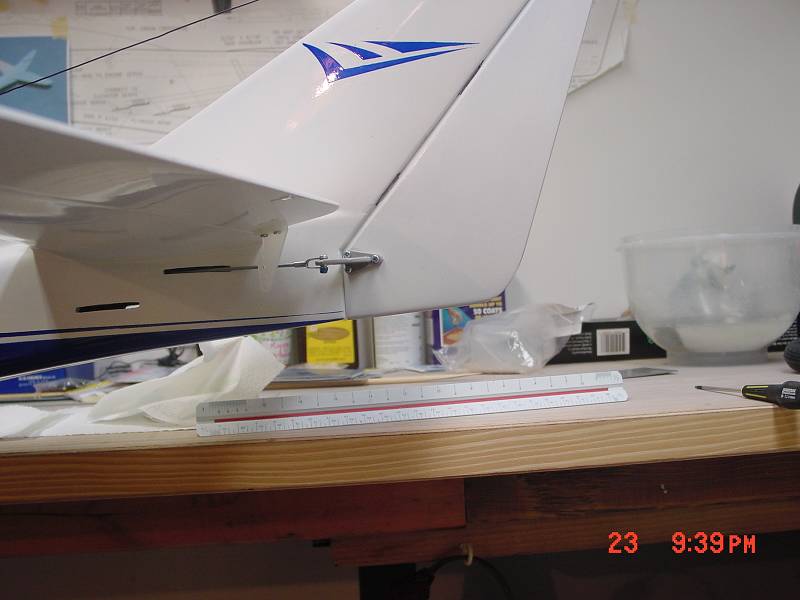

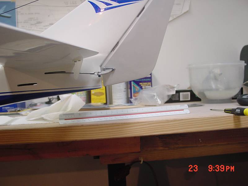

Last item tonight is the rudder linkage. Because of the extreme angle and where the control horn has to go, I used a horn that reaches forward. It also has a ball jpoint, which you will see is useful. Here's photos of how it works. Remember, if I used a regular horn there, it would have caused severe differential from left to right.

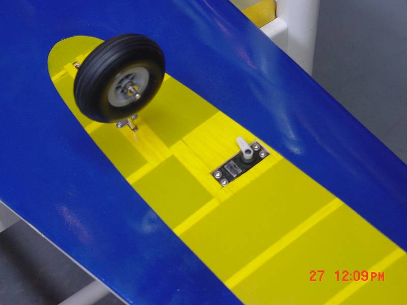

Some things actually do go smoothly. Like the mains and the aileron servos.

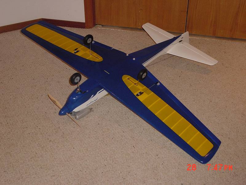

Photos as promised
