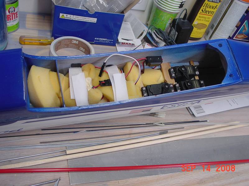

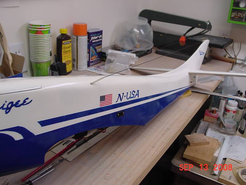

I am determined to get this done and flying!
Today so far I have installed the on/off switch, antenna guide (also note button strain relief), plugged in the Rx, got all the servos going in the correct direction, trimmed the servo arms, and RTV'd the velcro straps to hold the Rx/Battery, and strung the antenna to a "T" pin on the rudder.
ID:	1032434   Click image for larger version

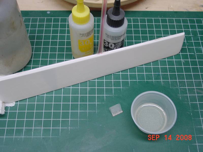

Next - install hinges. I use a straw to blow epoxy deep into the hinge slot. Works good. Make sure the acutal hinge line is exactly on the "V" of the control surface. Notice the hinge slot has a recess to accomodate the hinge line.

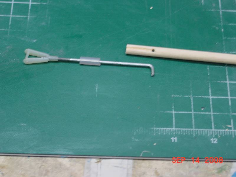

Now to do pushrods - old style. In all the years I have been flying, this method has never failed. First, cut your clevis & rod to a convenient length, don't forget the fuel-line keeper. Make sure the clevis is centered in the threads, that gives you the most adjustments in either direction. Using a 1/4" dowel, drill a hole and cut a notch for the metal rod.
Old 09-14-2008 | 11:38 AM
  #332
WEDJ's Avatar
Joined: Feb 2007
Posts: 1,739
From: Stockton Springs, ME
Default RE: PassTime Perigee Build thread
Then, bind the two together tightly with button thread. simple knot at the rear, several overlapping wraps at the front, then a clove hitch on the rod. Smear liberally with epoxy, and it is done.
ID:	1033127   Click image for larger version

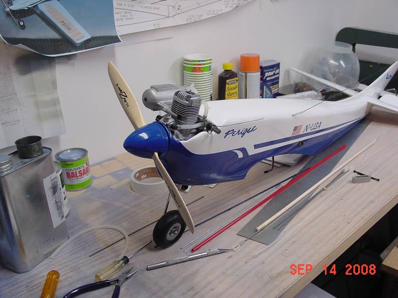

The business end - all plumbed and ready to go!
Funny story about the nose wheel - because of the extreme depth of the engine compartment, I could not get an allen wrench down there to secure the nose gear. So it is on the plane just by the grace of the steering linkage. This will prove to be interesting as time goes on.......
Old 09-15-2008 | 07:27 AM
  #334
Posts: 107
From: beechgrove, IN
Nice clean installation Wedj. Good to see your old school method using foam everywhere. Thats how mine look. It drives me nuts to see how some of the bigger hi dollar airplanes just have the receivers velcroed to the airframe with nothing for shock protection. Another thingthat has always bothered me is the lack of shock mounting for the switch. The switch is one of the weakest link in the system. I don't usethe dinky switches that come with the radios but instead use something more substantial. I also shock mount the switches using servo grommets between th
e airframe and the switch when possible. Call me "old school" but vibration is a killer especially with a screamin' 2cycle. Beautiful airplane! regards Sugarfox
Old 09-15-2008 | 08:01 AM
  #335
8178's Avatar
My Feedback: (17)
Joined: May 2004
Posts: 4,351
Received 15 Likes on 7 Posts
From: Atlanta, GA
You need some of these http://www3.towerhobbies.com/cgi-bin...?&I=LXE246&P=7
Old 09-15-2008 | 08:06 AM
  #336
WEDJ's Avatar
Joined: Feb 2007
Posts: 1,739
ORIGINAL: 8178
Yes. I didn't realize they came in the smallser sizes. I have the 4-40 and 6-32s
Now I gotta take the engine out.

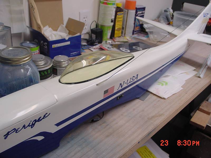

My intention with the canopy is to dig a trench and spot glue it in. Then, mask it off +- 1/8" inch at the intersection and apply a line of black RTV to both hold it secure and to make it look like the original. Smoothed into fillet shape with a lacquer thinner wetted finger. Or maybe a popsicle stick.

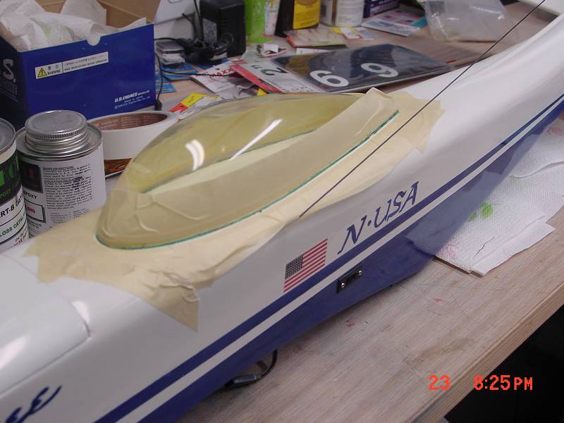

A suggestion on your canopy installation and maybe you already plan to do this. I find that painting the area that the canopy covers a dark color when you have a white fuselage really improves the look of the canopy.
Although I agree, I think I want to leave it like the original. Yes, I did think about painting it with the blue of the trim.

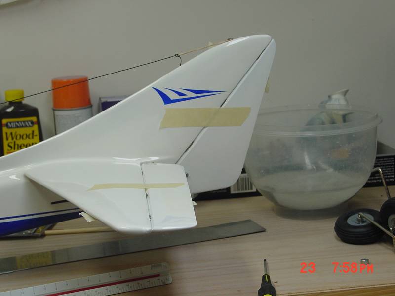

Determined to finish, down to the final stuff to do...........
Like putting the control surfaces onto the tail

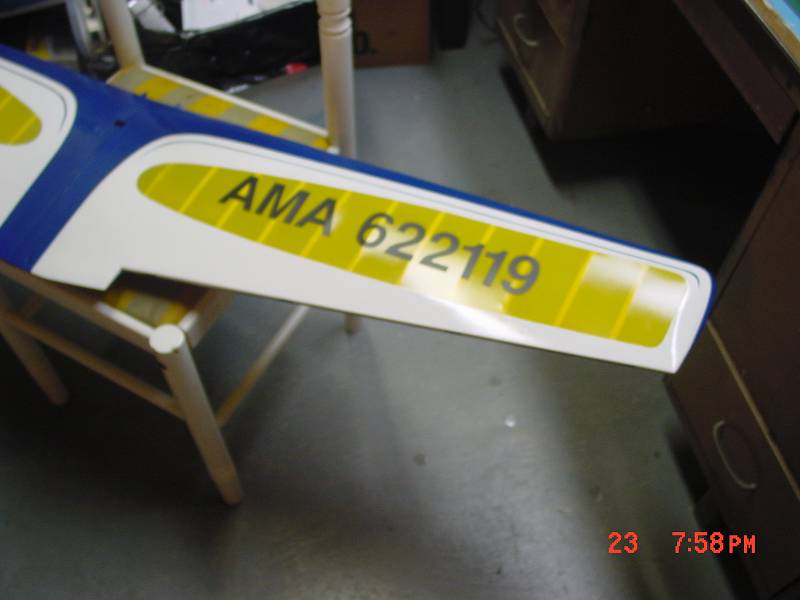

Next, I can't resist pushing the envelope. Since I sprayed clear on the right wing half yesterday, I am free to put on the plastic lettering.

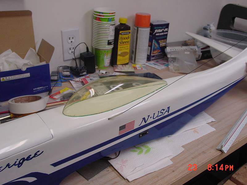

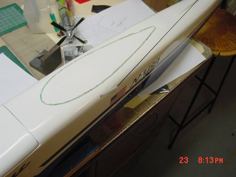

Next up on the detail list - install canopy. FIrst, cut a groove to accept the edges. Then spot glue the canopy in.
ID:	1039825   Click image for larger version

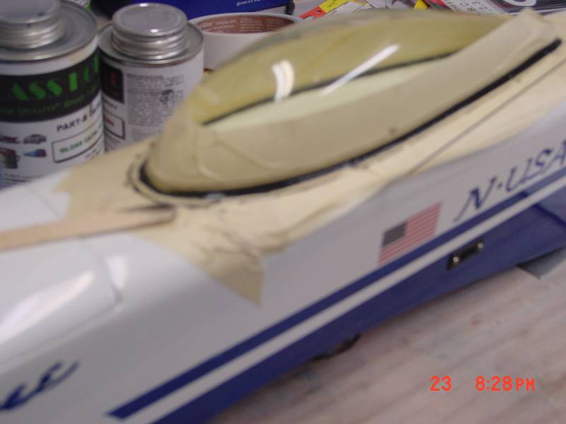

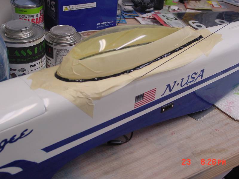

Mask it off, smear black RTV, smooth it out with a tongue depressor, take the masking tape off, and you are done! Not too bad for an old guy.
ID:	1039839   Click image for larger version
ID:	1039840   Click image for larger version
