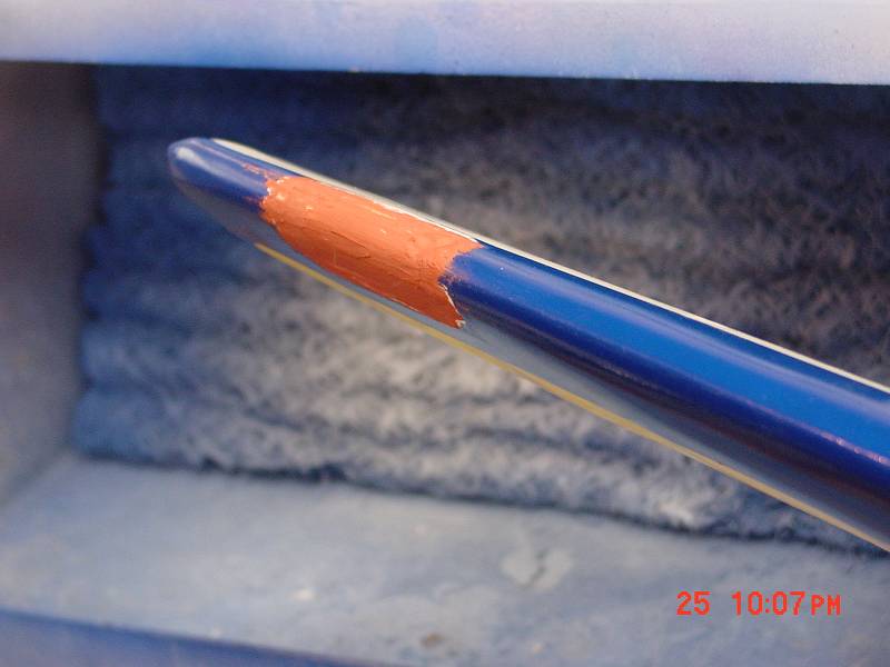

Liberal amount of body putty, let it dry for a few days, then attack it with 220 grit wet, followed by 400 wet. I think we're ready to paint.
