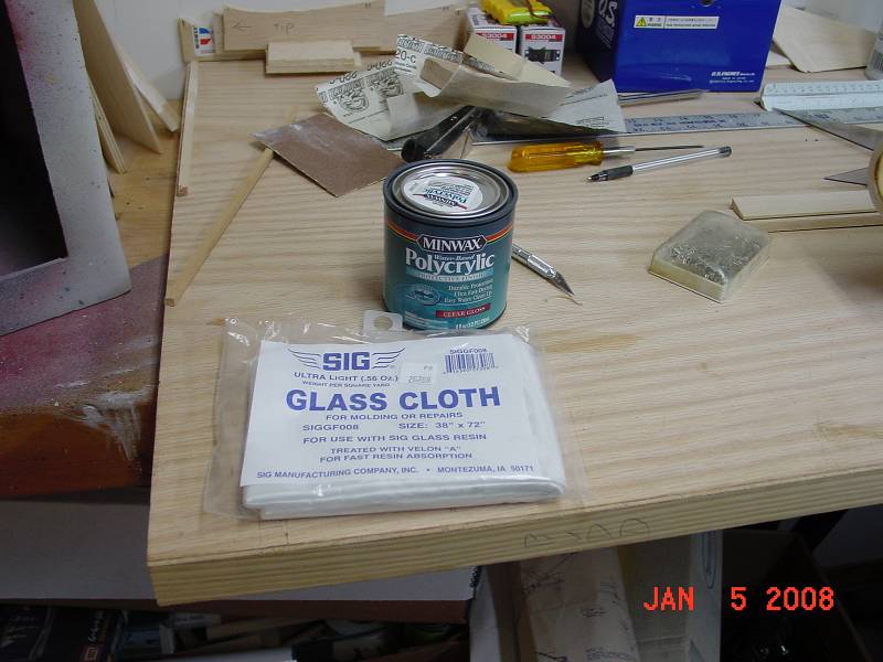

Well, it seems super coverite is discontinued. Koverall is problematic. So this morning I did a little internet surfing, and now have a NEW plan "A"
Wing - Solartex Vintage yellow. Iron-on fabric, semi-transparent (like silk, they say), and can be painted.
www.solarfilm.co.uk/solartex.html
Body - see below. Since I used to use Polyester & glass on the .60 PPs, this should be a stroll down memory lane, without the smell.

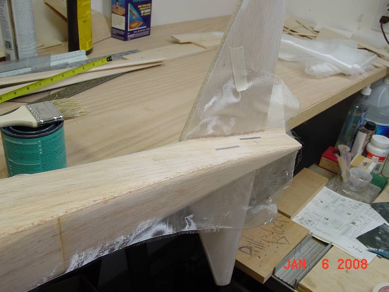

Old 01-06-2008 | 11:19 AM
  #160
WEDJ's Avatar
Joined: Feb 2007
Posts: 1,739
From: Stockton Springs, ME
Default RE: PassTime Perigee Build thread
Don't worry about getting the cloth into every corner and crevace, like around the stab. If some wood is exposed, it will still be sealed by the poly, and primer and paint. This is unlike Monokote, where you have to cover every bit of wood. Besides, around the stab there will be epoxolite fillets later.

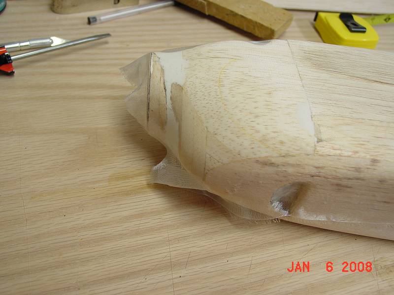

Old 01-06-2008 | 04:34 PM
  #163
WEDJ's Avatar
Joined: Feb 2007
Posts: 1,739
Working towards the rear, but only on the sides now. Top and bottom will come later. Look close, you can see I missed the very rear lower fuse by about 1/8 inch. Like I said before, that's not a problem with this method.
Old 01-06-2008 | 04:37 PM
  #164
WEDJ's Avatar
Joined: Feb 2007
Posts: 1,739
Working up to the nose, all is nice and smooth. The glass cloth just clings to the surface, and can wrap around some pretty complex shapes, like this nose. If you do get a wrinkle that won't pull out, just slice and overlap it. Later on during the sanding process, that will disappear.

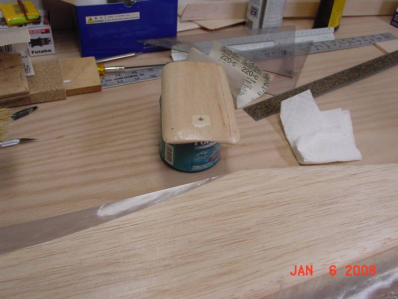

Old 01-06-2008 | 07:04 PM
  #165
WEDJ's Avatar
Joined: Feb 2007
Posts: 1,739
Once the poly is cured, it is time to cut off the excess. where there is an edge, the easiest is to just take some sandpaper (320) and scuff the edge, the cloth separates easily.

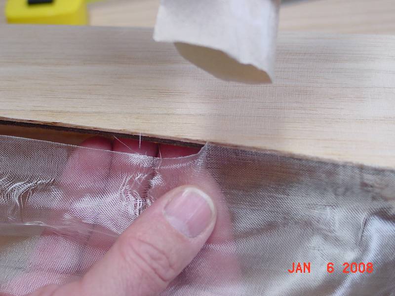

Old 01-06-2008 | 07:06 PM
  #166
WEDJ's Avatar
Joined: Feb 2007
Posts: 1,739
However, on flat areas, that is not possible. Here you just pull the loose cloth at 90 degress to the surface, and use an Xacto knife to separate.
