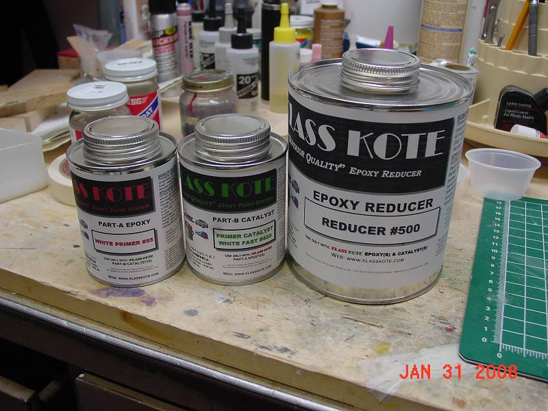

So now I'm ready for primer. As I said, I am using Klass Kote epoxy finish. Stuff smells just like the K&B from 20 years ago. I'm hoping it will work the same way, too. The K&B primer would make good volume, light, and sand away like a dream. Oh, in the background, you can see I got some dope for the control surfaces to prevent warps.

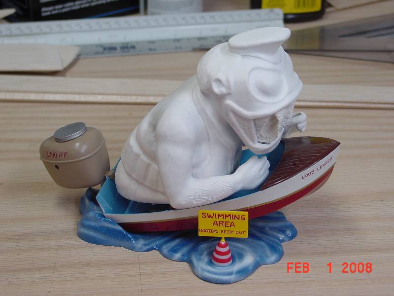

Oh, and just because I was snapping photos, I also do plastic. Here's Leaky Boat Louie in progress.........

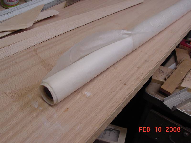

Cleaning up a bit in the shop, I discovered an entire roll of Silkspun Coverite, which they don't make anymore. After resin, I started to use this as a primary covering. Iron-on, no sanding, no smell, very strong, fills with primer really well. If I had known about this, I would have done the fuselage in it. Oh, well, at least I can cover my control surfaces.
After application, I would go straight to primer. Then sand, putty as necessary, sand, shoot a second primer coat, lightly sand, then paint.

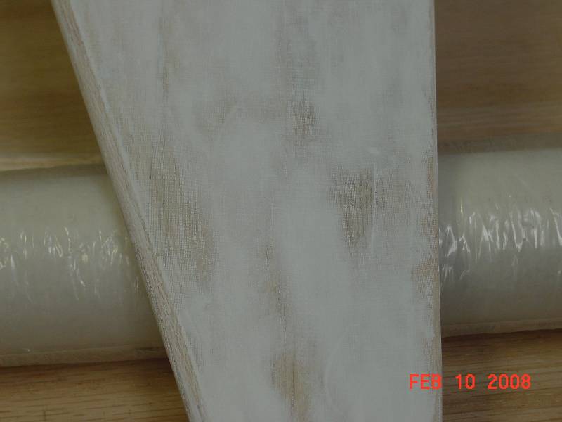

So I decided to spray the primer. The extra sandiong of the brush coat is not worth it. Better to clean the sprayer. Besides, I wanted to try out my new Badger 400
After sanding, you can see how the primer really fills the cloth weave. Some putty for the dings/dips, then another primer coat, and I will be ready for paint.
