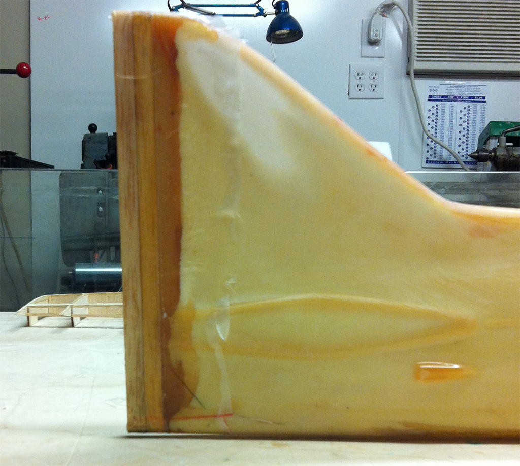

Ok, the stab has been extended to 3/4'' and a couple layers of glass were applied. Next a coat of finishing putty so it can all get blended in.

It looks a bit tall on the back part, better thin it down a bit.

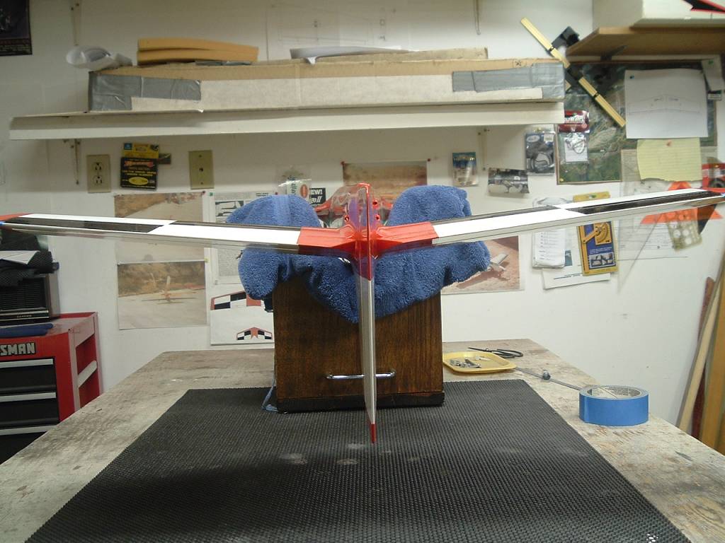

I put a t-square on it fuselage while it was suspended and if I line the 4' square up with where the wing chord line goes and put a 1x2 board as a spinner it looks like I have 2* down thrust and 1/2* left thrust so the minimum I need to do is get that left thrust out and some of not all (probably all) of the down thrust out.
So once the stab is smoothed out, we'll make a wing mock up and get our incidence datum from that point and then double check the nose.

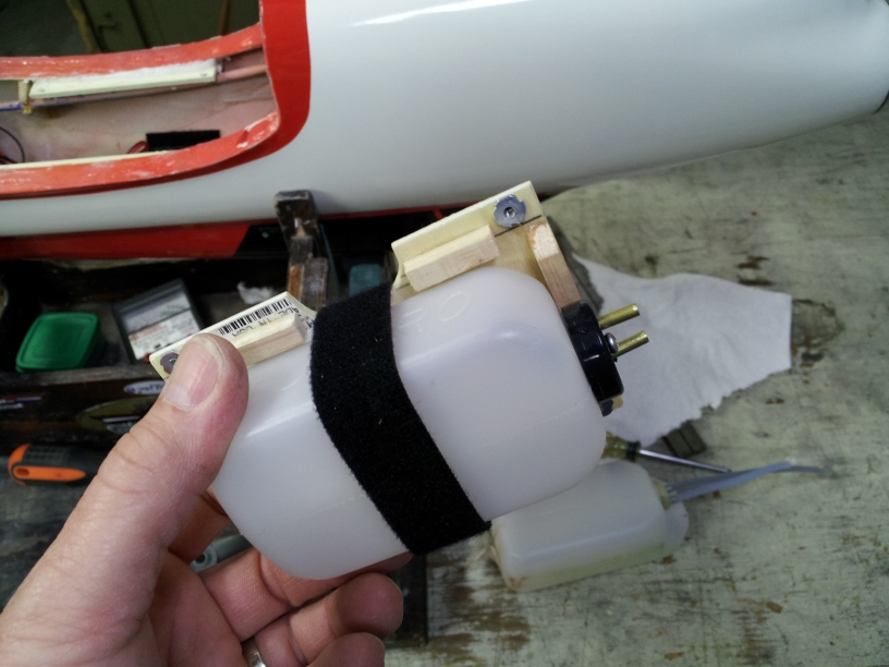

I have a question though, what are the clothes pins for? Bladder tanks? I'll be using one for the first time. I got a 6 oz to use in the DB but when I move up from Novice I might run out of gas.

6 oz is a VERY small tank for a pattern plane. I don't know what engine you're running but you most likely won't get more than 4-5 minutes. That might not even get you through the Novice pattern if you have to wait to take off - if someone is landing for instance. IMHO, 12 oz is about the ABSOLUTE MINIMUM tank size for a .61.
Just my 2¢ worth.
Jim

I have a 12 oz now. It takes 63 cranks to fill it and after I finish the round I only put 13 cranks back in it with a Thunder Tiger Pro .61. It's on a Super Kaos at 7.5 lbs and I use throtle management so I don't think a 6 oz with an OS .55 is too far out IF it's flown in the same maner and has the same weight which for the DB I think I'm right on spot. However I based that on the TT Pro which is an work horse that is broken in and a plane with a fat airfoil and can tollerate throttle management. I think the DB will be fine but not the Vertigo. Based on what I've heard about the Phoenix I'll be looking at a Novarossi or Jett or something like that. It's all going to come down to weight. We can get a DB to 6 - 6.5 lbs so that opens up a lot more oportunity IMO. Time will tell but I'll share the info.
Plus with a bladder tank you can use close to 100% of the fuel. The 6 oz 'snaps' into the canopy so with a little silicone it should be out of the way to put a 4 oz tank on the CG as a header tank.
I do respect your opinion Jim and you voiced something that keeps echoing in my head. I'm just guessing till I get it in the air...keep'er high!

Sounds like you are doing fine on fuel. I obviously wasn't following your previous post. I guess I'd also forgotten how short the Novice pattern is. Besides, I haven't flown pattern 61s since the 80s. My last competitive pattern experience was back in 2000 flying the 2-meter OMS shown in my avatar running a piped Bully (Webra) 120LS 2-stroke and flying the Masters turnaround pattern. That's a major differnece in fuel usage and length of the pattern compared to Classic Novice,
Disclaimer - I've never flown a Vertigo. With that said, I'm going to differ with some fo the others on the NEED for a Jett or NovaRossi in almost ANY 60-size pattern plane. Well, the EU-1A might be an exception. I flew a 10 3/4# EU-1A in Novice/Sportsman back in the day with an OS 61FSR turning a Zinger 10.5x7.5 prop north of 14K on 10% nitro fuel. I couldn't do 500' tall loops, but I had plenty of power for anything I NEEDED to do.
IMHO needing a Jett or NR falls into the same category as saying 100+ in-oz servos are necessary for 60 size pattern planes. It's GROSS OVERKILL IMHO.The EU-1A above flew with Futaba S121 servos at about 50 oz-in of torque and NEVER had a problem. Of course, YMMV.
BTW - I remember when Rick Byrd was just a teenager. We flew at several of the same contests in Oklahoma and Texas many moons ago.
Jim

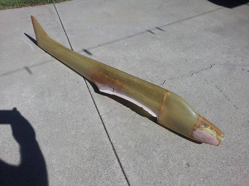

Ok, after a lot of sanding, fitting, puttying, sanding, measuring...it's ready for molding.
I projected the plans onto the fuselage with the overhead projector to make sure the wing is in line with the thrust line (red line) and we lucked out, everything looks good...knock on wood.
Some guys are showing up to build night tonight but I don't think we'll get any glass on it since we need to glue strips on the underside to keep the clay from pushing through and fill in around the wing saddle.
I chose not to paint the fuselage so I'll get several layers of wax and PVA on it to make sure it releases.

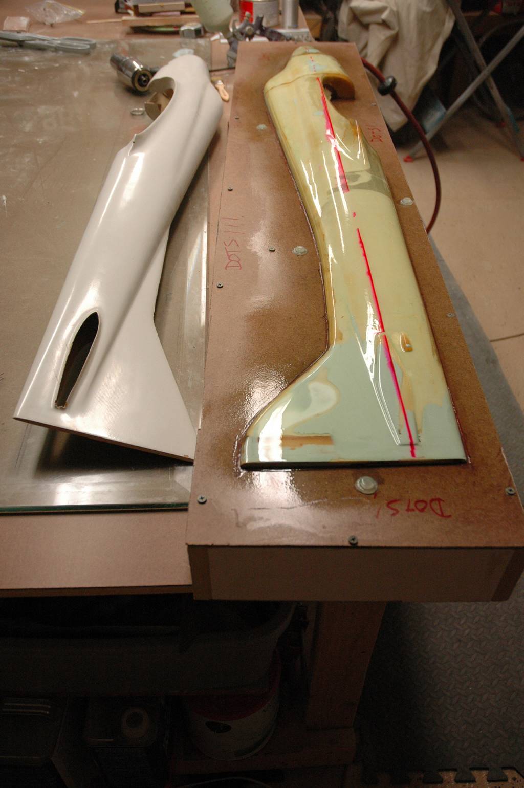

Here are some pics of my plug. I am reworking the saddle area, and toning down the bulges at the rear of the fillet. I presume that hey are there to make room for the hardwood blocks that were in vogue for the wing bolts back in the day. I don't dig or endorse that method, I use as ply plate (see back in the thread.) Much better load distribution. You guys are inspiring me to get back to it. I have a new 2 meter to assemble, then i think I am going to pick back up where I left off.
-Robert

That is a lot of repair in the saddle area. I hope I'm right about this one being made correctly or I'll be making a new mold.
The first one I pull will be thick so I can use it as a plug later if I need to. I managed to get the stab back in shape. I'm not as pleased as I was before but I think it will come out fine. There's a small dimple but that can be smoothed out of the mold.
I just put the last thick layer of PVA on it. You can see in the photo it's really straight so I think the PVA may be filling the dimple...good with me.
The plane next to it is a Cutlass that I need to get to at some point too but I know what you mean about the motivation in seeing other guys planes. Every time I see yours I think, 'man, I gotta get this thing done'. It's too wet to paint the Dirty Birdy anyway so I might as well keep busy. It makes nice breaks while drawing in CAD all day.
I might just have to glass this side tomorrow because I can't wait for the weekend. I've gotta get one pulled so I can see how it comes out.
