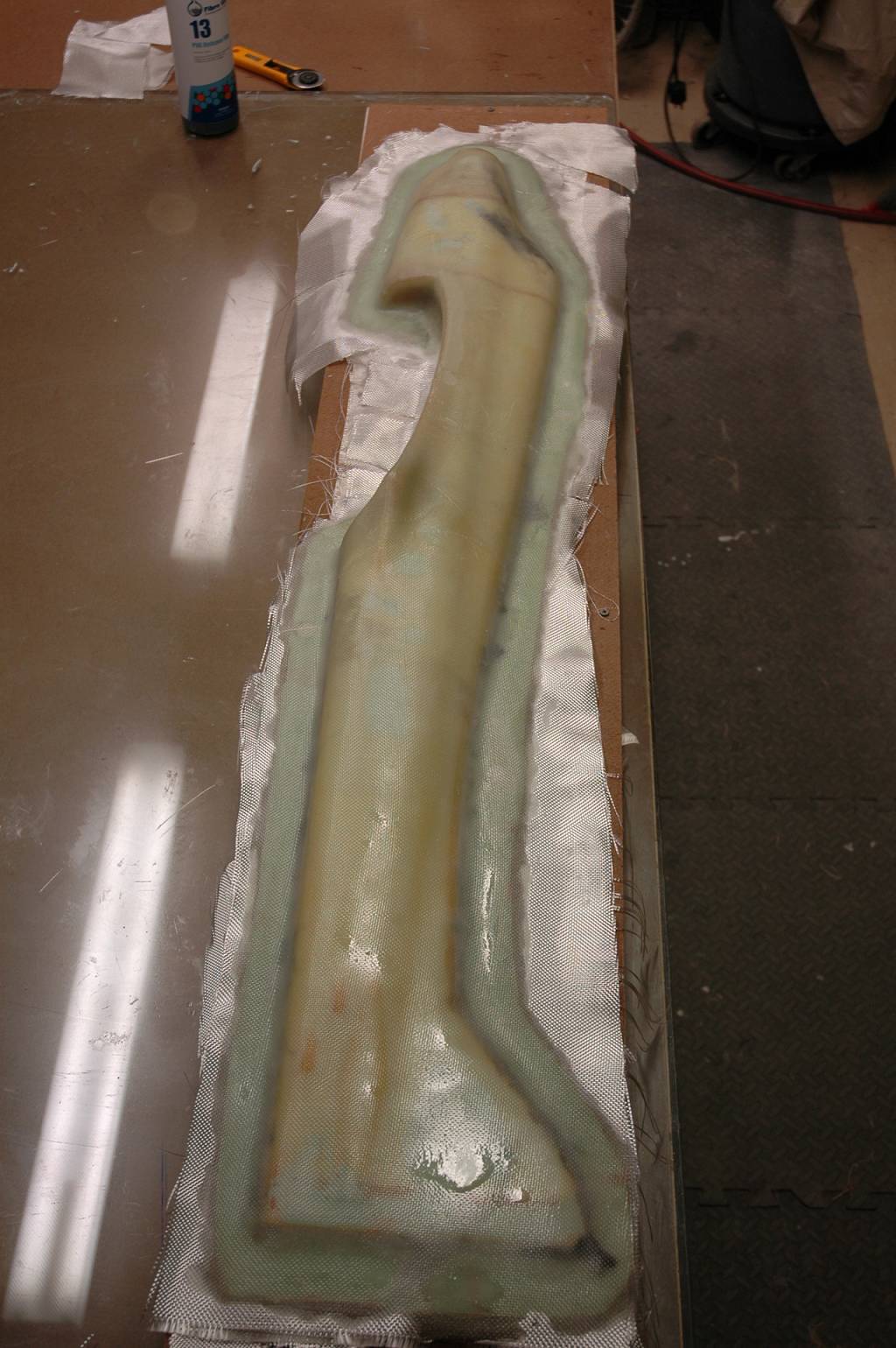

First side is done. I have no idea how many layers because I just patched in all the scraps I had but I figured I got at least 6 layers of 6 oz which I usually do about 5 layers of 9 oz but I think it will be fine.
The back wing fillet area is a beast. I have the feeling I'll be digging out the bubbles and remolding that corner.
I went fairly slow because I didn't want the epoxy to kick and heat up the fuselage...that's the last thing I need is for it to warp.
Robert, after I got the PVA on last night I noticed the fuselage side was had some really small waves in it. They are not bad but I didn't see them with the straight edge so they will stay. How's that for nostalgia? 'It's authentic, look at the ripples!'
I suggest putting 3/4 ounce on top at the end to help prevent the frayed ends of the glass sticking up when it's dry. They act as a serrated knife.

The mold is done. Found a big air bubble over the wing saddle but I have some loose weave 4 oz against the surface coat so hopefully it stuck. If not it should be a simple fix.
For a while I'll be posting on the other site on the Vertigo II thread Fred started.
Next I'll be drilling some bolt holes so I can clamp it together while I lay up a fuselage. Hopefully by Monday I'll have a new fuselage.
Is anyone interested in seeing this stuff? I don't want to put anyone to sleep like I do at the club meetings. I understand most of us don't have the time for this kind of stuff since we have a few ARF choices now.

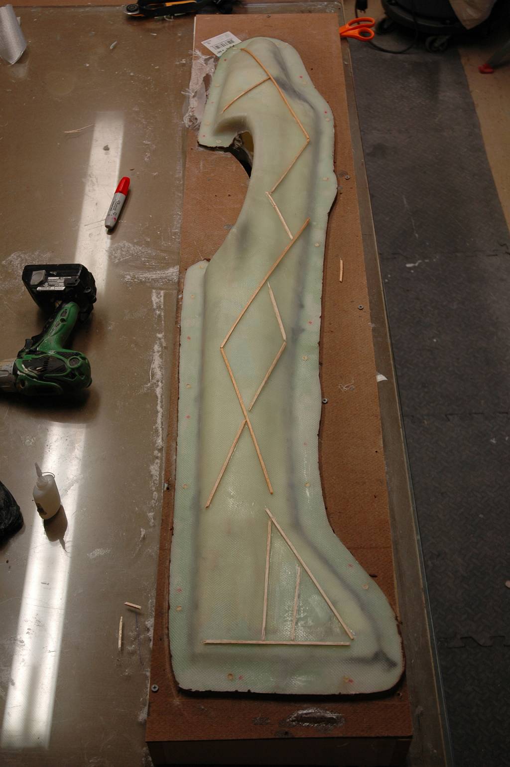

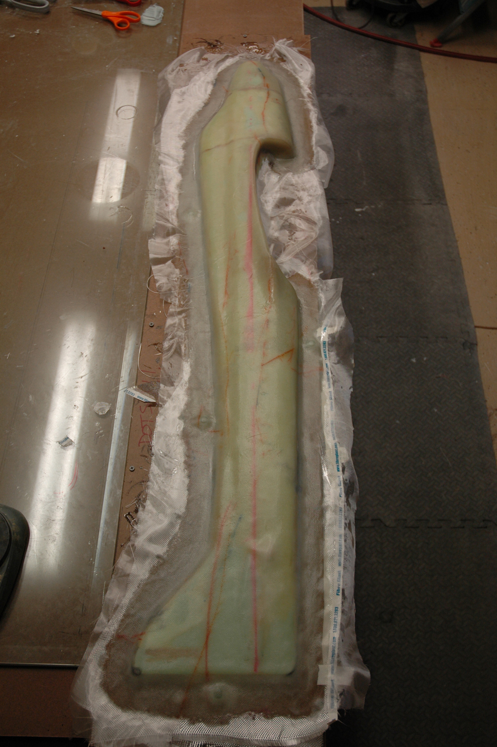

Alright, for Robert, Brian, and Steve...
I was right, the mold was too thin. The 8 oz cloth was way too light, it said tooling cloth but I don't think so. I won't get into why but if you are going to try this shoot me a PM and I'll explain it.
I thought I'd experiment a bit so I glued balsa sticks to the outside of the fuselage and glassed over it with (3) layers of 8 oz glass and then put it in a vacuum bag at about 8" Hg which is roughly 4 psi. I sealed the holes for the bolts with plumbers putty and put Y2 Clay around the flange where the two halves meet. The fuselage is in the mold too to help keep the mold straight. The only reason for the vacuum bag is to get the glass as smooth around the sticks as possible and smooth out the epoxy.
The sticks act as a truss system and I'm expecting it to be sufficiently strong...we'll see.
I figure at this point I'll be at about 1800 grams of epoxy when I'm done. I'll need more supplies after this. Time to go to the gettin' place...lol.
