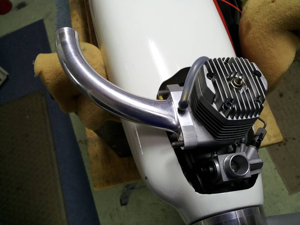

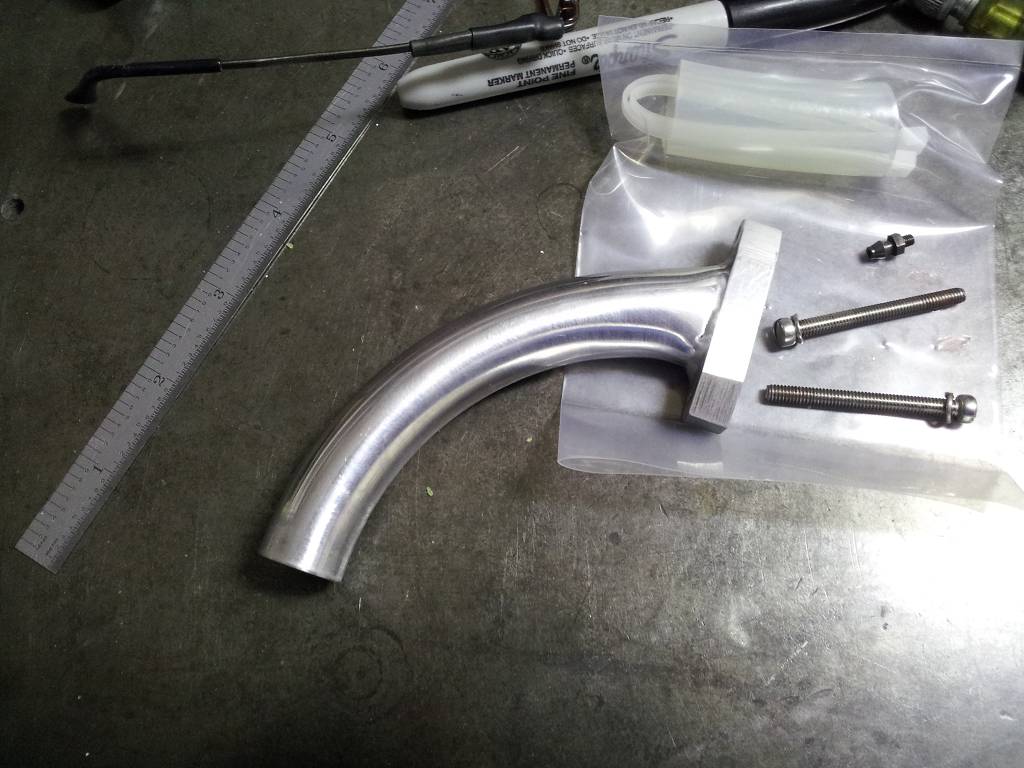

The source of the mystery oil that was appearing all over the nose turned out to be a cracked header. I'm lucky that it did not fail completely in flight. I ordered a replacement item, I may see about having the old one welded up and keep it in stock for a spare.

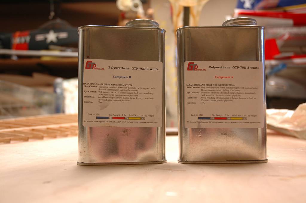

I added the polyurethane filler. Man that was hard to do to an old original fuselage but I've got to get the ripples out and I didn't want it to cave in while laying the mold.
I'll attach a picture of the poly I use. It's from a place called GT products in Grapevine, TX. It pours like thin epoxy and takes about 5 minutes to kick and about 30 minutes to harden. I rotated the fuselage till it hardened and have a max of about 1/4" wall. BTW, I got permission to do whatever to the fuselage as long as we can pull some more.
