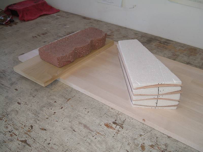

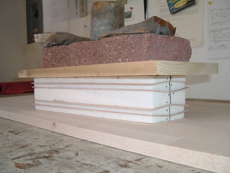

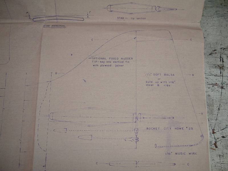

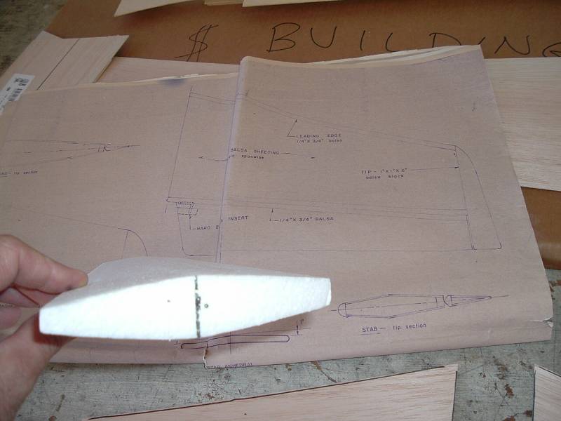

Let's get this party started. I will begin with something small, like the stabilizer. The Vertigo II has a thick, diamond shaped stabilizer airfoil. The purpose is to soften the elevator feel around neutral, for smooth pitch response. It works, and does so by creating some almost dirty airflow behind the airfoil highpoint, the opposite of a laminar flow section. When Kraft Systems offered something new called "exponential" as an upgrade to their Signature Series radio, I set mine in and got it. I found that exponential in combination with the diamond shaped airfoil was too mushy. In the photos, the dark line is the grain line. It is important to align that with the high point of the airfoil so the balsa skins will fold evenly over it. Having the grain cross the high point at an angle would yield some funky results. The rest is straightforward skinning, I will not go into detail here. BSI 20 minute epoxy is used.

Hey Klix - You came out of the chute fast ! Thanks for the info on the diamond stab. When I looked at the Vertigo I have, knew there had to be a reason for this.

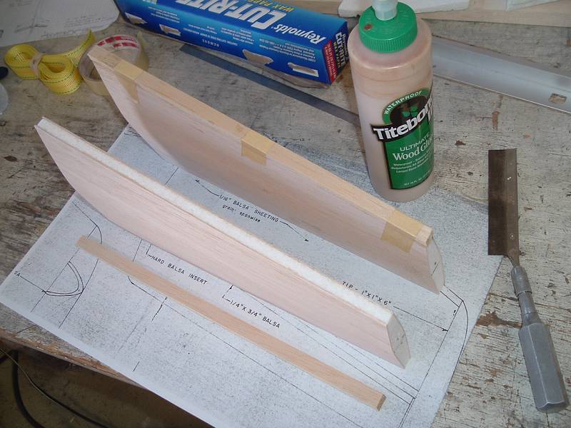

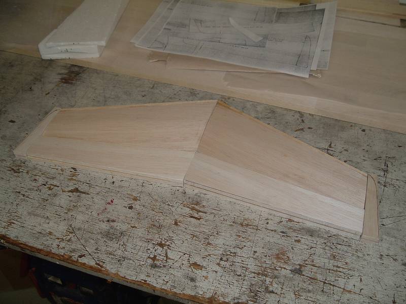

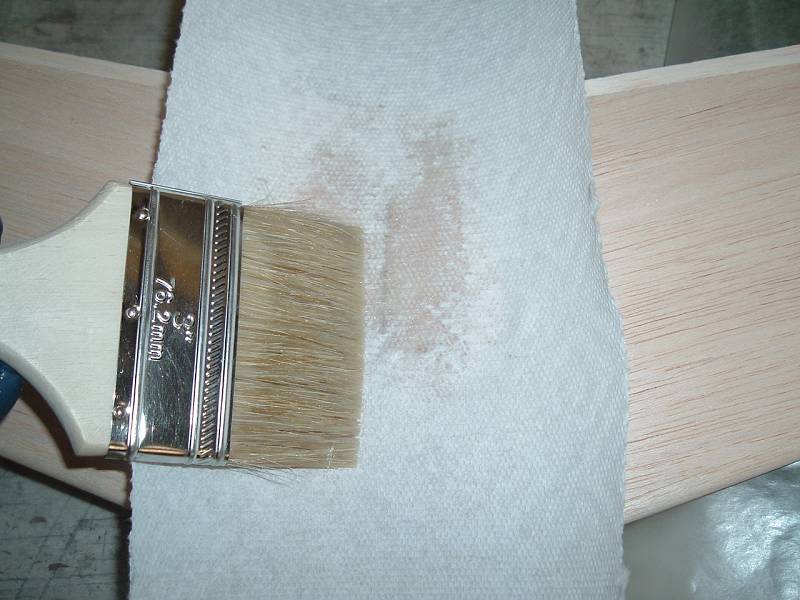

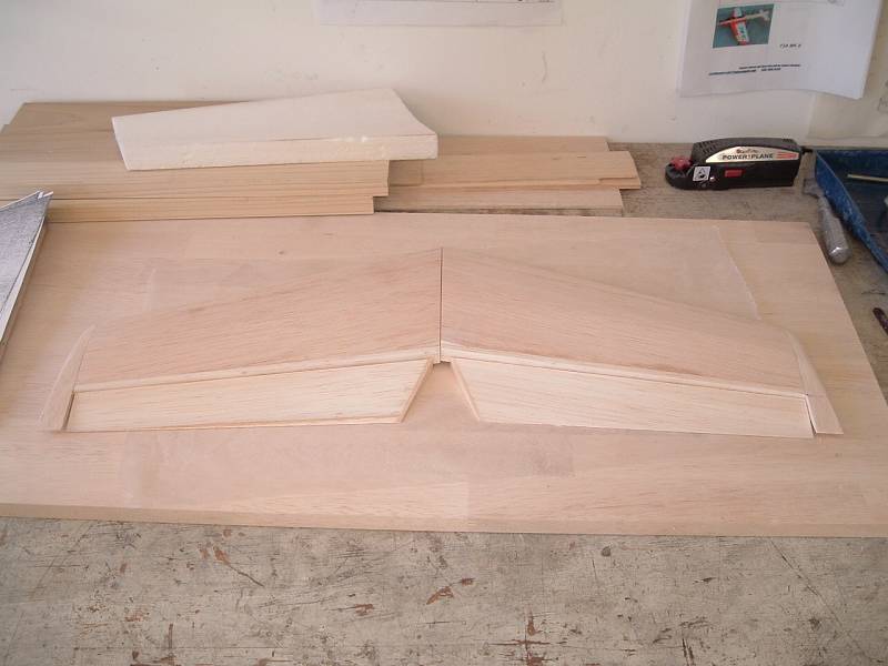

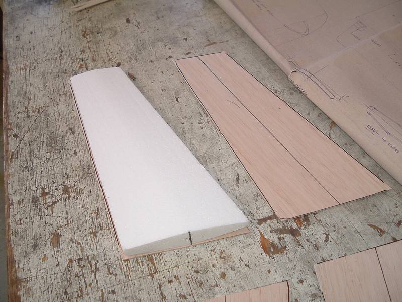

Finally, some building time. The skins have been trimmed back flush with the cores in preparation for the leading edge, trailing edge/elevators, and the tip blocks. The sanding was done with the sheeted coes in the foam blanks from which the cores were cut. This helps prevent damage to the sheeted surfaces, and helps to keep everything square. The first pic shows the leading edges being glued in place. Regular Titebong glue is used here, it will leave a glue line that is easy to sand.
The original design calls for the stabilizer and elevator to be cut from one core, then the elevator cut free after sheeting, then balsa caps are added. This works well, and makes for elevators that are light, and that match the stabilizer perfectly, airfoil-wise. I have two sets of cores, one cut as previously described, and a second set that only comprises the stabilizer section, the elevator to be made from balsa sheet, and shaped to match the core. The one piece core airfoil did not match the plan very well, but the stab-only core did. So I decided to use the second set, even though it will entail more work. The elevators are flat due to the diamond shaped airfoil, so matching them up evenly to the stabilizer will not be that big of a deal. I needed 3/4" thick balsa for the elevators and tips, so I laminated them from two pieces of 3/8" soft sheet. The glue line will act as a centerline helping to keep everything straight when shaping the parts later. When shaping is complete, the elevators will be cut free down the hinge line, leaving the stab trailing edge in place. The second pick shows the laminated parts, lined up as they will be attached to the sheeted cores.

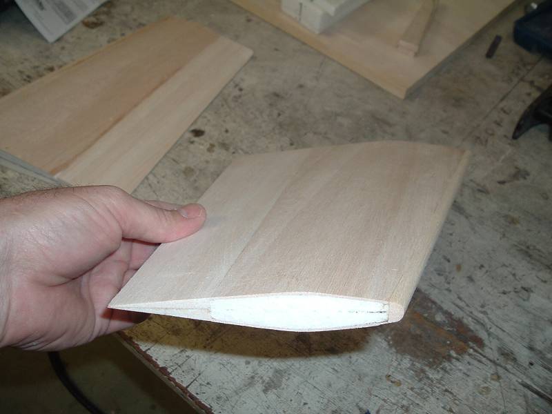

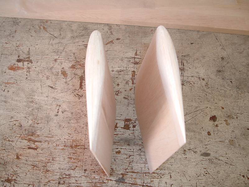

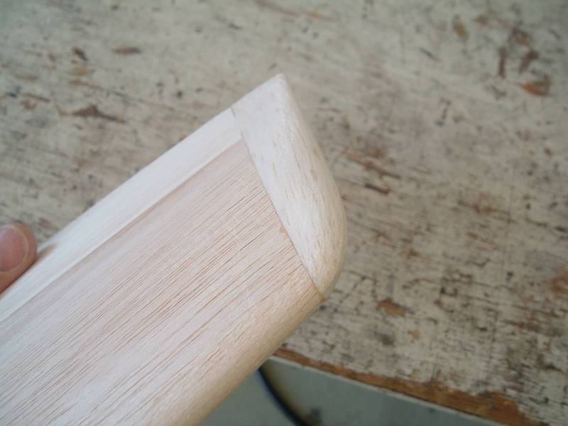

Stab tips blocks glued on, then shaped. Elevators marked, then cut out using bandsaw. Elevator rudder deflection cut made, then capped with a piece of 1/8 balsa on horn end.

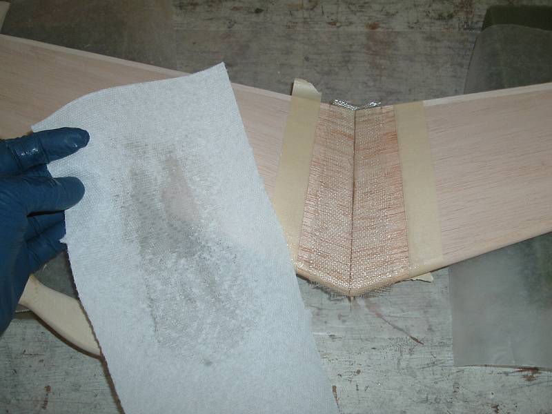

Nothing says old school like anhedral! I like anhedral. The original design called for a flat stabilizer, but as the anhedral craze of the 70's caught on, I went through a couple of modifications to my V-II increasing the anhedral until I liked it. The set of plans that I have shows (clearly inked on sometime after the original drawing was made) 1" of anhedral for a total of two inches. So I guess that makes it an "authentic" modification. I can't remember how much I settled on, but 2" didn't look like enough, so I went with 2-1/2". The stabilizer halves are glued together using 5-minute epoxy. Now time to add the fiberglass center section reinforcement. I want the glass to extend 1/2" past the fuselage sides, giving me something solid to blend the fillets into later after mounting the stabilizer to the fuselage. I marked the stabilizer with pencil lines corresponding to the dimensions on my sketch. Masking tape is placed 1/4" to 3/8" beyond the pencil lines. This will leave a thin hard epoxy skin to blend the edge of the glass into, reducing the chances of digging into thre balsa skins, weakening them. I cut a paper template for cutting the fiberglass. After the glass was cut and fit-checked, I mixed up some BSI 20 minute epoxy, and spread it (I hate this word) liberally onto the stabilizer in between the masking tape. The glass is laid down between the lines, and patted with the brush to absorb the epoxy. Then, a paper towel is places over the fiberglassed area, and patted down with a dry brush to absorb the excess epoxy. The epoxy is what weighs, and removing the excess assures a lightweight product. This same principle applies to 3/4 oz. glass used to glass wings, etc for painting. The tape is removed and the assembly set aside to cure. Trim after the epoxy is cured, and repeat on the other side.

I have two set's of Vertigo plans here. Is the anhedral shown on any plans of the Vertigo's, or you the only one that did that ?

Here is a pic of the anhedral detail on my plans. I bought two kits before starting this project. One kit did not have plans. It had the white gel-coated fuselage. The other kit (that came with plans) has a non gel-coated fuselage. That is the one that I am building up to fly. It also came with the odd-ball cores. The stab cores were stab only (no elevators) and the wing core is much thicker at the trailing edge. I can only speculate that the purpose of this is to compensate for the error in the wing saddle. Making the wing section thicker would bring the rear of the chord line down, compensating for the negative incidence in the wing saddle. That would be cheaper and easier than fixing the plug and making new molds. It is also as Mickey Mouse as heck.
I believe that the second kit is a much later production. These things would make sense on a kit that was ending the end of it's production life. I'm sure skyglas did not want to spend a bunch of time and money fixing stuff that they may not get a sufficient return on. That's my guess anyway.
Expected weight- 7-1/2 to 8 pounds dry. That may seem like an aggressive goal, but I think it can be done if I play it right. My first one was around 7-1/2 if fuzzy memory serves right. Ha Ha!!
