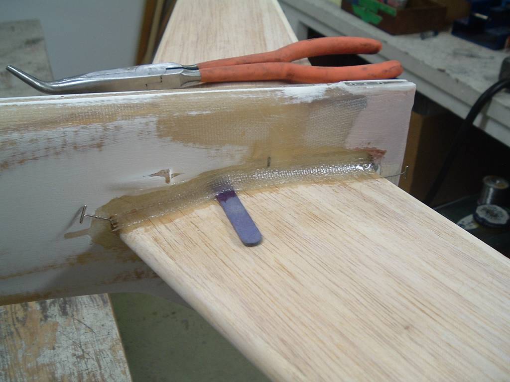

Tail installation complete. I used some glass and 30 minute epoxy to fill the gap on the underside of the stab. It made for a very rigid mounting. Two layers of glass strip were used. The glass strip is the same as is typically used to join fuselage halves in the mold, approximately 4 or 6 oz equivalent. The blue stick is wedged in there to keep the stab level. I dremeled it flat after it was cured up.
Sometimes beauty does not grow on trees, it must be carved out of microballoons. Note how I was able to blend fillets into the molded pushrod exits. I love shaping fat, sexy fillets! The fillets are Bob Smith Industries 20 minute epoxy and old K& B white microballoons that I have in stock. I can't say enough about the BSI 20 minute epoxy. It is light, thin and sands better that polyester resin. It makes a light fluffy microballon mixture. It is used for the wing and stab skinning, as well as the glass on the stab. I'm glad that I didn't cut corners with the stab. It came out so nice, the glass sanded out very nicely. I am very happy with this build.

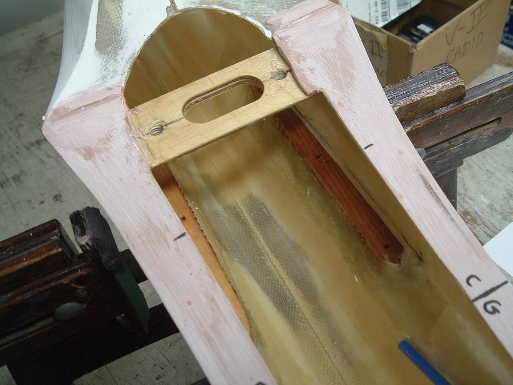

This is a duplication of sorts of the removable servo tray that was engineered by my Father in my original Vertigo II. Due to a nose heavy condition on this build, I have all four fuselage servos (Rudder, Elevator, Throttle & Retract) all in one tray, and set as far aft as possible. The mounting rails are spruce, and are glued and glassed to the inside of the fuselage using polyester resin. The Spring-Air retract valve mounts in the middle of the tray between the retract and elevator servos. The tray started out as a hatch from an R/C sailboat that I built 20 years ago (I still have it). I laminated it to a piece of 1/16 ply (grain cross-ways) and then milled out some excess material to lighten it up a bit. The existing cross braces keep it stiff across the rails. Re-use of existing materials helps keep the cost down, and adds a unique cool factor to the project.
Now I have to engineer a cool way to mount the battery pack as far back as possible.

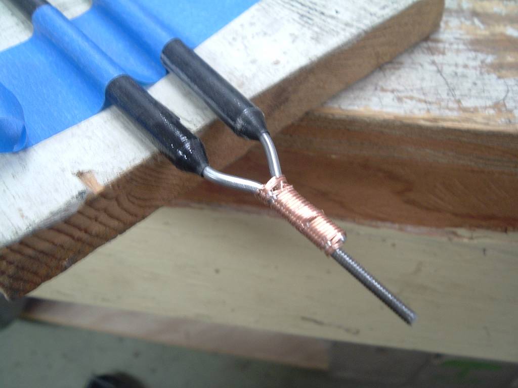

Parts used: Dave Brown arrow shafts & end caps, Robart 3/4" horns w/ ball joint, Hangar 9 4-40 ball joints (servo end) Great Planes 4-40 rods and clevis. Why 4-40 rods? Due to the nose heavy leanings of this particular airplane, I put some useful metal as far back as I could, resulting in bulletproof overkill no flex linkage. Now it is time to order some paint.

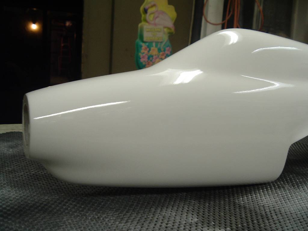

Old 08-19-2010 | 12:22 AM
  #183
KLXMASTER14's Avatar
Joined: Jun 2007
Posts: 973
From: Simi Valley, CA
Default RE: Vertigo II Build Thread
Share it with me brothers- the glorious odor of epoxy paint. Smells like........ victory.
Klass Kote. So far, very much like K&B Superpoxy. This stuff is full of solids- coats very well.
The first coat- on with a brush. It sets up fast- so you can dab up the pinholes and other flaws that become readily apparent. I use the first coat like liquid putty. Next, it's all about sanding it all off. I will spray the next coat.

Old 09-21-2010 | 10:18 PM
  #184
Joined: Jun 2007
Posts: 973
Finally a break in the weather. Primer coat- this time sprayed on. First, I over-thinned the Klass Kote primer. Went with 3 to 1 (thinner/primer) ratio. Too thin. One to one seems much better. That took me by surprise. It'S OK, it's called modeling. Learn or re-learn things.
The bellypan had one coat brushed on, sanded off with 120 grit, masked and sprayed. I was concerned with the masking tape lifting off the covering, so far so good.
Remember the nose wheel hole? Gone, like it never happened. So all of this will get sanded out with 320, the 400 grit, then the white base coat will be sprayed on. I was hoping for a 6 foot finish, it looks like it may actually turn out more like a three foot finish. Nothing like exceeding expectations.
What a beauty this one is! Coming soon- side by side photos of the Vertigo II next to it's cousin, the Pheonix 7. Stay tuned.

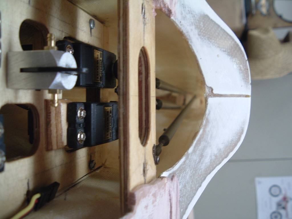

I raised the rudder servo up on 1/8" risers to assure that the rudder pushrod rides under the elevator pushrod. This, coupled with the rudder pushrod exit being lower than the elevator pushrod exit assures that there is ample clearance between the two linkages.

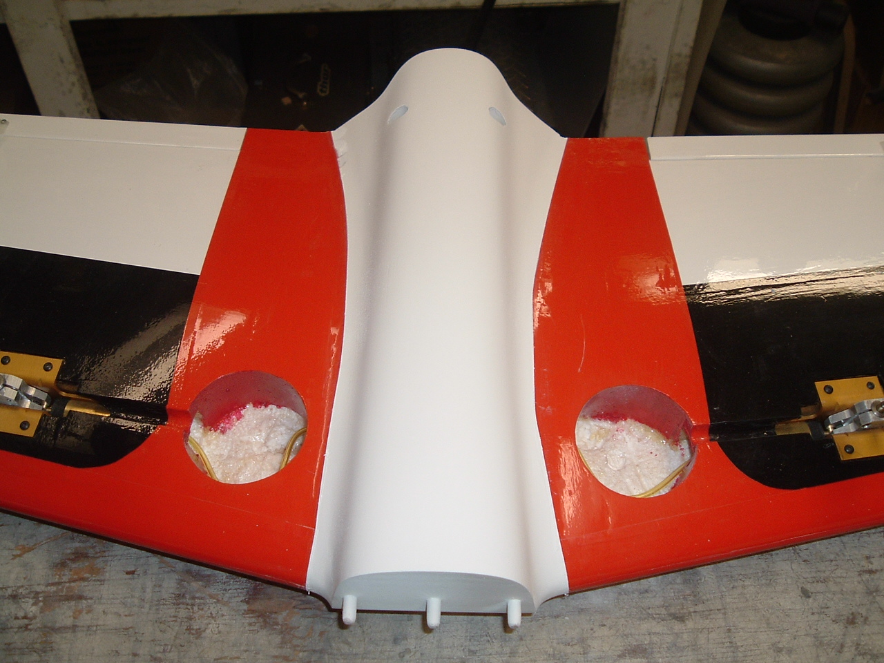

Old 09-22-2010 | 10:18 PM
  #187
Joined: Jun 2007
Posts: 973
RED.
I sprayed the bellypan with the Klass Kote red paint. I wanted to get some real color down, take a step forward. So far, I cannot say enough about this stuff. I is very easy to work with. I did very little surface preparation on the belly pan, and the results are astounding. I can't wait to see how it just shines on the fuselage, on which I have done extensive preparation. The color does not match real well- the Econokote is more of an orange-ish red. Perhaps mixing in some yellow? I am not experienced with color mixing. Perhaps one of you guys with some experience could give me some guidance.
I sprayed the wheel pants for my Focus Sport, which were white, and the results are impressive. I did nothing to the pants except wipe them down with some KK thinner on a paper towel.

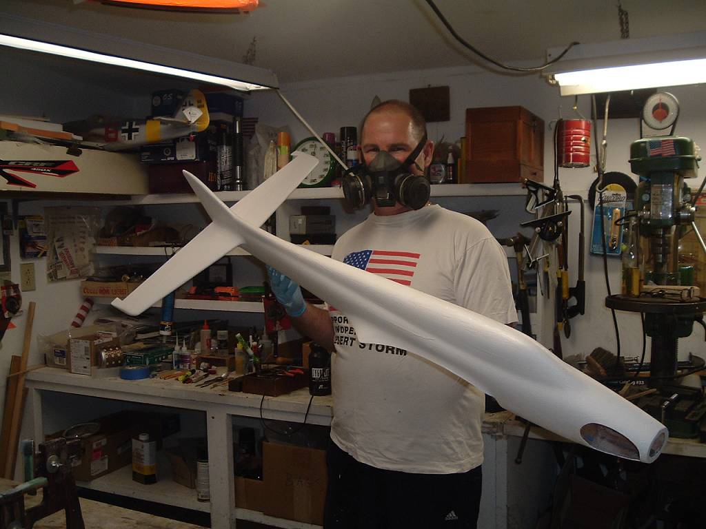

Old 09-26-2010 | 10:52 PM
  #191
Joined: Jun 2007
Posts: 973

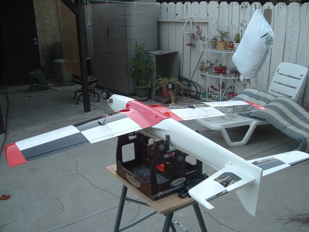

White.
It was 107 degrees todayhere is sunny Simi Valley. But it was a "dry" heat as the say in Arizona. Low humidity is good for painting. I am still impressed with the Klass Kote paint. There are a few rough spots, operator error. I am not the world's master painter by any means, but I am still within my goal of a six foot finish, or maybe a little better. Most of the problem areas are where a trim color will be applied, so it's no biggie. I can sand those areas prior to masking. There will be a few rough spots that will show- it will be a reflection of the owner. Next will be the trim colors. We are getting close to done here.

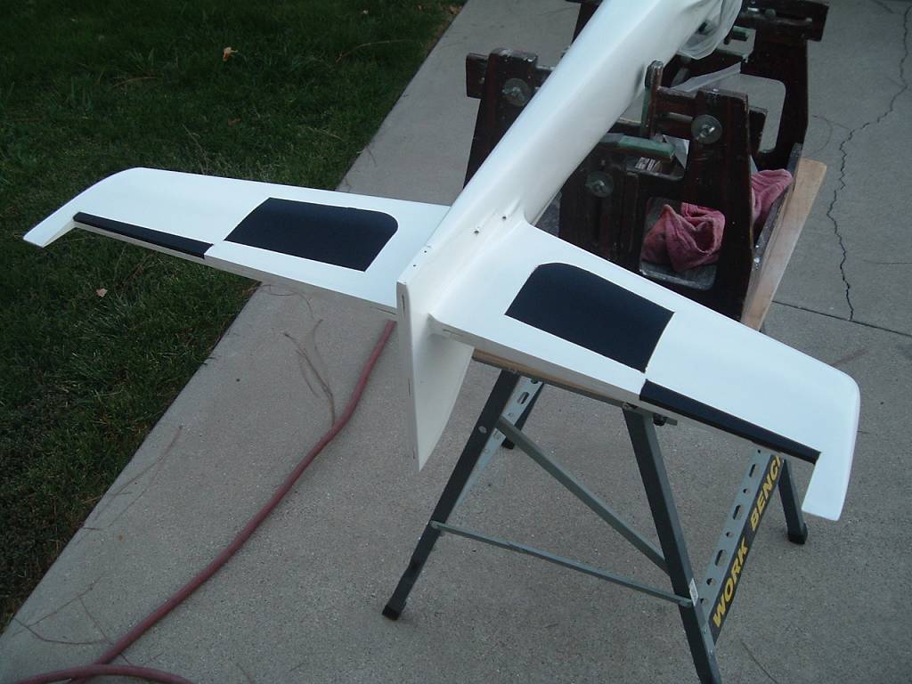

A bit o' Black.
I ordered some orange to mix with the red to better match the "red" econokote on the wing. I will mask and shoot the red it arrives. Then a bit more black (the canopy) and paint will be complete.
Yes, those are rain clouds overhead. It really does rain in California, just not very often.
