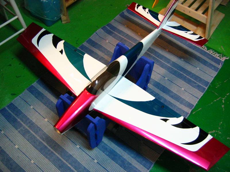

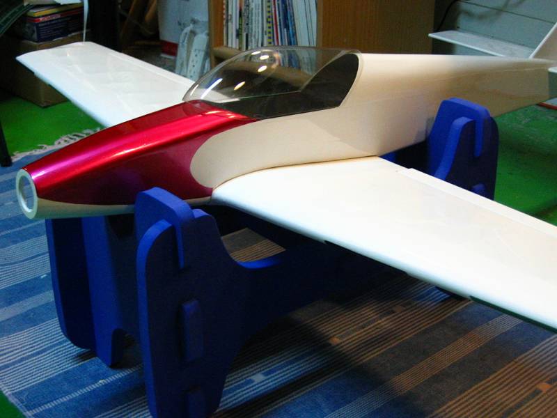

Man , I really like the Tsunami , it looks like an Ultra Sport but less draggy
You have done a really nice job there doxilia , and that color that you have on the last pic will make a nice contrast over the white
in my opinion .
I'll follow this thread to see the final job and if possible the report about de maiden .
Regards .
.You have done a really nice job there doxilia , and that color that you have on the last pic will make a nice contrast over the white
in my opinion .I'll follow this thread to see the final job and if possible the report about de maiden .
Regards .

Hey SpeedBoy,
thanks for the kind words. Yup, she's definitely shaped like a torpedo, reason for which I allowed myself to post the thread in this forum.
I'm glad you like the "pearl red". I had "royal blue" in mind as a wave metaphore but since I have none; pearl red it'll be! The contrast should be good as you say.
Updates will follow in a few days. Maiden might, unfortunately, have to wait til the Spring given the rapidly approaching blistery weather in the Great White North!

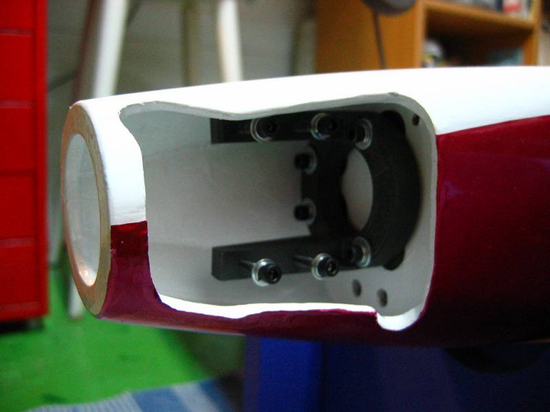

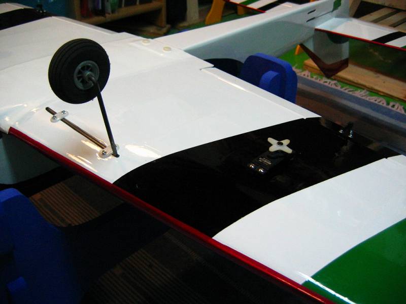

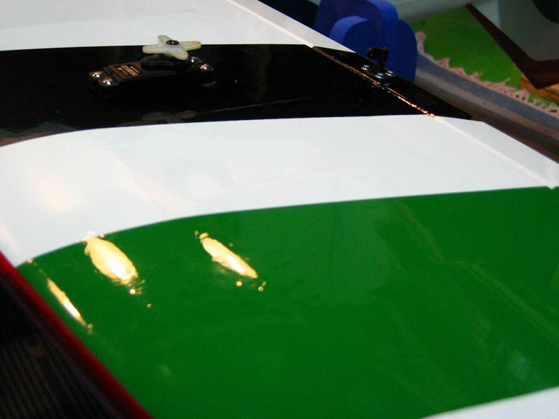

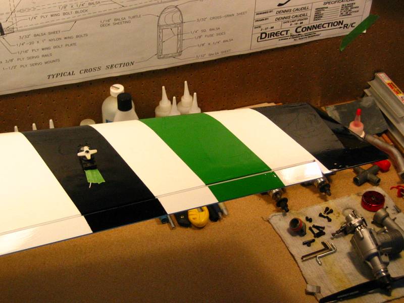

Well,... I have some photos but I thought I wouldn't post them...
...just kidding! Almost got'ya guys though!
First things first, Happy Halloween to all! Keep your toddlers from too much of that sweet stuff. I plan to feed mine castor oil doctored into their juice
. That should keep their bellies nice and stuffed! (I thought Nitro might be a little much [&:])! So we've got an "Alien Spiderman from Jupiter" and a "Cat Princess"; how's that for kids these days?
In other news, and to keep all you avid thread followers peaked
, the Japanese Tidal Wave no longer exhibits a spot of wood!
Dunno about you, but I'm tickled pink!
...must be feeling a little giddy tonight. In any event, she's only half-way done (again@!?). More trim to come... this is just the beginning. What is it? 90% done, 90% to go...
BTW, if you're wondering if the fuse is crooked (I would seeing those pics), luckily it's not! Just perspective.
. That should keep their bellies nice and stuffed! (I thought Nitro might be a little much [&:])! So we've got an "Alien Spiderman from Jupiter" and a "Cat Princess"; how's that for kids these days?In other news, and to keep all you avid thread followers peaked
, the Japanese Tidal Wave no longer exhibits a spot of wood!Dunno about you, but I'm tickled pink!

Yup! Contrast should be good. Eyes in the sky will tell.
Excellent question SpeedBoy. Just so happens I was considering that today - I don't know about actual coloured paint, given I went to the trouble of painting the cockpit and finishing it to be "visible" but I thought a little tinge would do nicely. Problem is, I've never tinted a canopy before. I know it can be done with film, usually by splitting the canopy lengthwise but I'm not crazy about that system. An actual transparent "paint-on" tint would be ideal. Maybe someone on RCU can point me in the right direction.
Have the lines got you wanting to build one? Well, just so happens they are still being produced. For $66 (quite amazing actually) + S&H you too can have one here:

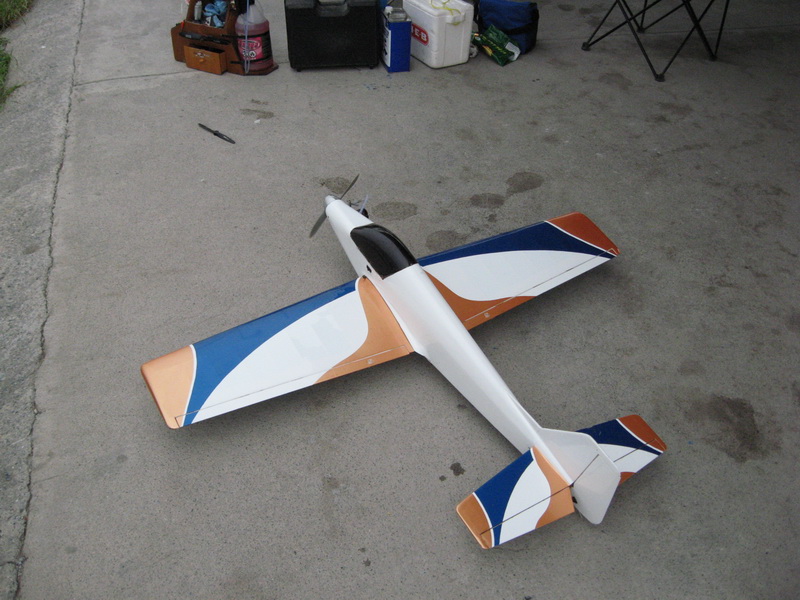

Personally I like to paint the canopys of my airplanes but I have used Comex brand (en aerosol ) I would not recommend to you use it as at first time , but , you can use a nice brand specially for this application "Pactra" and in your case probably this is what you are looking for http://www3.towerhobbies.com/cgi-bin...&I=LXCY44&P=ML "Window Tint Colored Paint" , these paints works really nice and easy to apply .
David thanks for the link junorc , I bet I would order one one of these days but first I need to finish another kit that I've started
Just to share with you a couple of pics with painted canopys
Hector
, paint the canopy .Personally I like to paint the canopys of my airplanes but I have used Comex brand (en aerosol ) I would not recommend to you use it as at first time , but , you can use a nice brand specially for this application "Pactra" and in your case probably this is what you are looking for http://www3.towerhobbies.com/cgi-bin...&I=LXCY44&P=ML "Window Tint Colored Paint" , these paints works really nice and easy to apply .
.Just to share with you a couple of pics with painted canopys
.Hector

Thanks for the compliments about the airplanes , there is a Great Planes Patriot .40 and yes with Rossi .53 and Ultra Sport 40 stock without mods and YS .45 both with tuned pipe
the Patriot is a real rocket , I like to modify the props reducing the airfoil in order to gain some speed , some folks don't believe on that fact but my tests and experience with it shows the oposite
if you want to see it on flying take a look here http://www.youtube.com/watch?v=KRIbC7_8U_0
And yes the canopy of my US is throughout ( polychrome black ) . About the color of the Pactra can cap hmm..... I'm not sure if it is the real color but I think not because the others caps looks the same color even when there is another color paint , check this http://www3.towerhobbies.com/cgi-bin...ctra&search=Go all the caps are in the same color IMO
I have understood they are fuel proof [sm=thumbup.gif] .

Well, I finally got some pictures taken of the trimmed out Tsunami. As you might appreciate it took some time to get the trim done given that I had to trace plans, make templates (13 to be exact) and cut covering along curved lines for every single piece [&:]! I'm not sure what I was thinking but something simpler might do me fine on the next project!
Some minor cosmetics remain to be finished as well as a few decals but those will go on once the gear is all installed.
The wing is essentially finished with the exception of the aileron pushrods and some wing skids. Of course I managed to build in a somewhat convoluted path for the servo wires inside the wing so when it came time to install the servos with their 6" extensions they wouldn't pass through and the connectors would just peek out of their exits but not actually exit! [:@] So after considerable thoughtless wrestling to get the extension junction through one of the ribs, lightning struck and I pulled everything out and swapped the extensions for 12" lengths - Eureka! Of course I also managed to snap my pull threads (dental floss) in the process so I had to resort to magic with the bath tub stopper chain
. I'm getting pretty good at it actually, this is the second wing I've had to do this with [:-]. I guess I won't be using floss again...
I'm now moving on to the engine installation, throttle pushrod routing as well as the tank, plumbing and battery installation. After that, I'll be able to move back, install the radio and link up the tail feathers. I'm off to pick up a 10 oz tank tomorrow at the LHS.
Hope you like the pics!
David.
P.S. Please disregard the hideous green floor. Someone who was color blind must have painted it previously.
