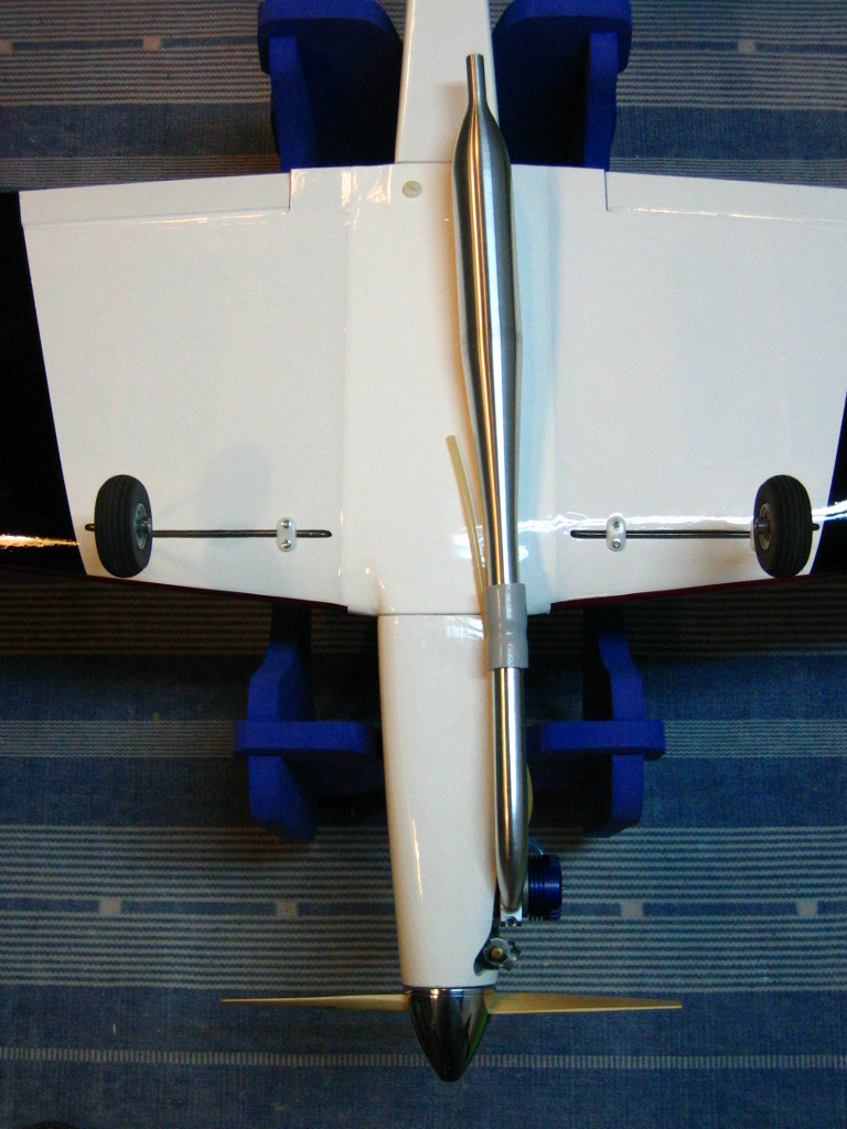

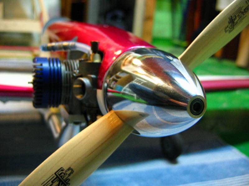

Hey Speedboy,
Thanks! It was a bit of a pain to do such a trim scheme with Monokote (paint would have been better and just smoother) but in the end I'm happy with it. Video... sure when we thaw out and I have a chance to maiden her I'll try and get some video. Meanwhile... build, build...[sm=50_50.gif]
I got the business end taken care of last night. Stuffed a DB 10 oz tank in the nose hoping my battery might also fit but that was wishful thinking. She's feeling a touch tail heavy at the moment but that's just speculation. The plans actually call for an 8 oz tank but if I decide to put the OS 46 in there, 8 oz will burn pretty fast. In any case, I was able to get foam all around the tank. But boy..., you gotta love hatches! The tank plumbing is akin to routing aileron servo wires without pull cords! Next time I might try the cylindrical tank approach with its plumbing connections centered in the circular motor mount opening on the FW - just easier in such a small space.
BTW, that's a Macs muffled 6.5cc TP (still not attached to the wing) on my ST S40. It's supposed to tach around 13.5K on a 10x6 w/ 10% nitro on its standard muffler! (See pics earlier in thread.) I'm hoping to get similar figures on an 11x5 with the TP - we'll see in the spring. I haven't run this engine in over 20 years but it's basically just broken in.
to be continued...

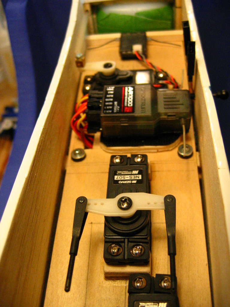

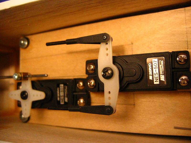

Next, moving down the fuse, the radio installation and then the tail feather linkages.
My only concern with the radio installation is that once the radio tray hardwood rails are glued in (the forward one at least), removing the tank becomes virtually impossible. I'm considering using fuse side mounted rails for the front hoping this might help. But...the fuel tank is exactly the same width as the opening in the F2 former which is only 1/8" narrower on either side than the fuse! That's not a lot of meat to get two screws into!
Mmmm... perhaps I should have made that radio tray smaller with the throttle servo in the back...
Hey Frank, did you have any problems with your throttle servo and access to the tank? Did you use an 8 or a 10 oz?
Cheers, David.
Cheers, David.

Hey Frank,
Thanks for the sketch. Yea, I kind of envisioned your radio install when you told me it was close to the plans.
So, do you rotate your tank to get it on its side when pulling it out in order to pass the throttle servo rails? In the absence of those, there's plenty of space to pull the tank back. My issue is that I have a servo tray which I thought would make life easy for me - two rails and I'm done. But I didn't think about the tank.
I'll see if I can jerry rig side mounted rails for the front part of the tray. Actually I just had an idea. [sm=50_50.gif]
I don't really need screws in the front if I make two thin (1/8 inch) rails on each side into which the tray slides in from the back. This will hold the tray from vertical movement. In the back, the tray is anchored with a standard rail and two screws... I think I'll try that!
I might need another brace across the fuse as far forward as possible to give it some rigidity. There are no formers here and it tends to flex!
David.

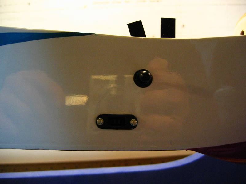

#85
Jason,
thanks for your post and nice comments. I can't wait to maiden her and yet the snow is just starting to dust about... I hope you start a thread on your Curare 20! I'd enjoy following it.
Frank, amazing the tank fits beside the throttle rails but I'll take your word for it.
Moving back on the bullet, I got the radio installed the other day. In the end the tank wasn't such an issue with my radio tray. I built two bridges which serve as rails for the mid and aft section of the tray. This holds the rudder/elevator servo's firmly. The front part of the tray has some up/down play (although it is snug) which doesn't affect the throttle setting. I decided not to install the fuse side slots in the front as it was going to be complicated to slide the tray in since it would have to move too far aft for insertion. For the time being I simply have a piece of hardwood inserted under pressure tightly holding the front part down on to the battery which sits underneath the tray behind the tank. I'm not sure whether I'll take it out or fix it somehow in a way that allows me to remove gear if necessary. I don't think its actually necessary.
In any case, here are some pics of the install...

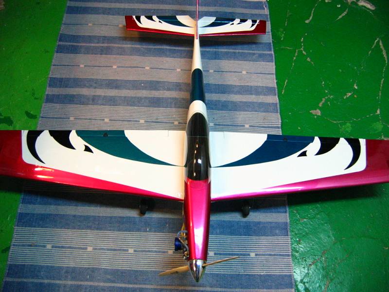

#86
Looking for a psicodelic tsunami ? here ya go !!!
looking good so far David, sure it 'll fly ffffffffaaaaasssssssssssssttttttttttt.
Wheather must be frezzing up there by now and some snow must have show up, i 've lived in Montreal in 1981 cold wheather kicked my but out of there by next winter time, NO WAY JOSÈ I would stand another season like those ones,last day I spend in Montreal temp was - 38 C below zero [:@] ouch just to remember that makes me nuts.
Anyway back to your plane, I hope to see the maiden soon !!

Oh, I almost forgot!
Dry, with pipe, and the missing linkages and other little items, she's tipping the scales at almost exactly 5 lbs!
D.
P.S. What am I doing up!? Woke up at 2 am and couldn't sleep so I thought I'd take a few pics. Got to tuck myself back in...

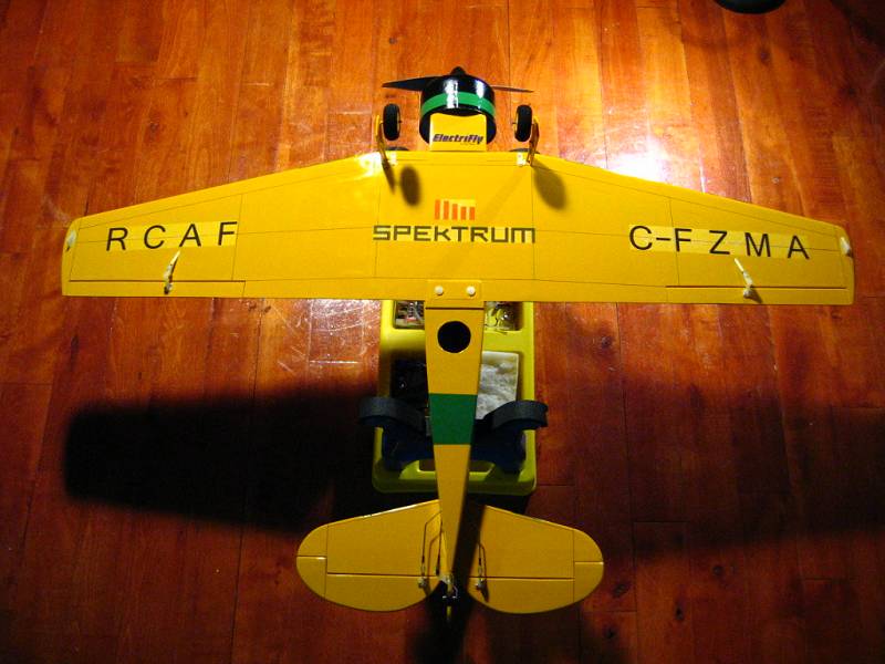

After sticking to classic looks as shown below, I decided to go wild! (I hope posting pics of another model doesn't break any cardinal rules [X(])
...80's, yup! That would have been when 15 feet of snow weren't unusal and -40C was normal by the end of January. Nowadays, its practically the tropics up here... I've still got flowers outside that refuse to die or close shop 'til the spring!!
On the other hand, the Mexican Caribbean does sounds pretty good right now... [8D]. Maybe it's time to pay my dad a visit.
Oh, that would be an electrified 25 size (44 inch) HOB T-6 Harvard (Canadian trimmings) loosely representing the efforts of the Canadian Harvard Aircraft Association - Dive Recovery Team (CHAA-DRT). I used to be an avid diver during my days down in tierras mas calidas.

that third and seventh pic in post 85 shows the rear of a DB 10 oz tank installed. Also, a 46 is a somewhat tight squeeze in the nose. My OS 46 FX fits but the YS 45 FR requires more space. I'm not sure how much larger the 55 AX is over the 46 FX. However, it's good that the 55 AX has a carb mounted needle.
