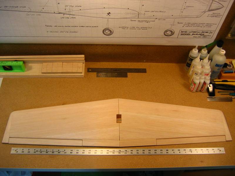

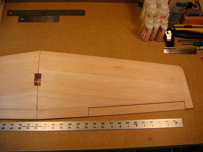

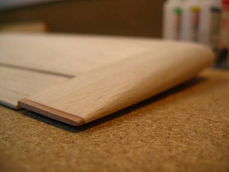

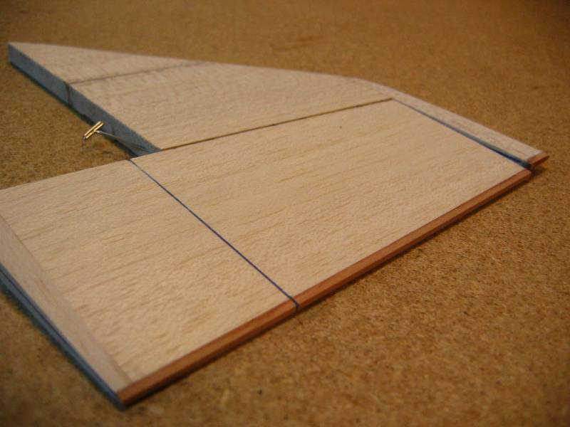

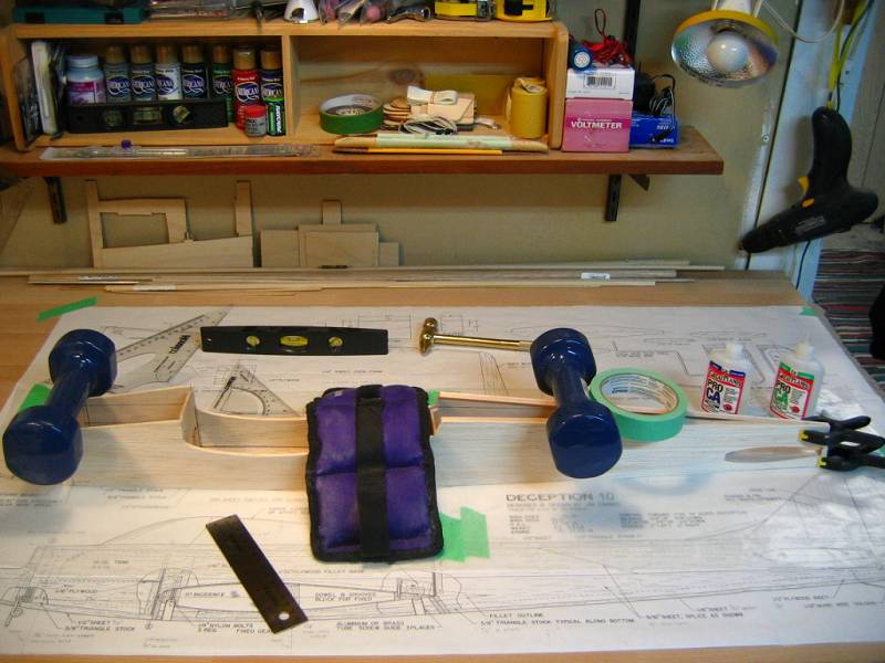

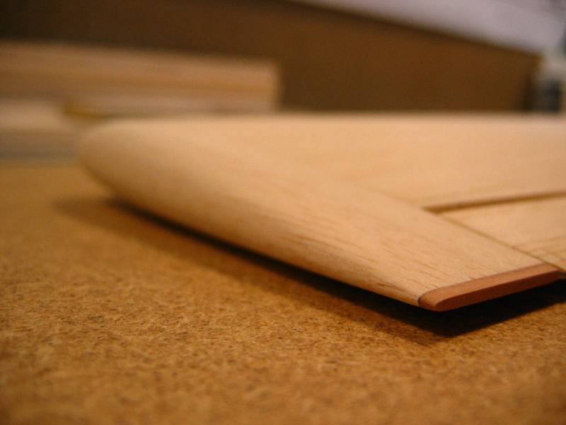

In other excellent news... the wing is done!
Well, a little assembly and some minor cosmetic touch ups and she'll be finished until she's due to grow a belly. Mmm... maybe those smooth round tips have some effect on, eh... pregnancy!?
What do you think Pete? Sorry guys - I'll stay focused.

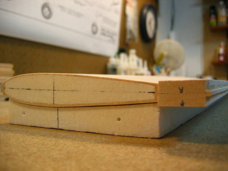

I won't go through the control surface routine again as I pretty much did that exhaustively with the stab. Suffice it to say, that I laminated two 1" x 20" sheets of 1/4" balsa and attached basswood on the trailing edge at the center line. Then shaped to contour. Instead of using basswood, which is nice and firm but will dent if hit hard enough, I used mahogany on the wing tip TE's as well as on the rudder and fin post TE. A little heavier but bulletproof. Actually sandpaper doesn't seem to do anything to it. The paper just wears down and the wood remains the same [8D]
The approach to building the control surfaces is labour and time intensive (compared to simply sanding a sheet of the right thickness to contour) but is worth the effort. The surfaces are extremely hard and warp free. Each aileron came in weighing 10g (0.3 oz)! I guess that's the weight of an HS-55. I may just go this route from now on on all builds.

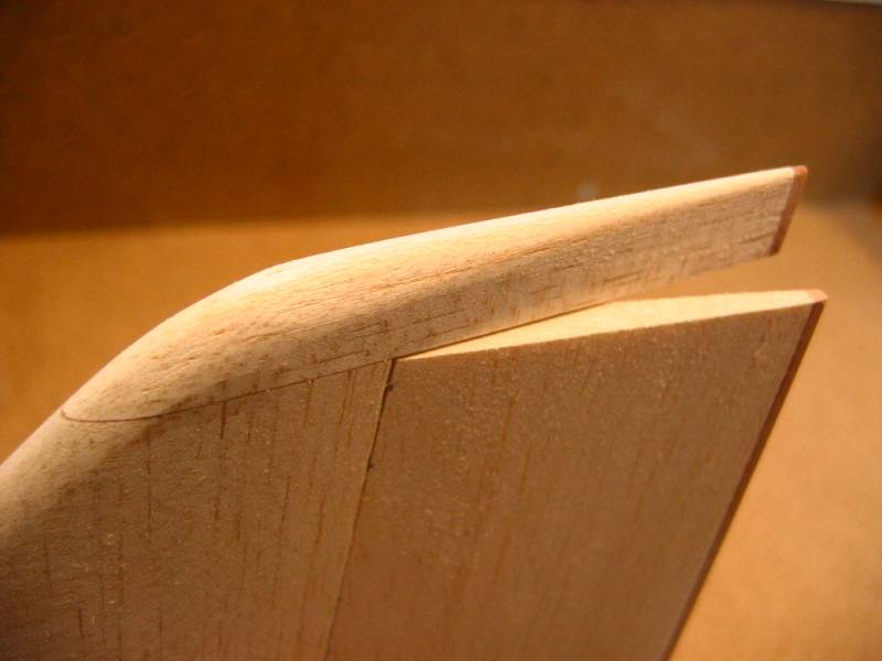

I also got some work done on the fin and rudder. The rudder and fin post are sanded to shape. The fin still needs more work but it'll wait until the fuse is complete as a dorsal fin needs to be added and shaped as well.
And now, for some pics...
David.
What do you think Pete? Sorry guys - I'll stay focused.I won't go through the control surface routine again as I pretty much did that exhaustively with the stab. Suffice it to say, that I laminated two 1" x 20" sheets of 1/4" balsa and attached basswood on the trailing edge at the center line. Then shaped to contour. Instead of using basswood, which is nice and firm but will dent if hit hard enough, I used mahogany on the wing tip TE's as well as on the rudder and fin post TE. A little heavier but bulletproof. Actually sandpaper doesn't seem to do anything to it. The paper just wears down and the wood remains the same [8D]
David.

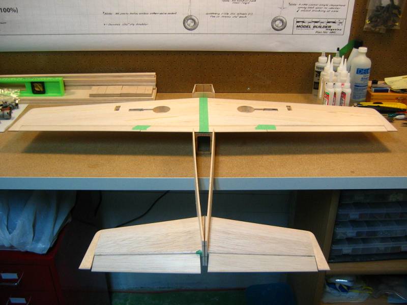

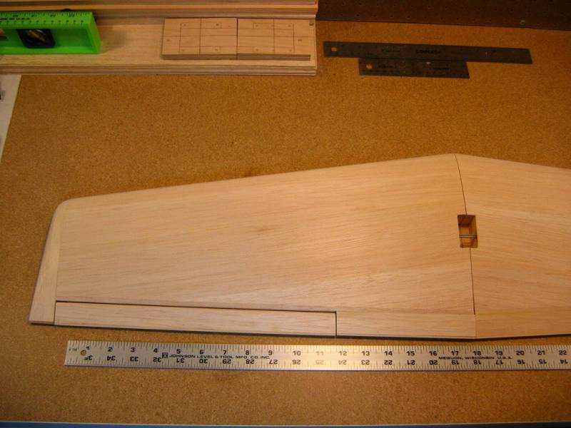

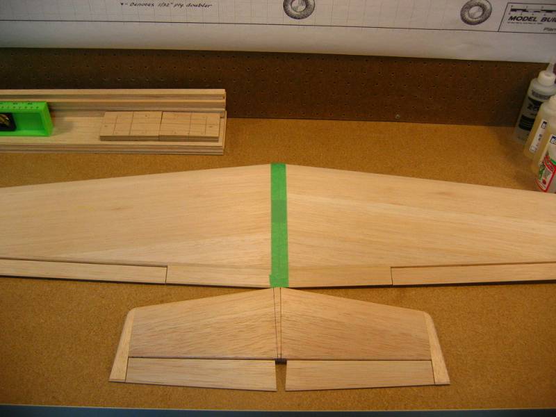

And a few more.
Couldn't resist... she just looked like she wanted to take off from the workbench!
BTW, an update on weight.
Complete wing AUW with hinges, gear rods and tape (prior to joining and glassing) = 8.10 oz...
Oh... she'll come down some more before she goes up! I want a glassed wing AUW of 8 oz. Its decided.
David.

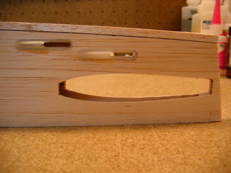

Time for some fuse action!
David.
P.S. I'm putting together a little list of materials and parts to complete the D10. It should come in handy if someone wants to build one. I'll post it when it's a little more complete.

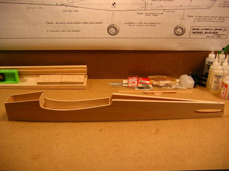

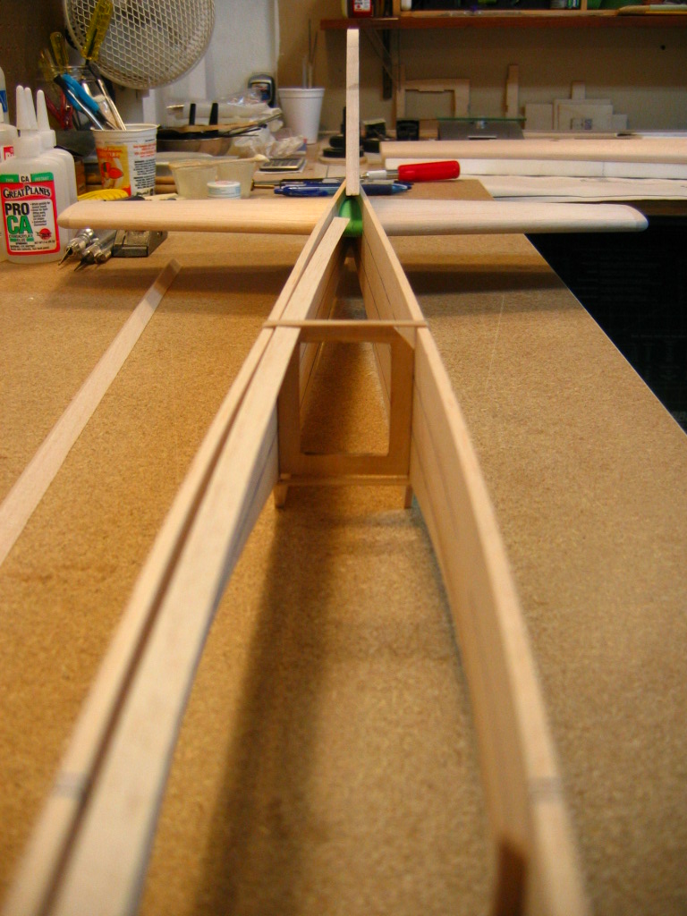

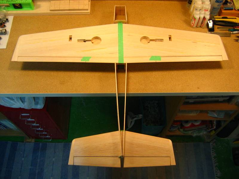

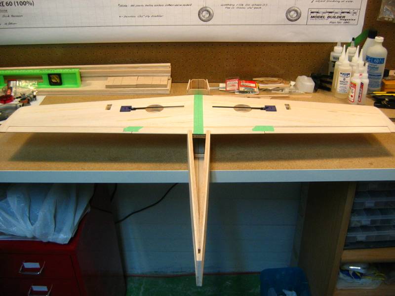

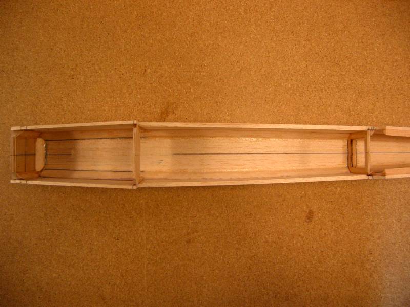

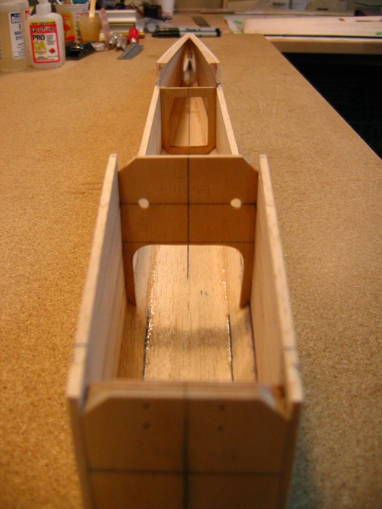

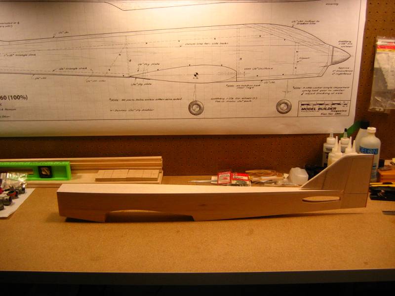

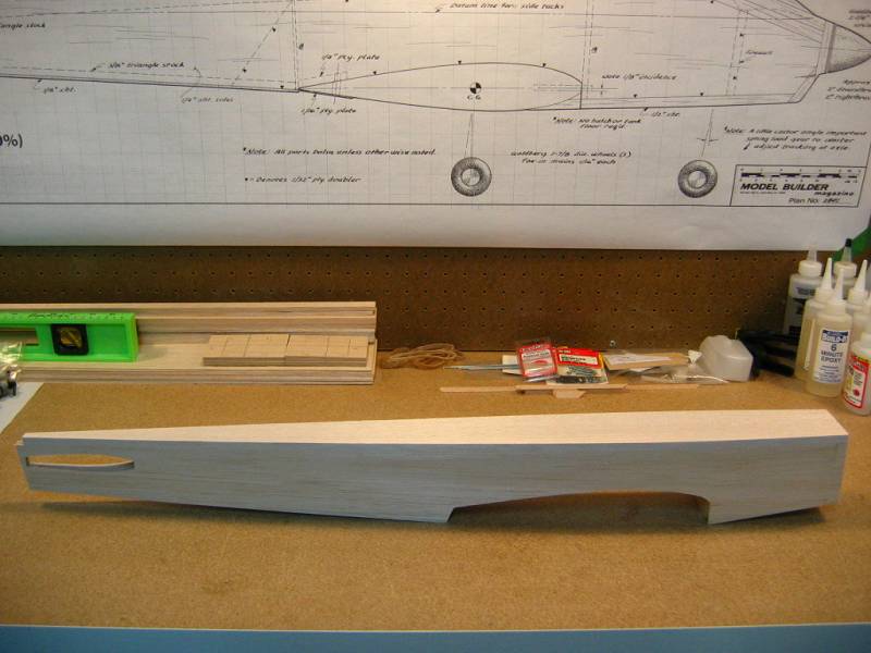

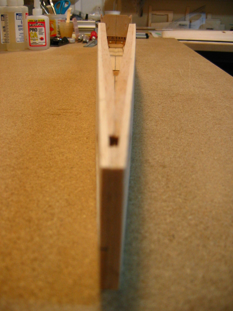

Unable to wait any longer, I went ahead and framed up the fuse.
However, before doing so, I made a couple of modifications:
In order to guarantee proper nose gear length and adequate prop clearance (maybe even a 9" prop), I extended the fuse nose by 10 mm as described in the above linked post. This will provide a nose gear bay with a pivot to wheel base length of 4-1/8" which will leave the model level using 3-3/4" lengths on the mains. 1-3/4" wheels will be used on the mains and 1-1/2" on the nose.
I also decided to add 1/32" balsa doublers to the fuse wing saddle area which extend to the edge of the 1/2" triangle stock at the top. While 1/32" balsa is almost paper thin, the balsa/CA/balsa laminate produced a much stiffer center section. This might also optionally provide strength to remove material for lightening purposes. I decided to postpone all lightening (if any) until after the model is ready for covering.
Without nose and tail bottom blocks, nose fairing section and canopy, the fuse is now at an even 4 oz - unsanded
So far so good. I'm now fairly confident that I'll be able to have a finished uncovered airframe weight of ~18 oz (wing 8 oz/fuse and empennage 10 oz).
The misalignment of the fuse wrt the plans is of course due to the 18.5% wider fuse from F1 to F3.
Enjoy the pics!
David.

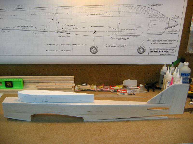

#117

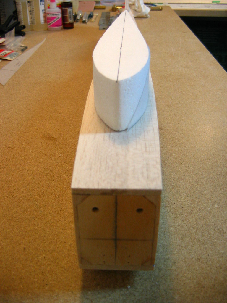

And a couple more...

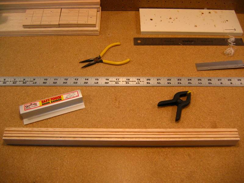

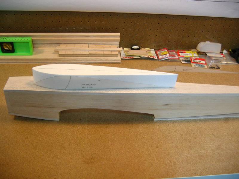

I've began work on the canopy as well which will be shaped from a foam block 14" L x 2" W x 1-3/4" H. Treated as a wing tip in the shaping process, once airfoiled, I will glass it with 2-3 layers of 3/4 oz. glass cloth. Then, depending on weight and strength, I'll either add some more cloth and hollow the foam out or leave it as is and paint it.
More to come next week as I won't be able to build for the remainder of this week... [
Mitch, looking forward to seeing the progress on yours!
David.
P.S. Any thoughts regarding the longer nose moment alteration would be much appreciated.

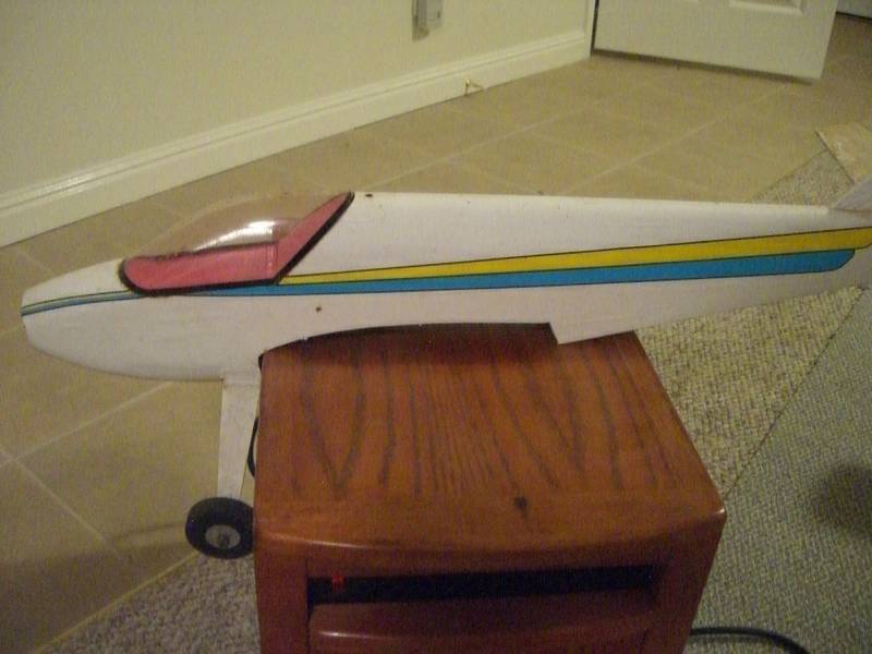

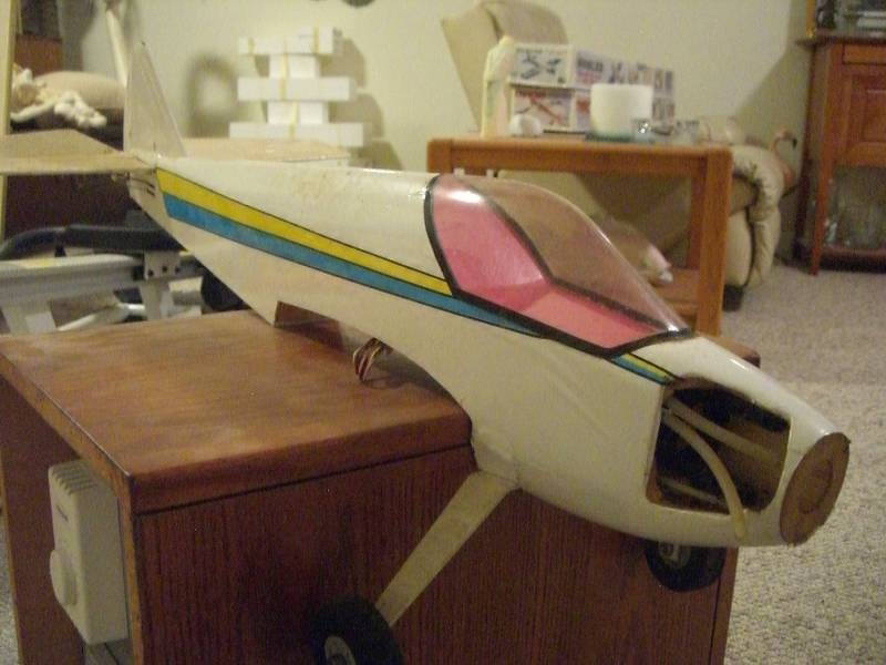

David, that is really looking great! I just found a plane that I know I've had for a least 18 years I stuffed away and forgot about. It was a kit made by I believe GM precision. it has a 52 inch wing span and is 37 inchs long made for a 25 to 35 size engine. put it in the attic some 15 years ago after one of my flying buddys walked in (had it on the floor) and stepped on the wing, it flew great, will bring this back to life one day.
The color's are from my daughter when she was 8 years old, so don't laugh at me not my idea. I caught all kind of flack back then over the colors. What is this bird? you ask................................. RAINBOW RUNNER, no really they made a 20 and 40 size of the rainbow runner. its was a trike, but the field I flew out was so ruff I modified it to a tail dragger.
Regards, Pete
Regards, Pete

Pete,
thanks for your kind words. I'm anxious to get her finished up although I haven't had as much time to spend on her lately.
Your Rainbow Runner looks like a nice plane to fly with your daughter! A little touch up to the wing and a finish refresher and she'll be as good as new. Keep the trim just as is - with new film the colors will be nice and punchy!
David.
P.S. BTW, nice cores in the background!
What model are the third set for?

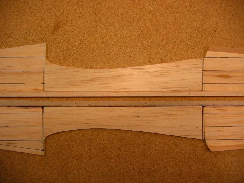

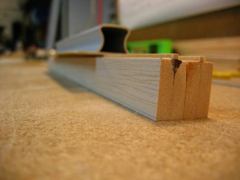

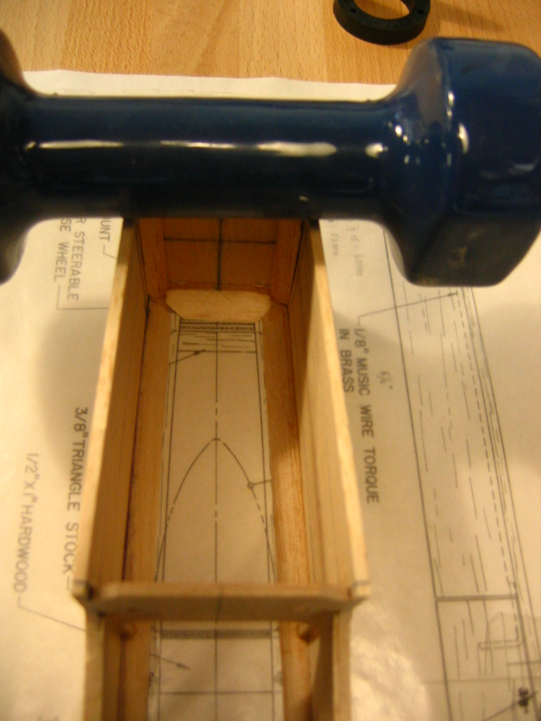

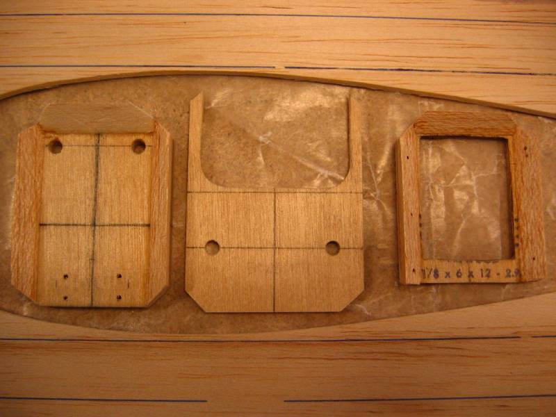

With a minor update, I managed to work on the fuse a little last night. The tank plate is in place and the entire area, above and below the plate, was fuel proofed with a 50/50 mix of laminating epoxy and alcohol. This stuff brushes on thin and nice and easy. I'll take some pictures of that when I'm done shaping the bottom nose retract block.
I also decided to add some 3/4 oz glass cloth to the FW/fuse side tank area for strength. Further, two ~1" holes were drilled out in the tank plate to reduce weight and facilitate access to the tank area for plumbing purposes. As a side benefit, the holes allow the plate to be mounted lower in the fuse providing more space for tank padding. The reason for this is due to the rear hole providing additional clearance for the nose wheel to retract higher in the fuse than it would were the plate solid (which would require a higher mount for the tank plate and less room for foam padding - things are tight in there).
I also began shaping the fuse front top and bottom blocks (not evident from the pictures) as well as the canopy. Pushrod cutouts in the rear are also done.
David.

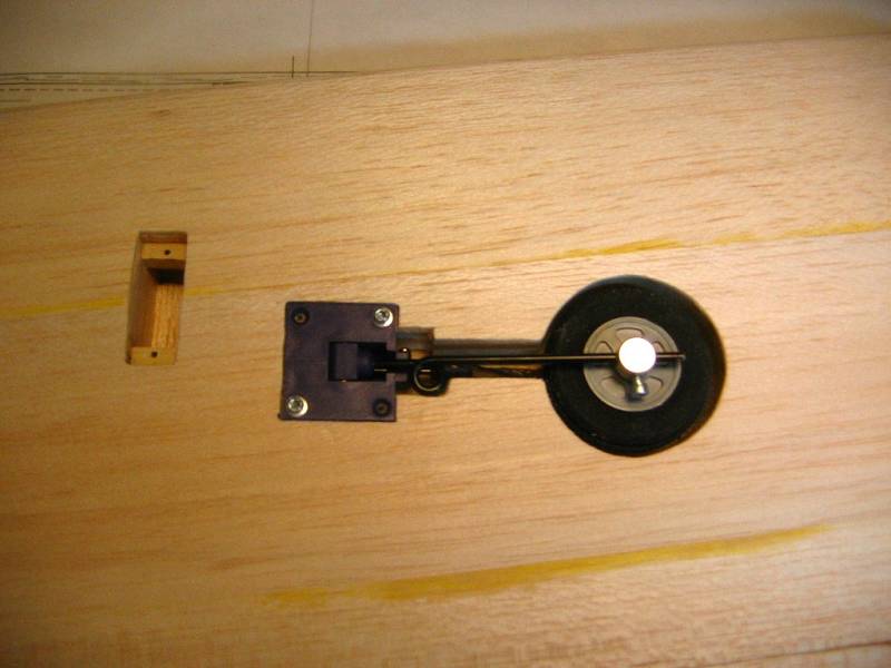

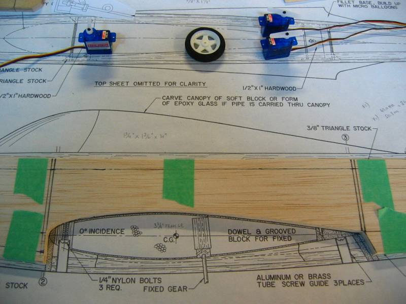

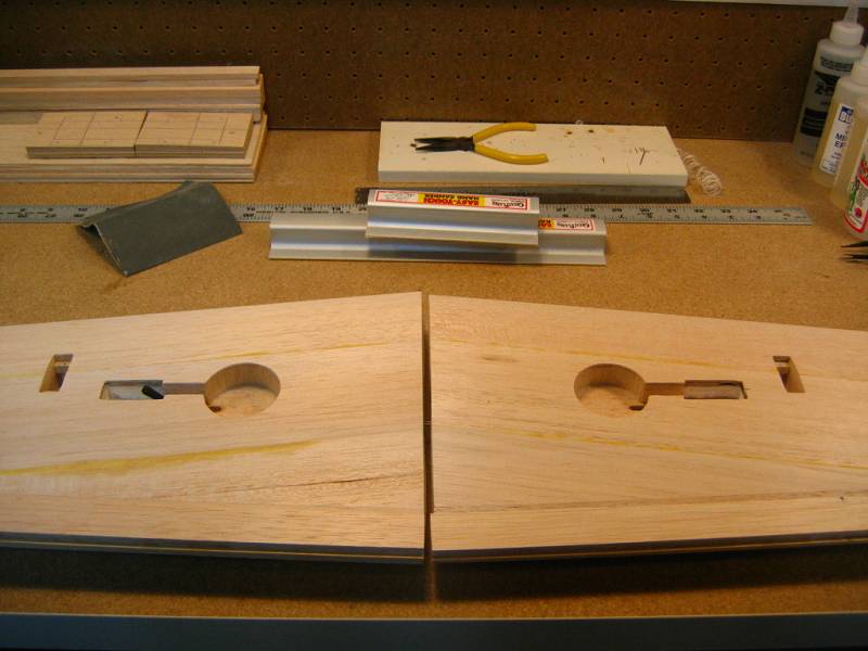

I also managed to pick up some 1/8" adjustable axles so the wing finally sprouted some legs!
Final adjustments to the struts are still needed. I will epoxy on some 1/8" OD aluminium or brass tubing in the area where the axles attach to provide a snug fit for the axle/strut junction. Then, a small hole will be drilled out in the tubing where the axle is secured by the retaining screw.
As soon as I get the retract servo linkage sorted out, I should be able to join and glass wings and stabs in preparation for mounting to the fuse.
David.
David.
